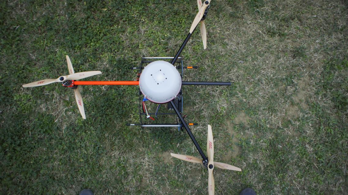

Ok, here are the pictures first:
View attachment 1151View attachment 1152View attachment 1153View attachment 1154View attachment 1155
I had a problem with seeing the front of the craft with flat Hexa. Now, it's easier. Additionally, I added a small boom to the front, so it will be much easier to recognize the nose when flying high. (That extra empty CFK boom doesn't exist in the design actually :) )
The total weight of the copter is 3.2 kg, including 4s, 5000 mAh Lipo and MD2 camera mount. I haven't attached any camera yet.
I used 13x6 JXF wood props. I want to decrese the pitch, increase the diameter. So I'll try 14x4.7 APC SF and JXF 14x4 wood props. With current prop, I have additional 2.2 kg payload capacity. When I change the props with 14x4, I'll have the same payload capacity but I hope it'll ascend and descend smoother.
My frame consist of G10 center plate (2mm thickness), Delrin motor mounting clips, and aluminium 40cm booms. I'm using DWX landing gear right now but soon I'll be changing it with mines. The build itself is very stiff.
About Tiger MT2826 motors: They run very smooth. They have 5mm shaft, 550KV and can easily rotate 14-15" props. It still stays cool. I haven't yet setup a bench to test the motors but it looks like I'll be happy with it.

Looks good.. I will be interested in your settings..Mine is solid as a rock in no wind but in justsy wind I am sure I can get it better..
As for orientation get some leds on it!
