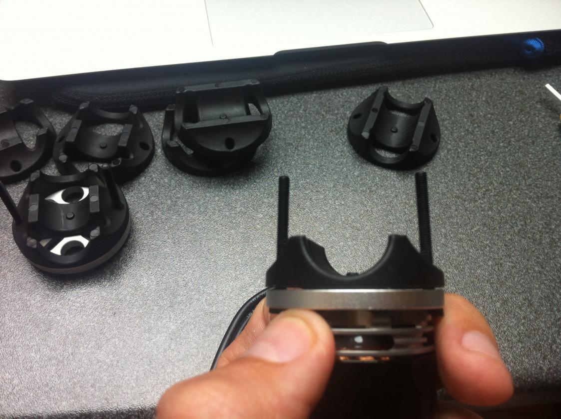

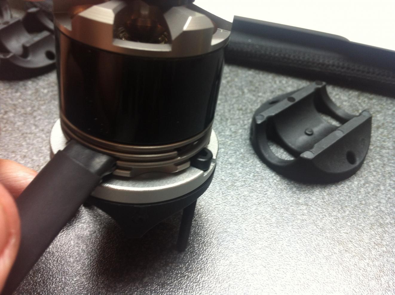

I am building this config right now.
The MT2814/10 motors are a very very tight fit on the engine mount disk. In fact it does not fit, I have to squeeze the motor in place. This causes my 30mm head cap screw to bend a little bit, thus making it very hard to put the engine mount brackets in place. I finished one bracket but have no idea how I can ever remove it again.
Has anyone encountered the same thing? Any suggestions on this issue?
A photo is more clearer, you can see that I can't acces the hex screw on top. The other photo shows how bend the screws are.

nicwilke
Kolb,
Same with my XM6. Go to the hardware store, and get replacement M3 screw heads, they are lower profile. Mine would not fit. Replacement cost a few dollars.
Kolb
I'll just continue asking questions here. Could also be informative for the next guy.
I got me some replacement m3 with a conical head. Will try tomorrow, should be fine this way.
