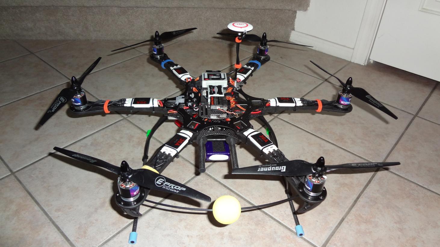

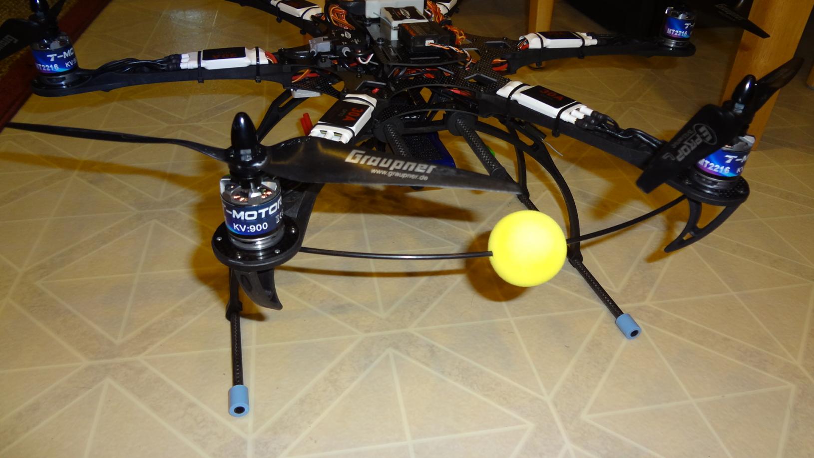

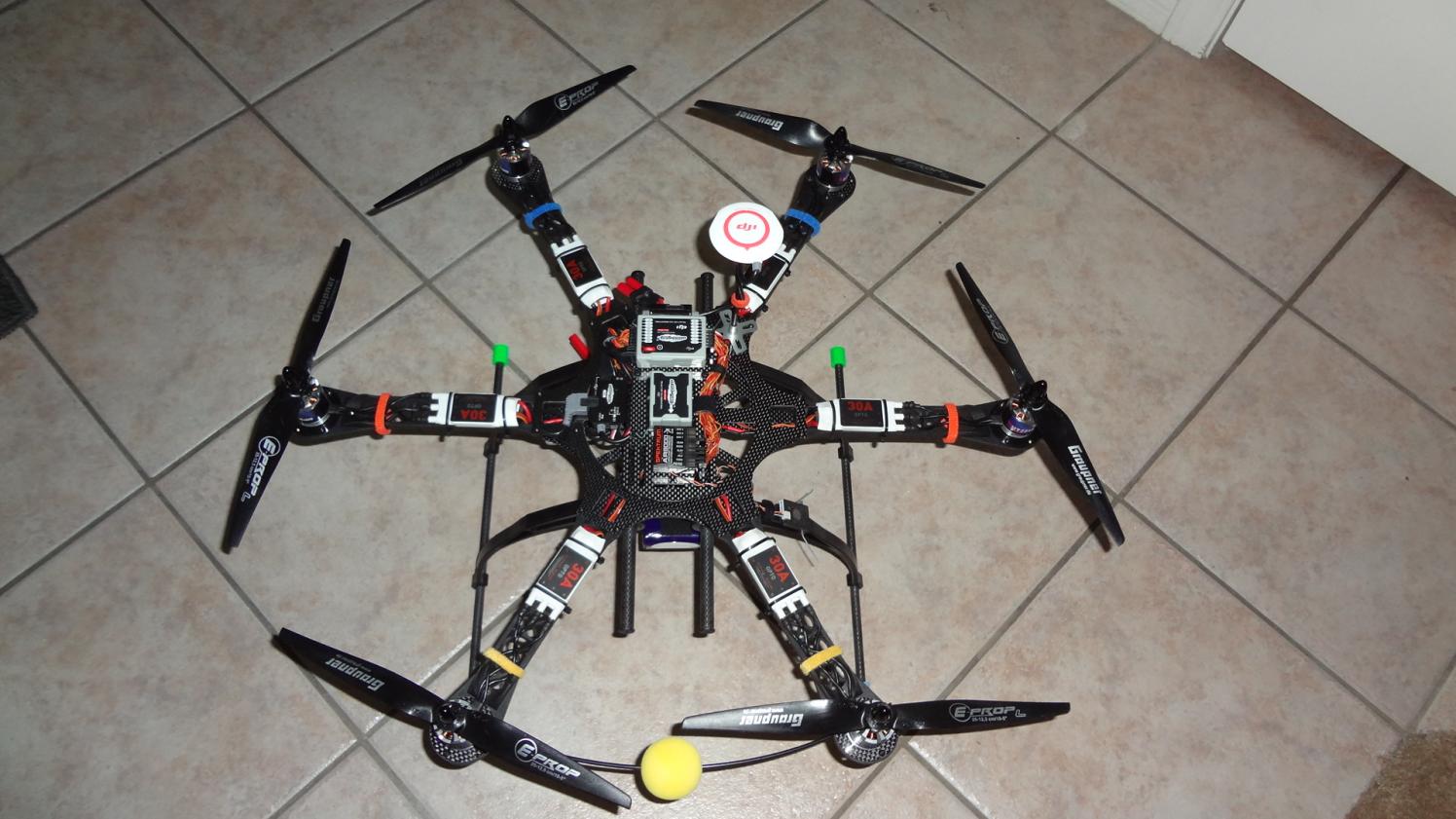

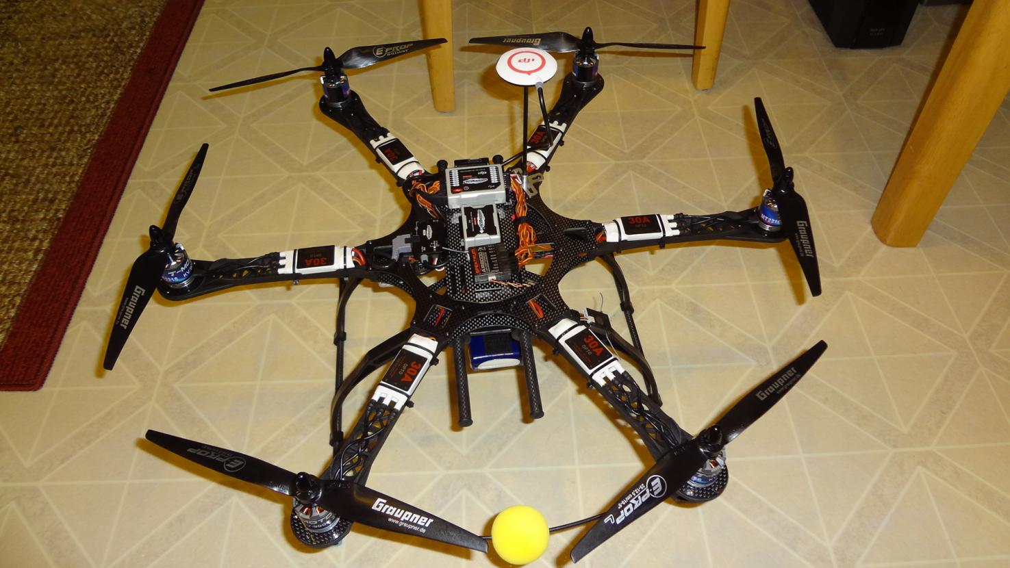

I Finished this Small Hexa Build (535mm) With DJI-Wookong-M FC last week.
Specs of Build:
Hexa Frame: XA DIY Hexa 535mm
ESC'S: DJI 30amp
Props: Graupner 9 x 5 E-Prop
Motors: T-Motor MT2216-10 900KV 210 watts
Flight Controller: DJI Wookong-M
Radio: DX8 with AR8000 RX
LiPo: 3S 6000mah
Remarks:
I am very happy with the Stability of this Set-up
ESC's and Motors run Cold.
Super Smooth Flight in a Compact Package.
Next: XA Camera Mount and GoPro for nice AP Applications.
All parts in this build are from RcHobbyHelicopter.com
Custom Built by John Wood
AddictiveRC/RcHobbyHelicopter N. American Distributor For DJI-Innovations Products
Your One-Stop Shop for Multi-Rotors Parts and Custom Builds

rwilabee
The props look like they say 10 x 5 not 9 x 5. What motors are you running.

Yes I switched Props now.
More Stable with the 9 x 5 Graupners.
I added the Motors in the Description now.
Sorry about that.
