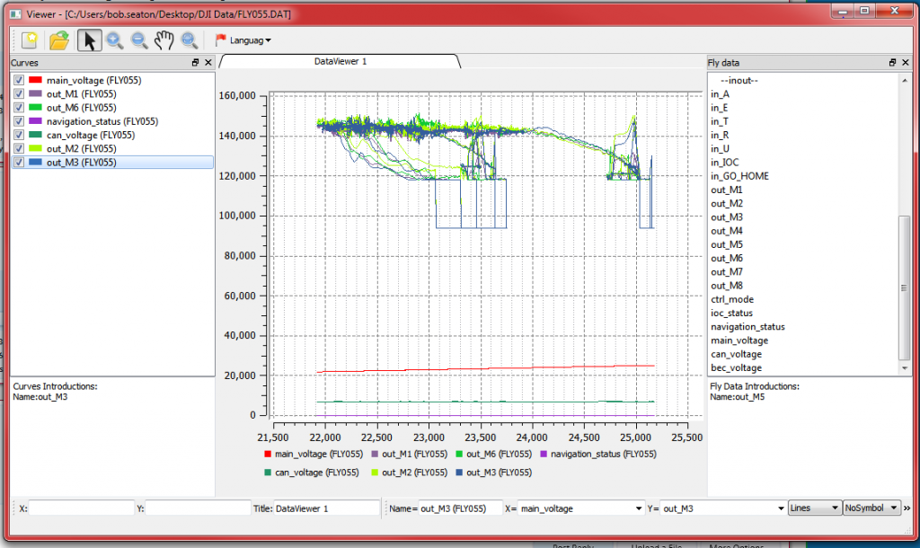

I found a way to view the IOSD logs. Currently the default x axis is "Time" but some how the IOSD is only reporting time from -.6 seconds to +.6 seconds! The work around is to change the X axis from "Time" to "Main_Voltage" for every data point you want to examine...
The main voltage drops as you use it. So the voltage drop can be interpreted to be time. Here is a snippet of a graph of my last flight. I changed the x axis to Main voltage and bingo the graph expands to the flight time...
