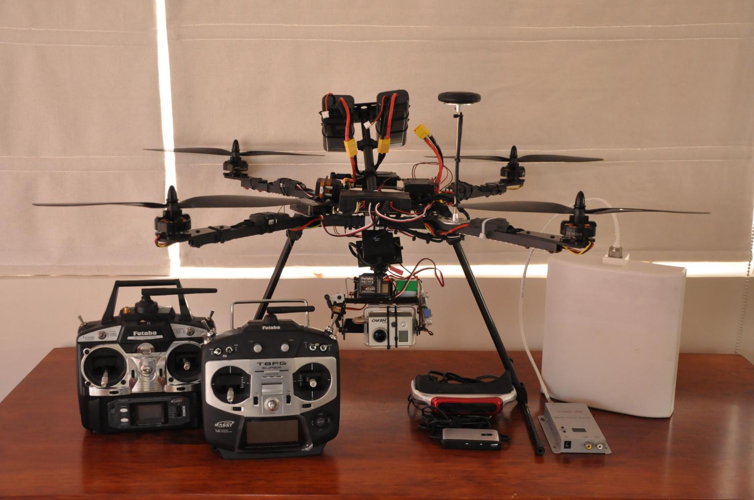

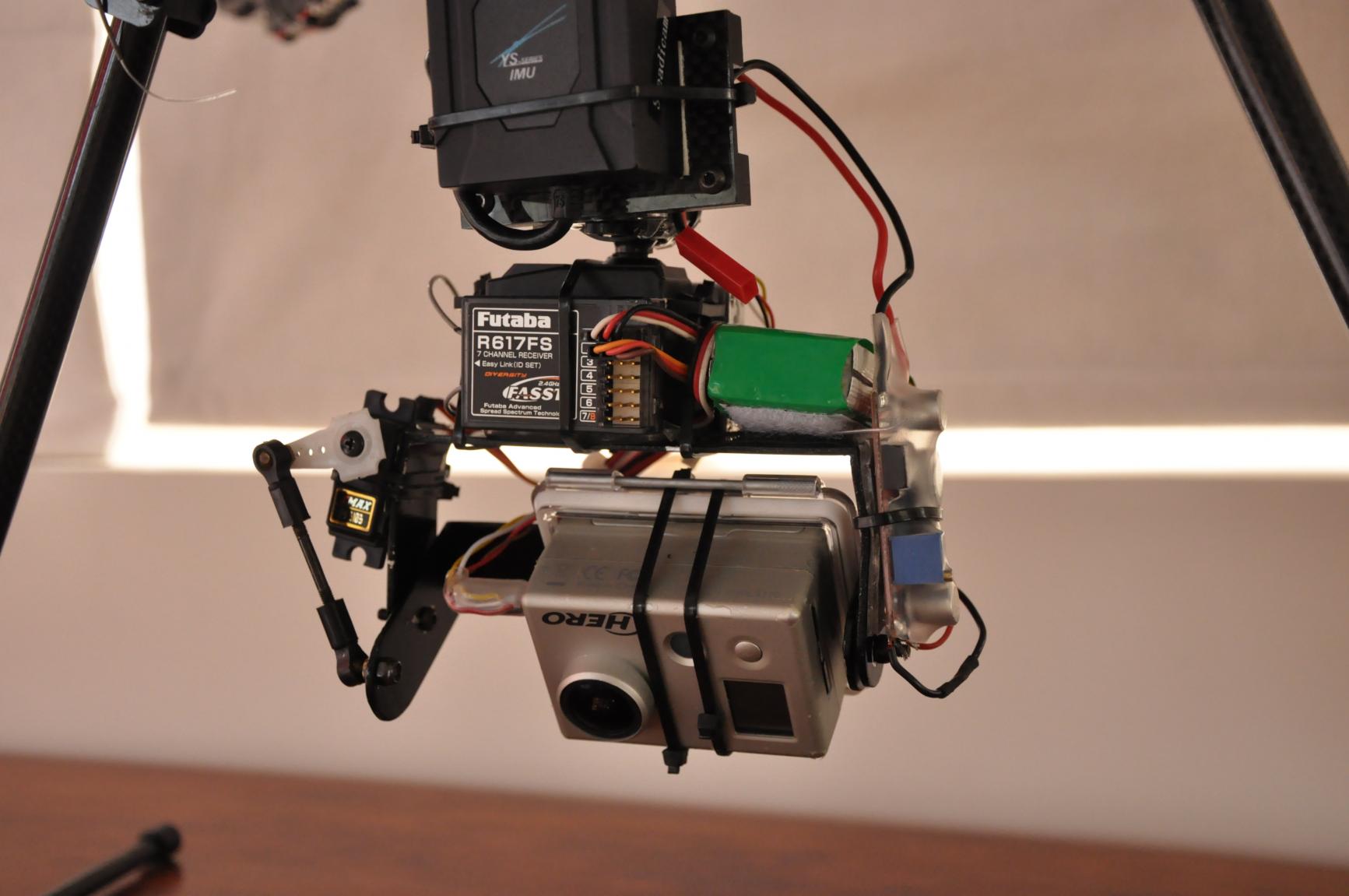

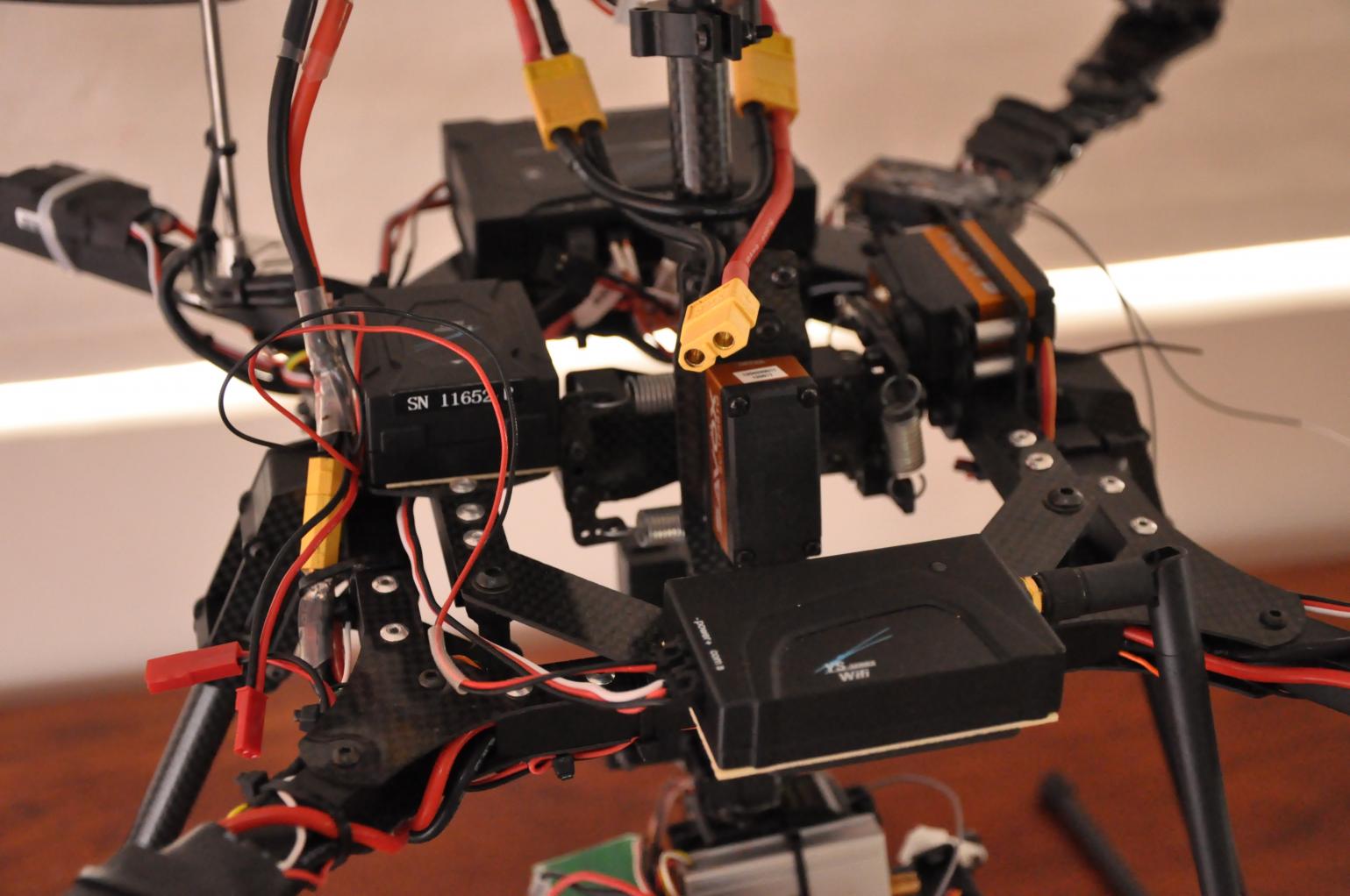

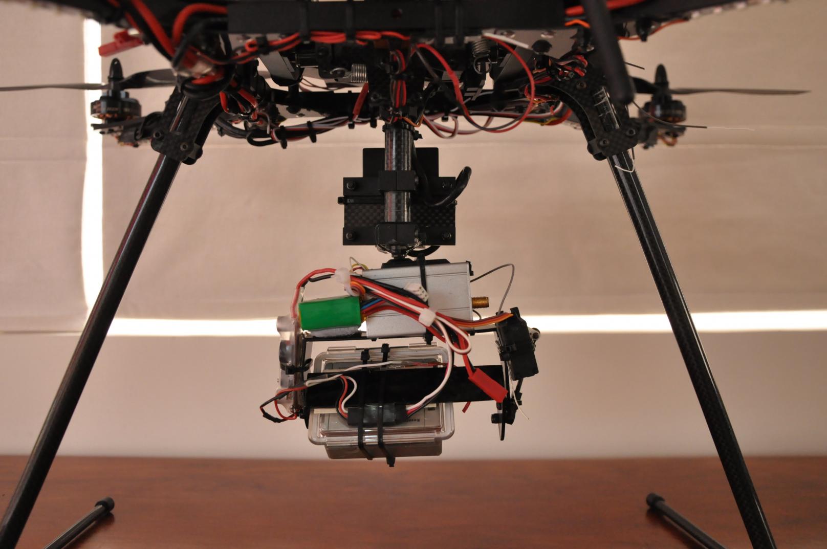

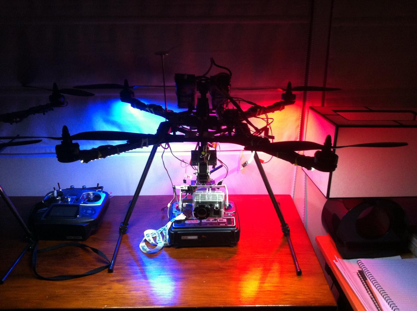

Setup is a hexa DJI 550. All setup as per manual, imu facing correct way etc etc. Compass was calibrated at setup and also again when out on the field and experiencing the problems. White light indicated calibration was ok.
Here is a pic of the setup, as you will see its stock, with gps unit mounted 6cm forwards from center. Ignore the fact the camera faces rearward, this is intentional

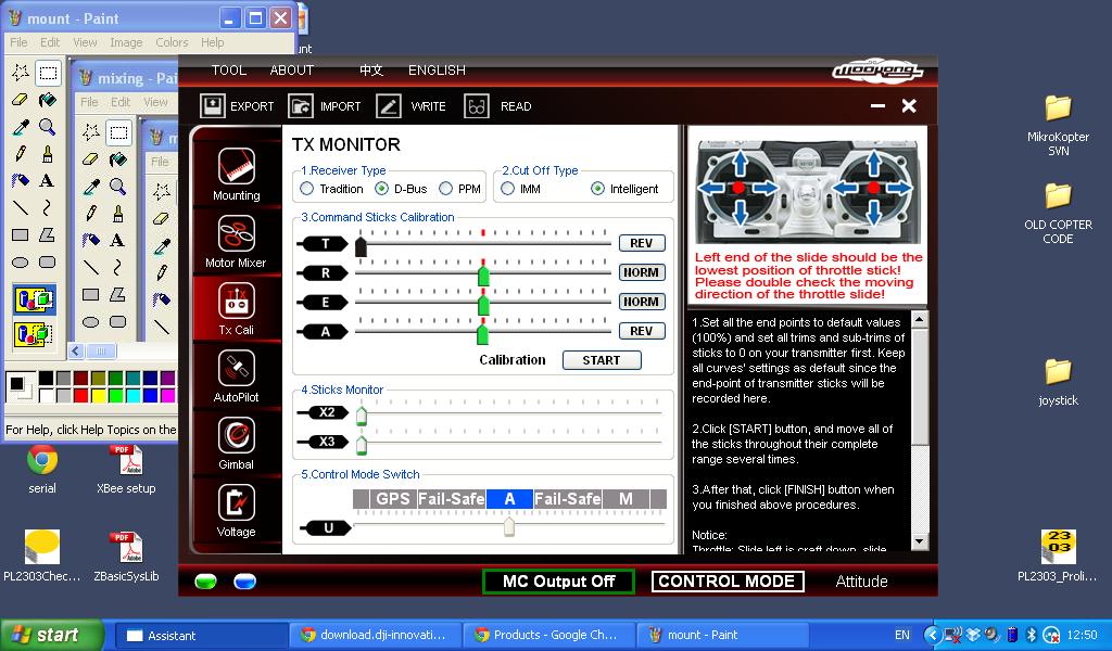

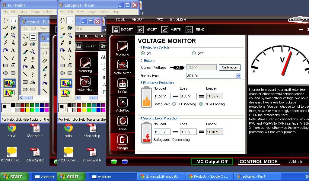

and here are all the screens from assistant
View attachment 9218View attachment 9219View attachment 9220View attachment 9221View attachment 9222

wait were it the front and the back on your craft ? the FPV cam is forward or the read arms ?

okay lets go through a list.
1. your setup is clean and all the variables in the assistant are right, gains both attitude and basic are to high for my taste but too high gains would cause oscillation also during hover and not only when you ascend.
2. it doesnt sound at all like there is a mechanical problem, like a prop slipping or a bad soldering causing a motor to stutter.
3. The behavior is also there during autonomous flight to i don't think there is any with you RX TX setup, an i right that it also behaves like this without any stick input ?
4. If thats the case i could only pinpoint it towards one the components. Either ESCs or IMU, or one of the other components messing with the can-bus data flow.
To rule some things out, did you try flying manual mode ? and giving it a throttle push ? does it behave similar ?
BorisS
I would also try to reflash the WKM and default all the values and enter all the settings once more !

hmmm reflash and also turn off the voltage protection that has caused issues for some in the past for some reason, mainly due to a faulty PMU.
