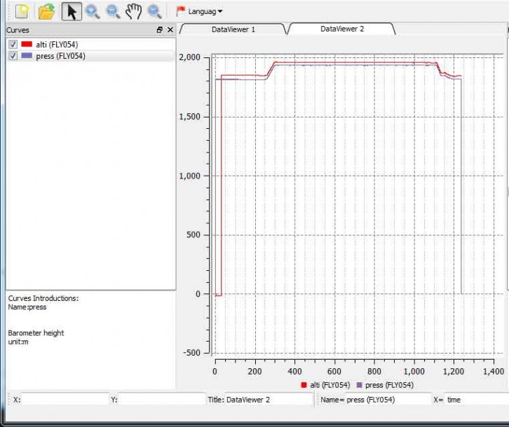

After unsuccessful tries to engage the function Go-home and Landing either from TX either from GS (go-home only from TX switch, it works),
I found perhaps the problem. As you see at the attachment the printscreen from Data viewer, the Press altitude is negative and the GPS altitude is correct. The question is, how can i fix it? It is a hardware problem or, it needs something like calibration?

I have experienced this difference between barometer and GPS specially in places near the see level and with some degree of humidity. When I fly near the see level I get from 100 m to 150 m altitude difference between GPS and Barometer, but When I fly places about 1300m ASL then both barometer and the GPS show same height. I have not found the cause of this yet but I don't think it is the matter of calibration or hardware problem.

OK, the problem with Go - home and landing solved. I set up the first and second level protection voltage and the function is enable. The only problem now is the barometer. It still have wrong inputs.
