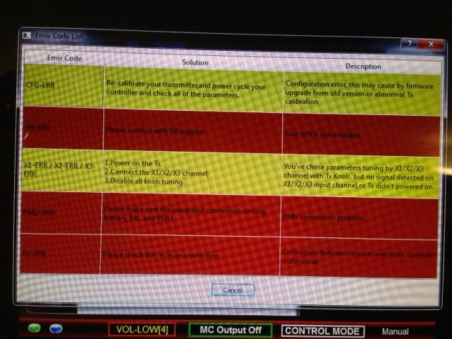

Now that I have my assistant up , this is the error is get.
the error code is not listed.
has anyone seen this?
thanks
DIPswitch
My assistant was showing voltage off.
Then the assistant stopped working. (according to windows)
I re-installed assistant.
I then showed voltage on.
Turned off voltage.
the thing flys now...
