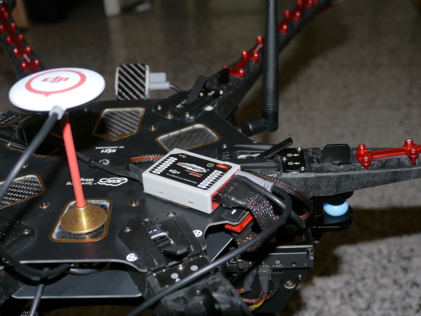

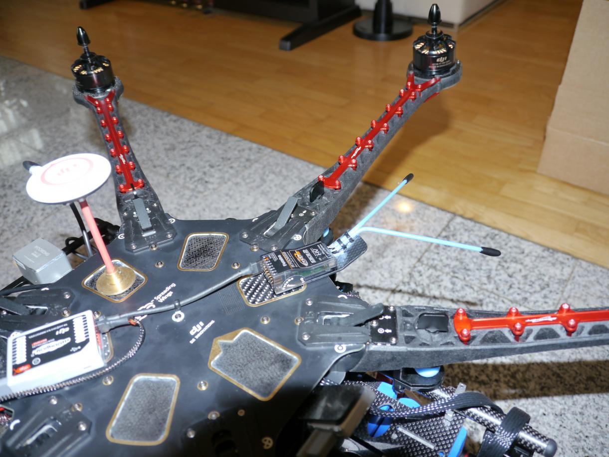

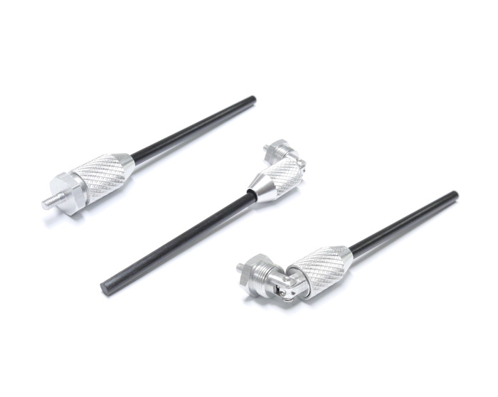

One option is this: http://www.kopterworx.com/DJI-Hobby/GPS-foldable-ant-for-NAZA-WKM?keyword=gps
You can fold it down for transport, and by "un-screwing" it you can easily adjust rotation.....just be careful not to "punch" the power lanes of the top frame plate, 'cause you have to drill a small hole on the top-plate to mount it.
To drill a hole in the standard collar won't work - ask how I know - it's crap aluminium and simply too weak to hold the grub screw. I got a much "beefier" one made from brass, and that works perfectly now. Just make sure to mount it in a way that the screw is always easlily accessible.
View attachment 12950 View attachment 12951
Chris
