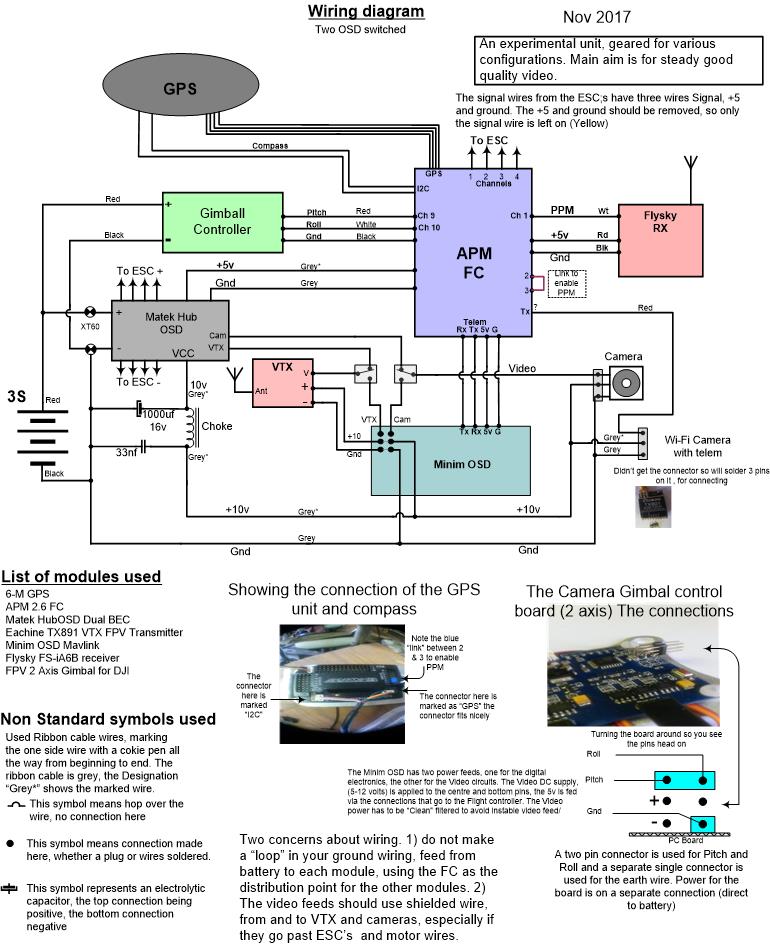

I dont know if this will help anybody, but here is all information added to one page. It would be pertinent to check your connections for any other modules that you might have, not shown here. It is a wise thing to have such a diagram in front of you when building up anything, and mark each connection as soon as it is done. I have used non standard symbols, and I tried to show how connections are made for the F450 Kit with Neo-6 GPS. I have attached an image...hope it works!
