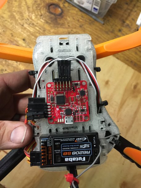

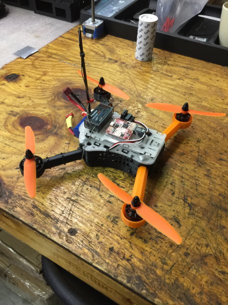

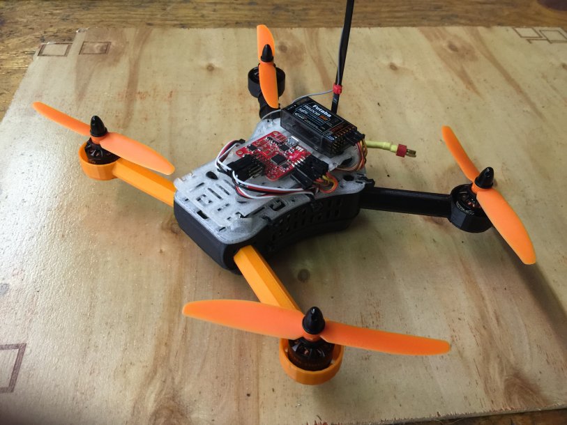

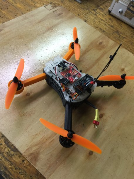

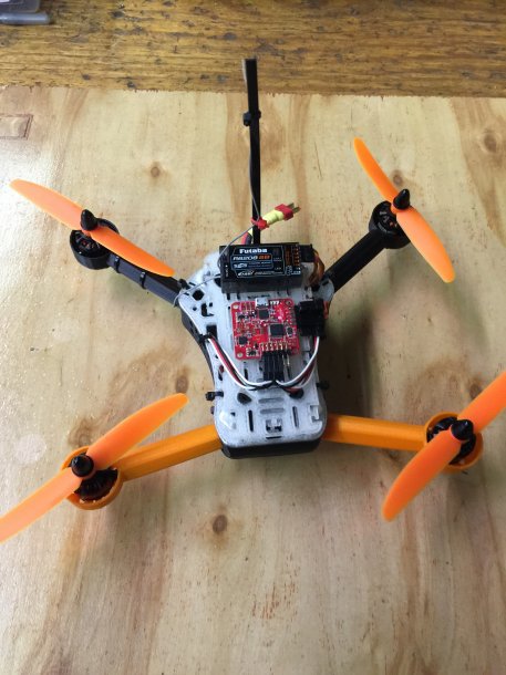

A design was selected SEEN HERE and Josh started to print out all the parts. We used ABS plastic to make the parts nice and stiff, yet valuable enough to protect the electronics in the event of a crash. Little 2300KV Sunnysky motors, 12 amp esc's and a Naze 32 that is controlled by a Futaba radio system rounded out the equipment. Seriously if you have a radio already the rest of the stuff could be had for around $100.
After assembling the rig and doing a little research and tweaking on the Naze32 he rig is flying. It is very stable, and yet manuaverable. In the next few days I'll be adding an FPV cam and TX and I think this could be come my favorite rig I own!

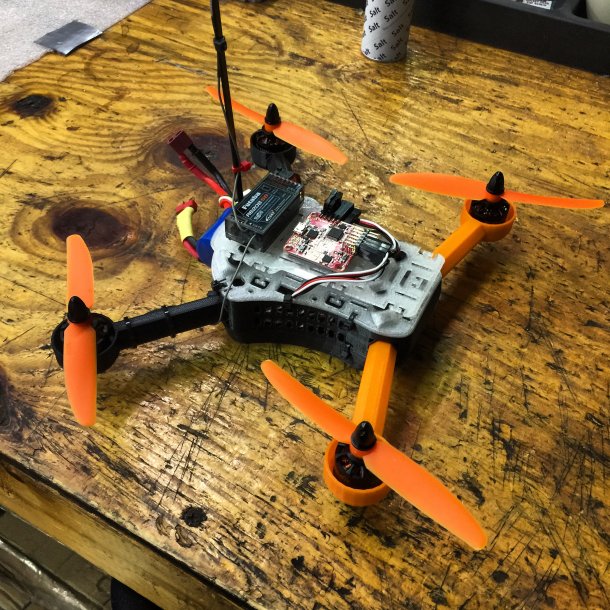

Finished 3D Printed Mini Quad

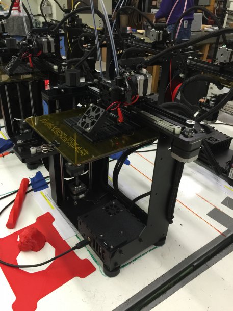

MakerGear M2 - The printer used to print the quad.

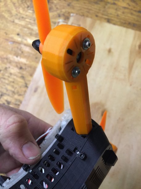

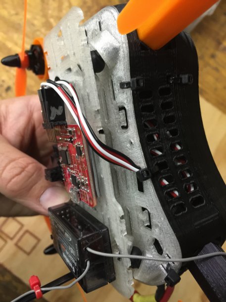

Closer look at the "lil guy"

For the past few months I have been helping out assembling 3D printers at Makergear.com so the idea was presented to me by one of my co-workers Josh that I should just print a quad. At first I thought of a very flat almost G10 looking quad and balked at the idea, but after searching out some designs on www.thingiverse.com I knew that I could print a very stylish little rig.
