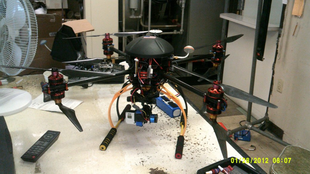

yes , this x8 was a quadcopter in the beginning. I had a prop break off in mid flight ( about 300 ft. in the air). It dropped like a rock. crashed through a maple tree and luckliy the only parts that broke off was the landing gear and the gimbal. the hood that covers the top saved all my electronic gear. (like a crash helmet). I advise you get one. TheX8 Octorotor came about because I wanted "Redundancy." It will fly with one or two motors losing power or props. I have tested this concept on take offs and in flight. I never want to worry about a failure like before. It's twice as heavy as the Quad (9.7 pounds AUW). Flies in the wind MUCH better and the yaw and vertical climb is tremendous. I would always recommend an X8 over a flat Octo. For many reasons that would fill this thread ha ha ha . Good luck on your build! Fly On Brother!

Yes a ten pound weight falling from the sky can seriously hurt or destroys someone or something. I live out in the country and have acreage for a backyard, so I only fly here. I think the only thing I did was scare a bunch of squirrels in that tree. Which also belonged to me. ha ha
