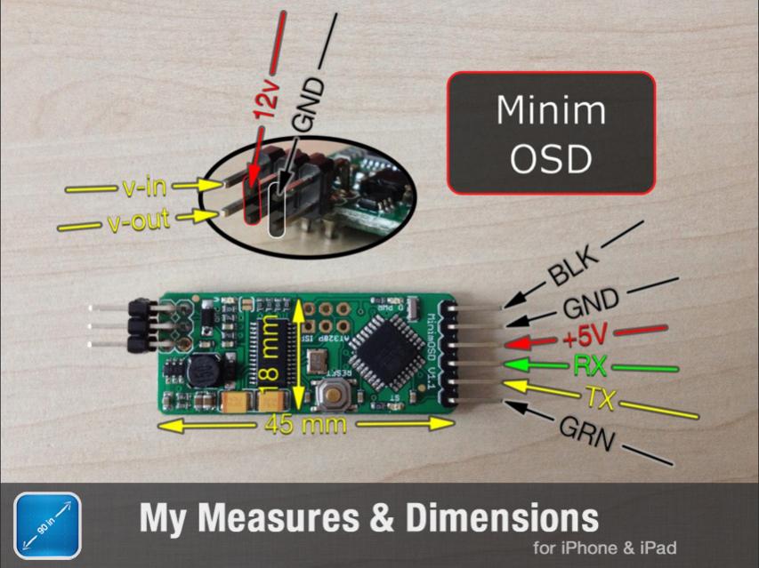

For some flight controllers you can use Minim OSD which is cheap and it is working good.
I use it on arducopter, multiwii and as i read you can use it with naza to.
All depend which flight controller you will be using on your copter.
