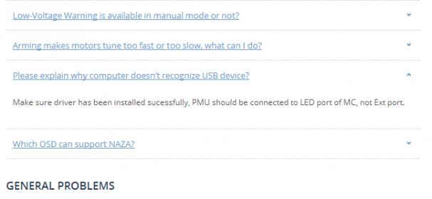

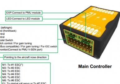

But I find something strange, in the manual for the V2 you shall plug the PMU into the EXP port of the MC, but in the FAQ page on the DJI site, under "Hardware install problems" DJI write "PMU should be connected to the LED port of the MC, not Ext port"
What is right??
