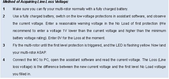

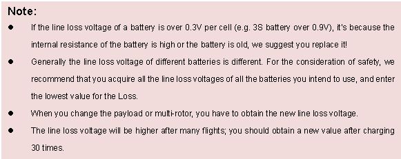

I am hoping there is a simpler way to determine when to retire the LiPos on my MR. Is there a direct correlation between battery line loss and battery internal resistance? If so I am hoping to gauge battery retirement by means of the later. The DJI method for retiring batteries requires multiple steps involving DJI Assitant software including reconfiguration of the battery protection levels between two or more flights. Step 1 and 2 appear below..... I have FPV so I can read battery voltage from the ground.

the easiest way is to use an Internal resistance reading of ewach cell and determine if shes done or not. I never fly a pack with an uneven or high resistance. Icharger, i think that hyperion both read em.
the usual is 2 years or 200 cycles. Some people claim 500 but the way i fly, 200 is pushing it.
