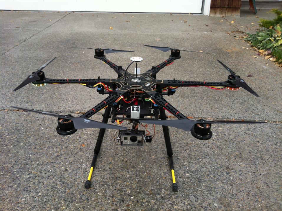

You can upgrade your F550 to an RCTimer - RCT800. That makes it possible to increase prop diameters so that your new motor/prop combos can remain in the sweet spot for max airtime for heavier payloads. See photo example here. I was able to use it to do an entire 18 hole golf course last fall using a GoPro with max flight time of 23 minutes (less with a Nex obviously) View attachment 17493
gtranquilla
RadioActive
Motor arms are very stiff indeed. No related vibration issues. But keep the IMU mounted below the Hub on an anti-vibe plate as the prop wash tends to mess up the baro sensor otherwise in forward flight.
Also keep in mind the the motor arm height at the hub is slightly less than the F550 arms such that some DJI components such as the WKM IMU will not fit between the two plates anymore etc.
I used Turnigy Multistar 400KV pan motors and 45 amp ESCs..... Had over 135 successful flights before selling it.
Are the RCTimer arms pretty stiff? Does the flex give you any problems with vibrations?
