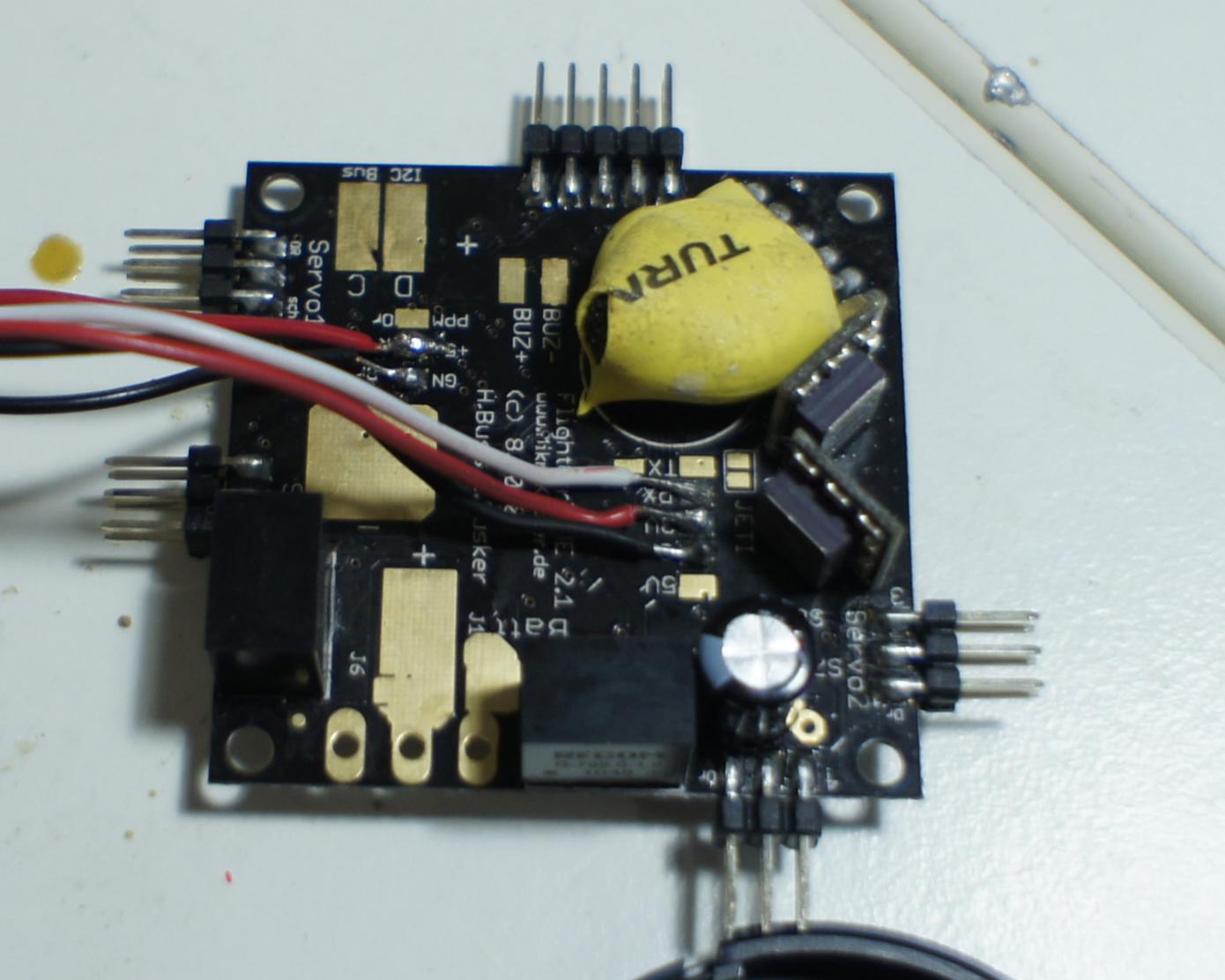

I'm using Spektrum DX8 with Quadro system. To get telemetry, I soldered +5V power pad for gettting power for telemetry module. And I changed the 16V 330uf capacitor with 25V 330uf capacitor.
The weird thing is, I did a smoke test with a success and, I powered the system with Lipo. Level calibrated and compass calibrated withh success too.
I powered the motors for 1 minute and then pufffffff.
Bl Ctrl's are healthy, but FlightCtrl seems to be dead. There's no sign of life.
What might have caused this blow out? Can it be the 25V capacitor? I'm sure that there's no short circuit. And, what should I change on the FlightCtrl to make it work again? There's no visible damage on the FlightCtrl.

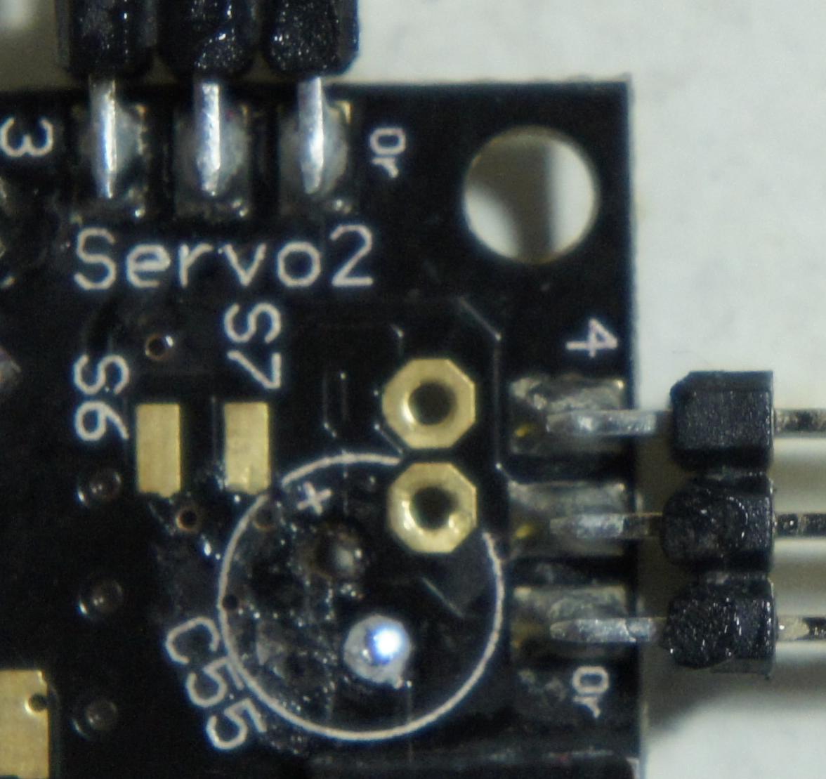

I took the picture where I supposed to solder the capacitor. (originally 330uf, 16V). there's no soldering pad left on the positive (+) side.
Could that be the reason why I can't read any voltage from recoms or the diodes?
I really don't know how to fix that soldering pad.

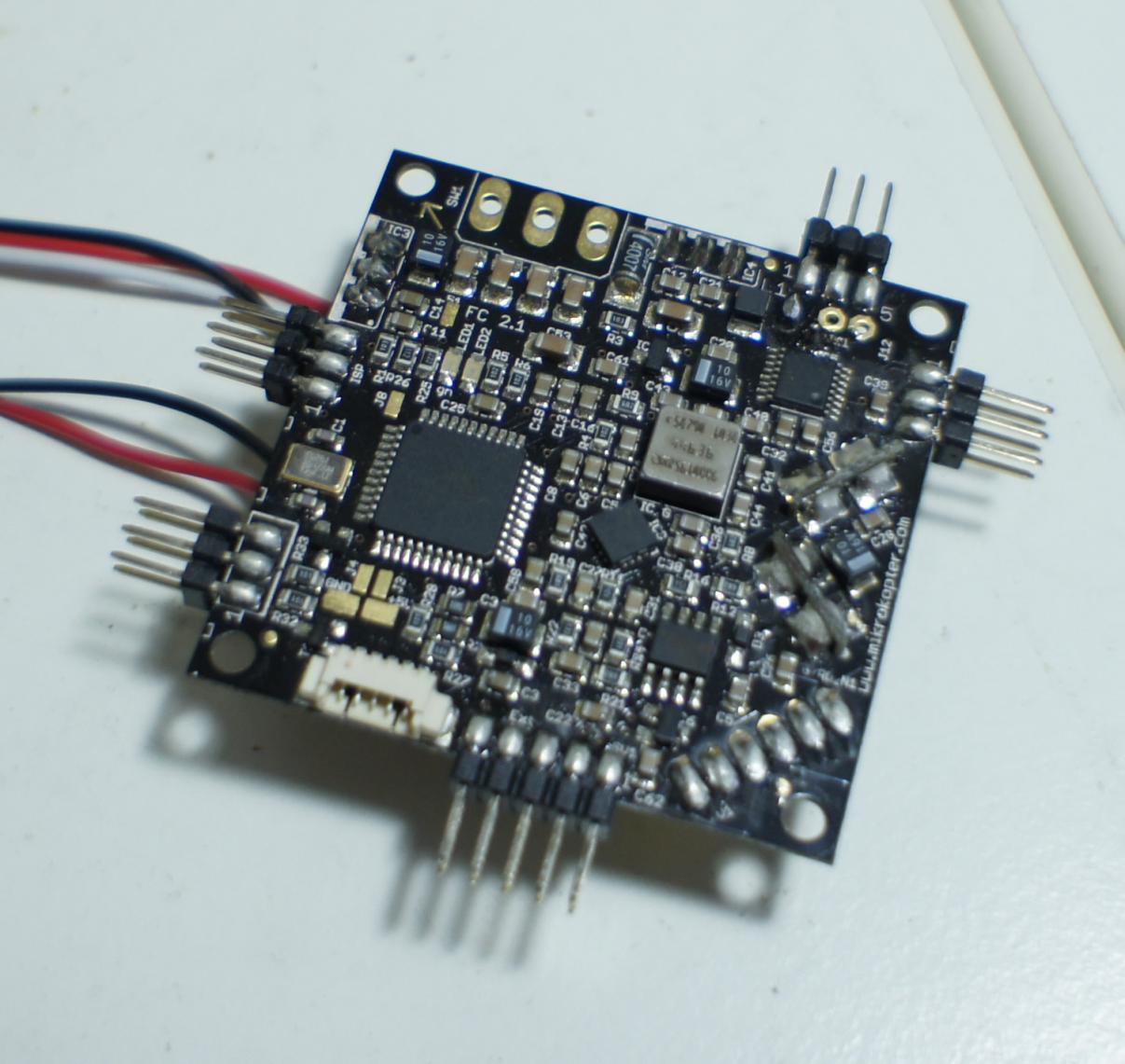

I cross checked the board with another healthy FlightCtrl board. Nothing seems abnormal, except the missing soldering pad on the capacitors + side.

The cap pad in your photo probably won't matter. That leg is connected to an internal board layer. Either way, it shouldn't stop the board from running off of USB power.
The last thing that I can think of is to compare the polarized caps on your board to a photo of another board. Right next to the arrow on the FC is a polarized cap for reference. The polarity line on the caps should match another board.

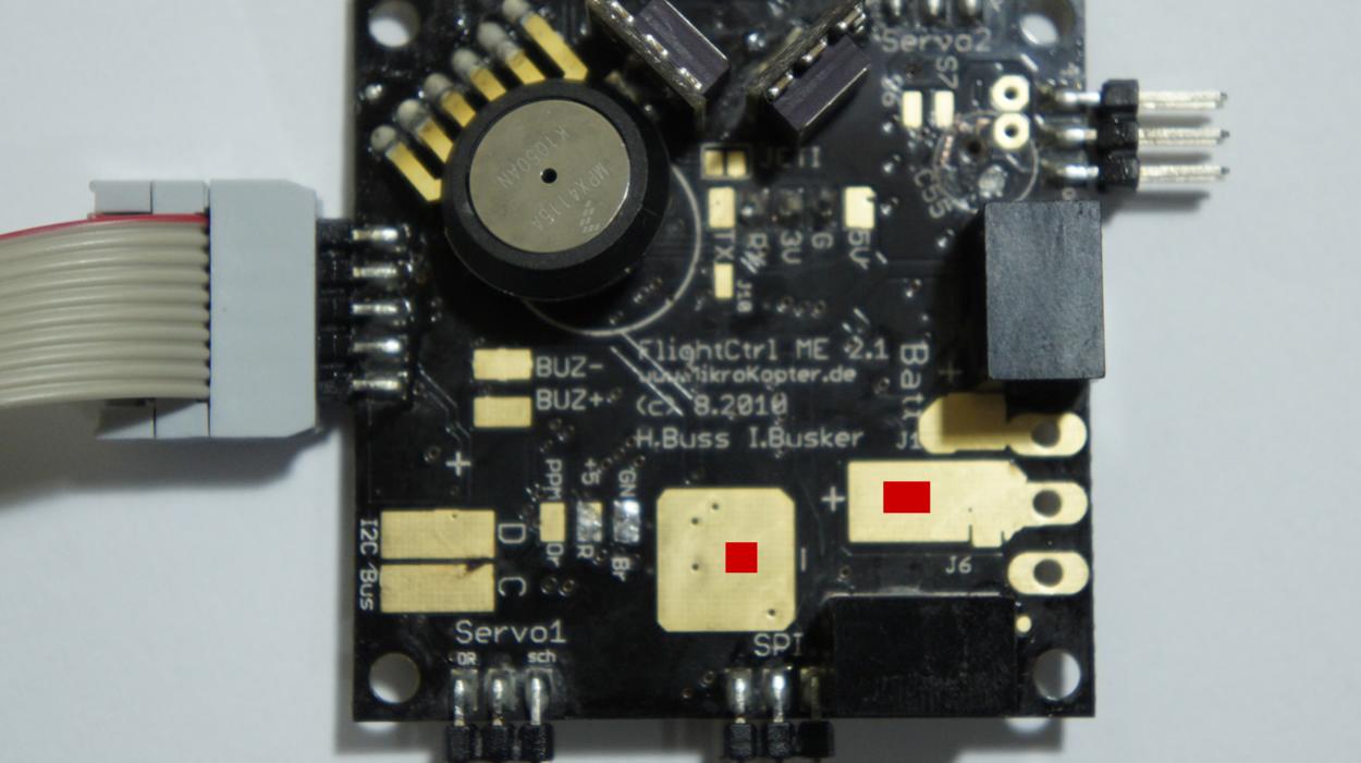

I'm checking if there's a short circuit. When I checked the big + and - pads on the bottom side, they are shorted somehow?:
(I marked the area red where I checked for short)

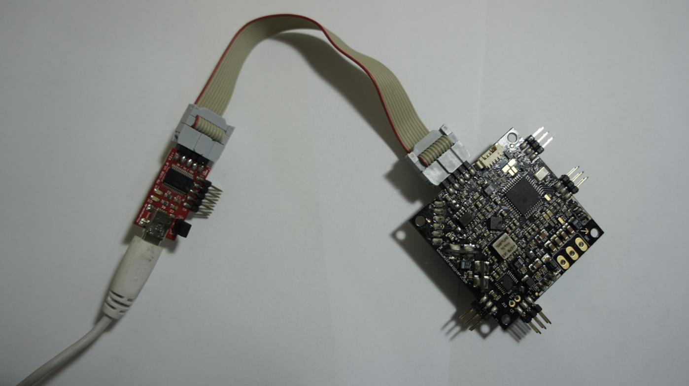

Here is the picture of MKUSB connection:
(PS: My DC Power supply can provide me only Constant Voltage or Constant Current)

So it seems that something is dragging down the 5V line. I don't know if you could have damaged recom IC4 or if that could even be the issue. I don't know what else it could be other that foreign matter on the board or an internal short on the atmel chip.
I think you are going to end up sending this board back. I would not recommend you try to pull the recom due to the possibility of board damage. It's very easy with the proper tools but judging from the cap pad, I'm guessing you don't have a good solder sucker or chipquik.
