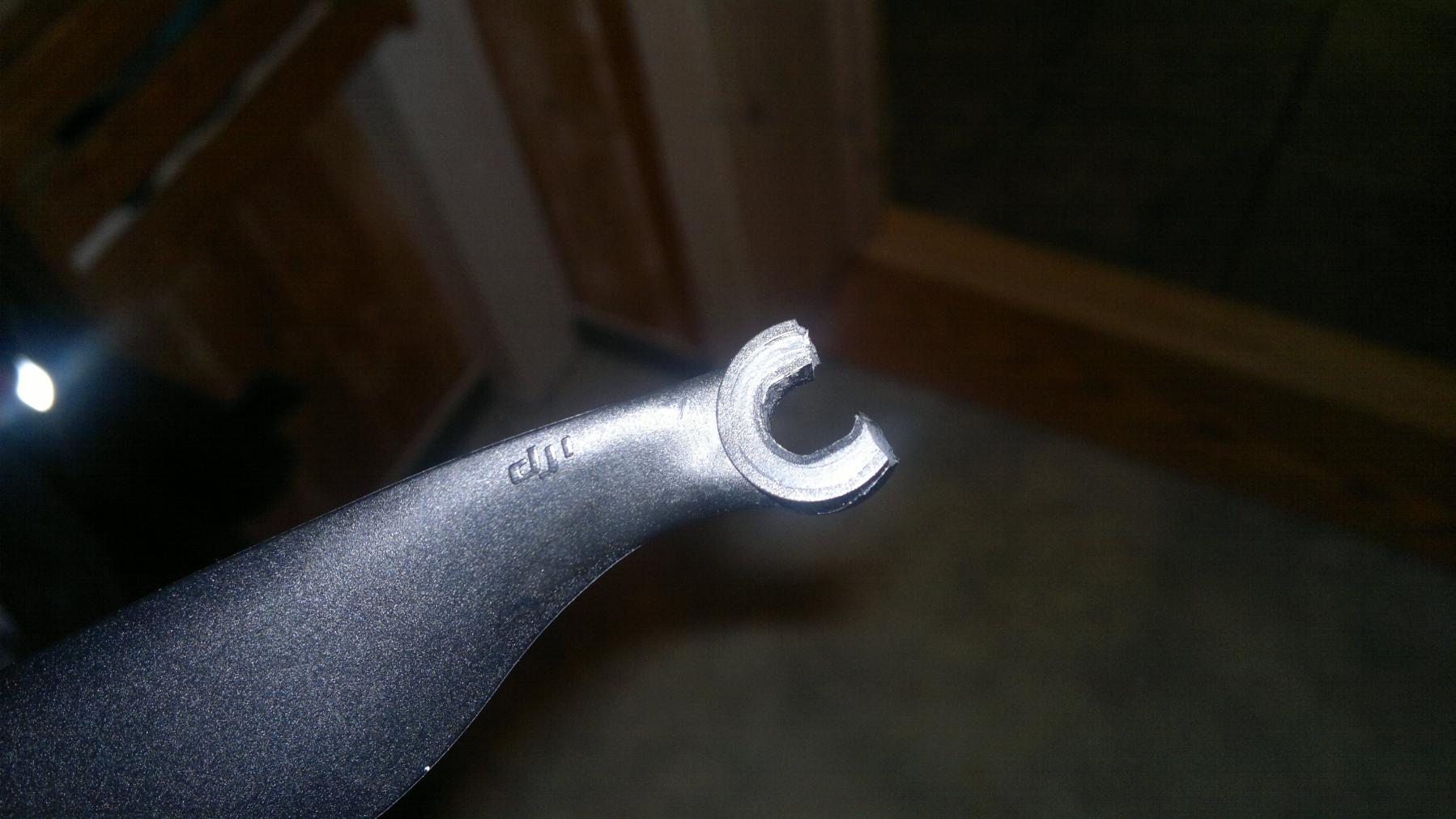

I am asking because I have some strange behaviour yesterday. I was flying my f450, 10" dji props and 4s lipo. suddenly the quad tiltet bak and to the right and flew in to woods. I heard a big crash and thought everything was lost. but when i found it the only dammage was a broken prop. the one back on the right side. it was broken in the middle of the hub.
Tried it with 8" props when I got home and everything seems normal.
I wonder if the prop break in the air and was the reason to the strange behavior. Here is a pic of the rest of the prop that was left on the motor.

Hi Tyor. There are many report about braking DJI props.
Looks like you over-tided the the prop-bolt and that results in little cracks in the hub. Rotating with a few thousand RPM the hub brake.
You shouldn't use the DJI's anymore.
Without payload you can use APC
With payload like cam's etc, use Graupners
