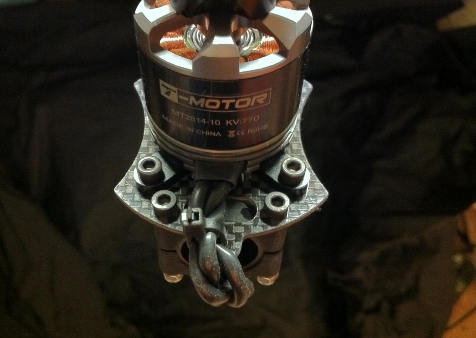

It has finally start arriving parts to the frame so I have started to mount the motor mounts on the arms..
And without the center plate and the rest, there's not much to build.

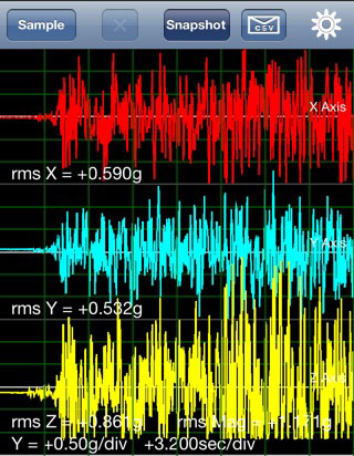

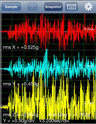

So I have balanced the motors and made a video of that:
(just example motors in vid)
To be continued.
Kilby
Looks nice, Tommy. I need to have a go at my motors one day with this app... thanks for sharing!

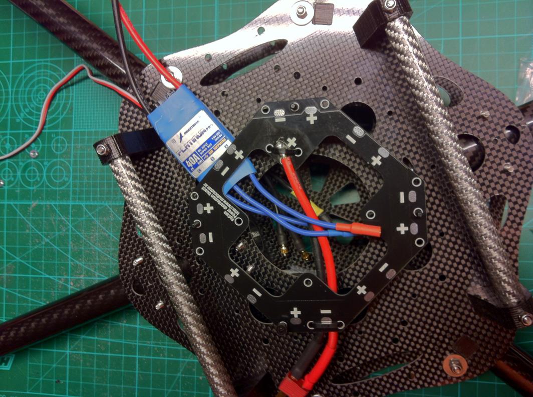

I started off by look at the layout of the ESC's and installed a pbd:

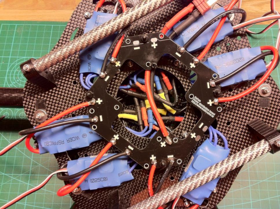

I twisted the motorcables to reduce the electromagnetic field:

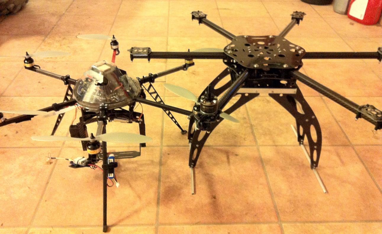

Here it is next to the MK-Hexa2.:

More wiring..

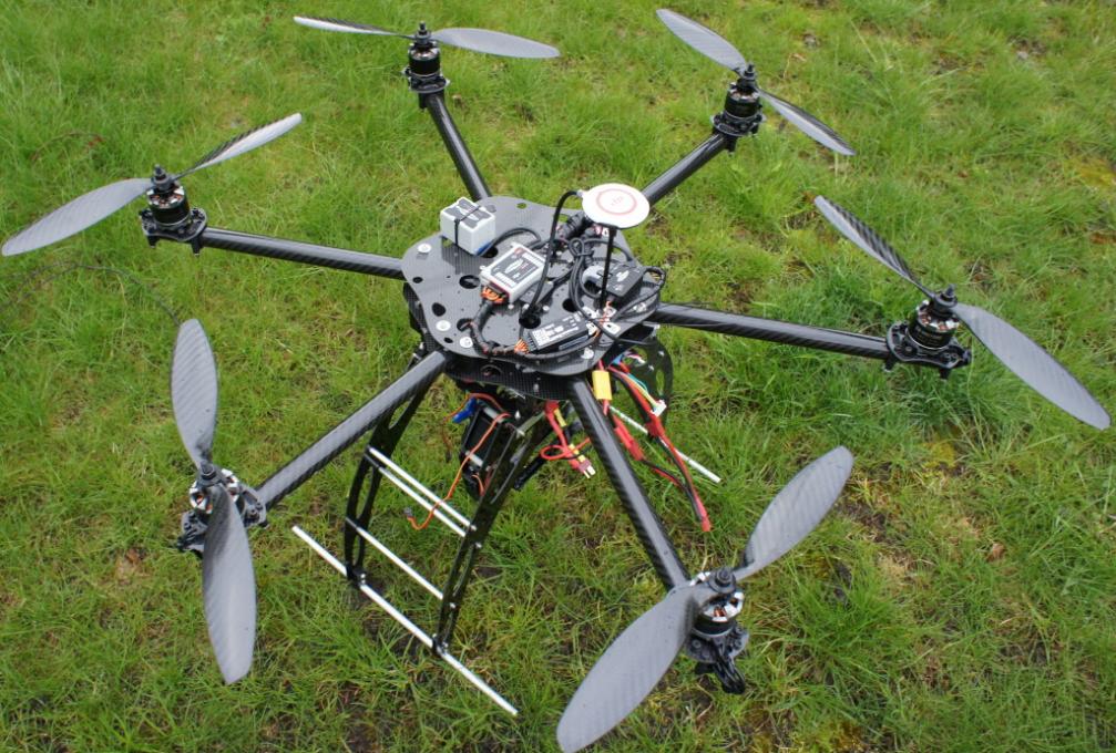

And now it's ready to go ...
