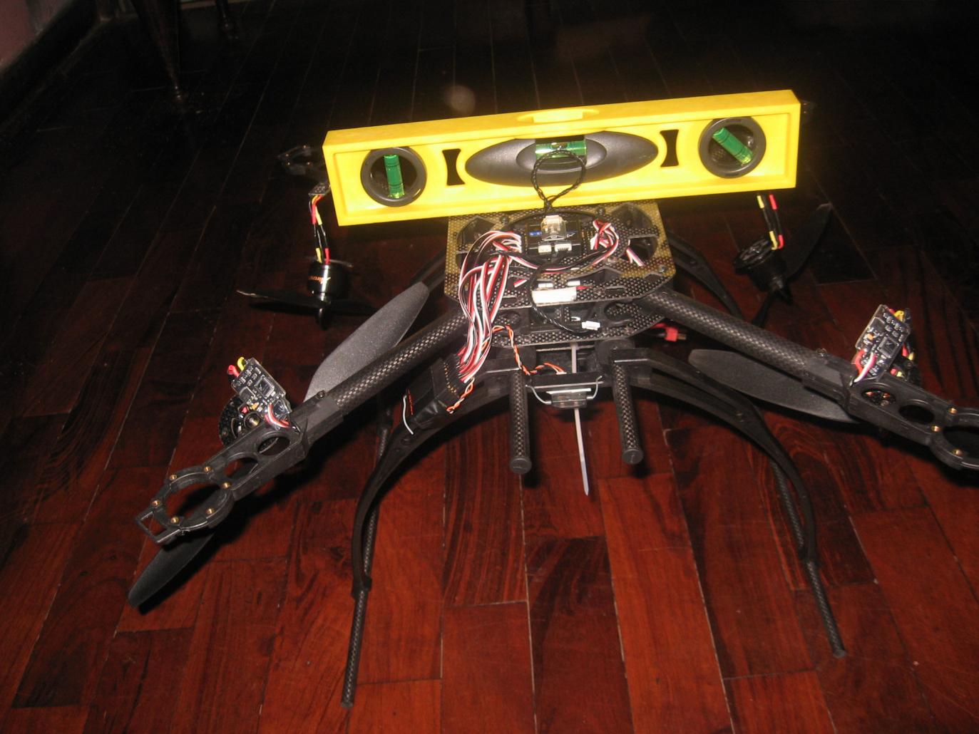

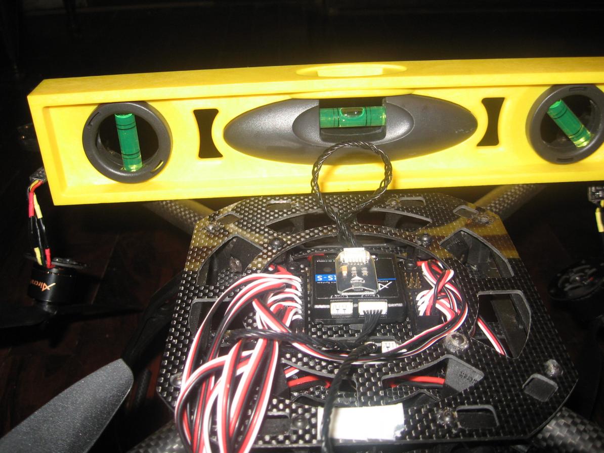

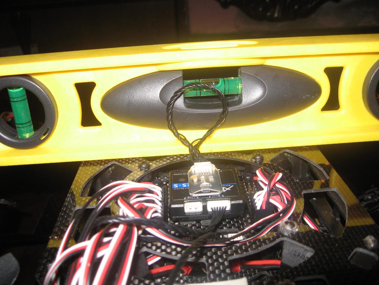

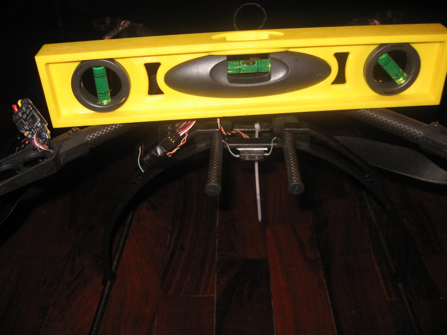

Hello my friends, after a week of not knowing what to do, Jeff , contact me with Jingchen, eminance of Xaircraft, told me that a motor was on diferent plane as the other, so I couldent belive it , because at simple sight all for motors were aparently stright, so I decided to take off the motors and measure first of all the center plate with a bubble ruler , the results as shown in pictures 1 tru 4, the buble always on the center
View attachment 1133View attachment 1134
Then I measure all base plane of each motors
So the motors front left and back right the bubble were to way off the center, so what I did was loose the screw and turn the arm until the bubble gets to center.
Then Test flight, and excelent that was it, I hovered very smoothly and much easier than my blade450.:highly_amused:
