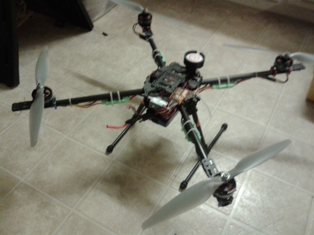

Not a pro but I built a folding Tarot Ironman 650, 4830-420 Multistar with 45amp Multistar ESC's,
flying 1455 APC props on a Naza V1 and 4S 8000 30C battery. DX8 Spektrum
With Feiyu Tech 2 axis gimbal and a GoPro 3+ black,
Extremely stable, highly visible for LOS and flight times over 25 min.
AUW is 2935 gr. and it will lift a refrigerator. (Well,,,, almost.)
In the process of fitting it with retracts.
(Mid construction photo.
attachment.php
Final with GPS and Battery
attachment.php

I have the same 650 frame and was wondering about the motor/ESC/prop/lipo combinations... The MS 4830s look like big motors more suited for a larger frame. But if it's stable and is flying for 25 min on a 4S with the gimbal, then I might give them a try.
It's a really well built frame and I like it.
It's been far too hot for me to go play in the sun but with cooler weather coming I hope to get some nice beach and inland videos.
I must admit, I was given the motors and esc's by someone who bought them and had no idea what they were buying.
They sat in a box for over a year and then I pulled the trigger on the 650 frame but it gave me a nice head start on a bigger quad.
