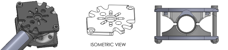

Pretty much Ryan - though since on the SkyJib mounting with the larger motors was a bit tight we have designed some specific disks - are being manufactured now and will be available in about two weeks - see drawing:

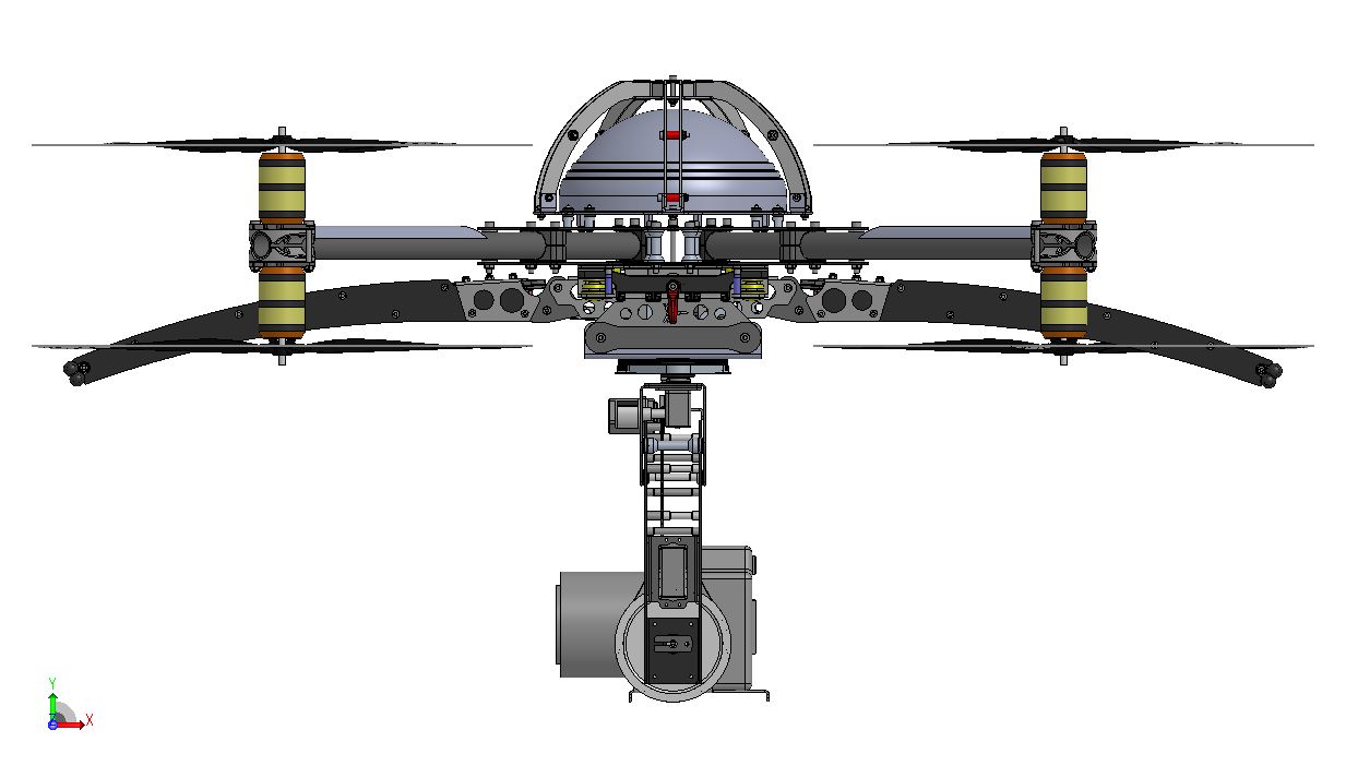

Re. the retracts in conjunction with coax configurations:
This is a 3D CAD markup of the Retracts at the 160 degree position - any further and the LG skids contact the props (15" props shown here). The end points can be further adjusted to offer slightly more clearance under the props.
Images attached.
Regards Rob.
View attachment 7750View attachment 7751View attachment 7752View attachment 7753
