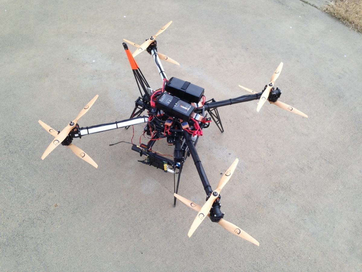

Here is a picture of before:

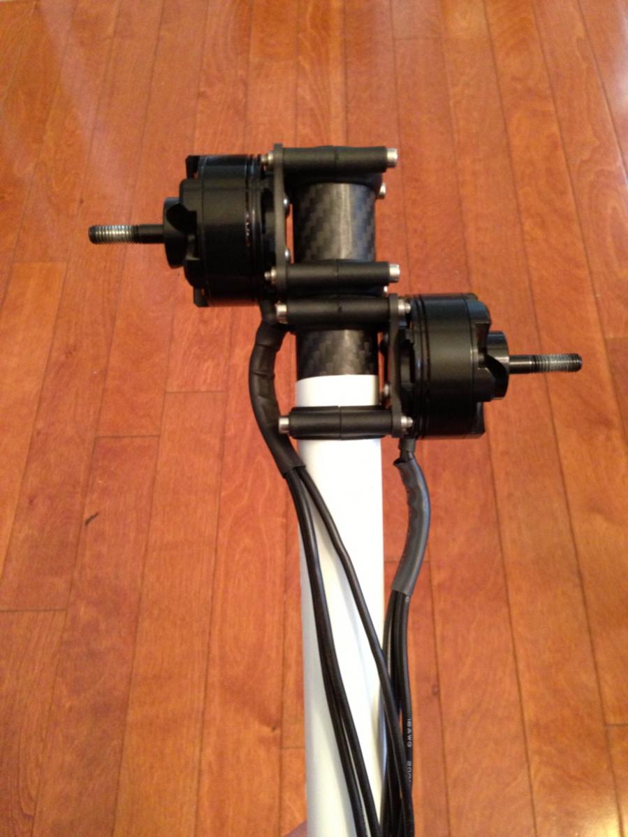

Here is a picture of what I mean by offsetting the motors (inspired by another forum user):
Here's what it ended up looking like:
So basically I ended up with a Cinestar X8. But the top motors are inboard and the bottom motors are outboard (hope that makes sense). I only got to run two flights, but they were long ones, and I got so-so results. I'm using a Hoverfly Pro, which flies awesome in my typical flat 8 layout (almost 1600 flights). Initially I had to reduce the gain by a fair amount to get it flying decent. It started to fly decent, but not as good as what I'm use to.
Here's the main issue I ran into - it would yaw a bit here and there. That gave it a floaty feeling, not as locked in as I'm use to. The yawing would drive my camera op nuts. I've got a few theories as to why it is yawing a bit:
  • One motor isn't totally lined up correctly. I had to eyeball it all. There might be one that's off.
  • All the top motors spin clockwise on the top and it is reversed for the bottom. Having one set of motors closer in to the center could be causing some funkiness.
So I'll double check motor alignment. I may reverse the offset of the motors on the back booms.
So why did I even try this? To do a bit of experimentation. Also, I wanted to try a coaxial. And last, I've been wanting to put bigger props on without having to buy longer booms. I'm the type that either works with what I have, or ponies up the cash for the best - there's no in between. So it looks like I may need to invest in longer booms. I'll follow up with further results tomorrow, but I don't think I'll be sticking with this setup. But I'm glad I gave it a shot!
Let me know what you folks think...

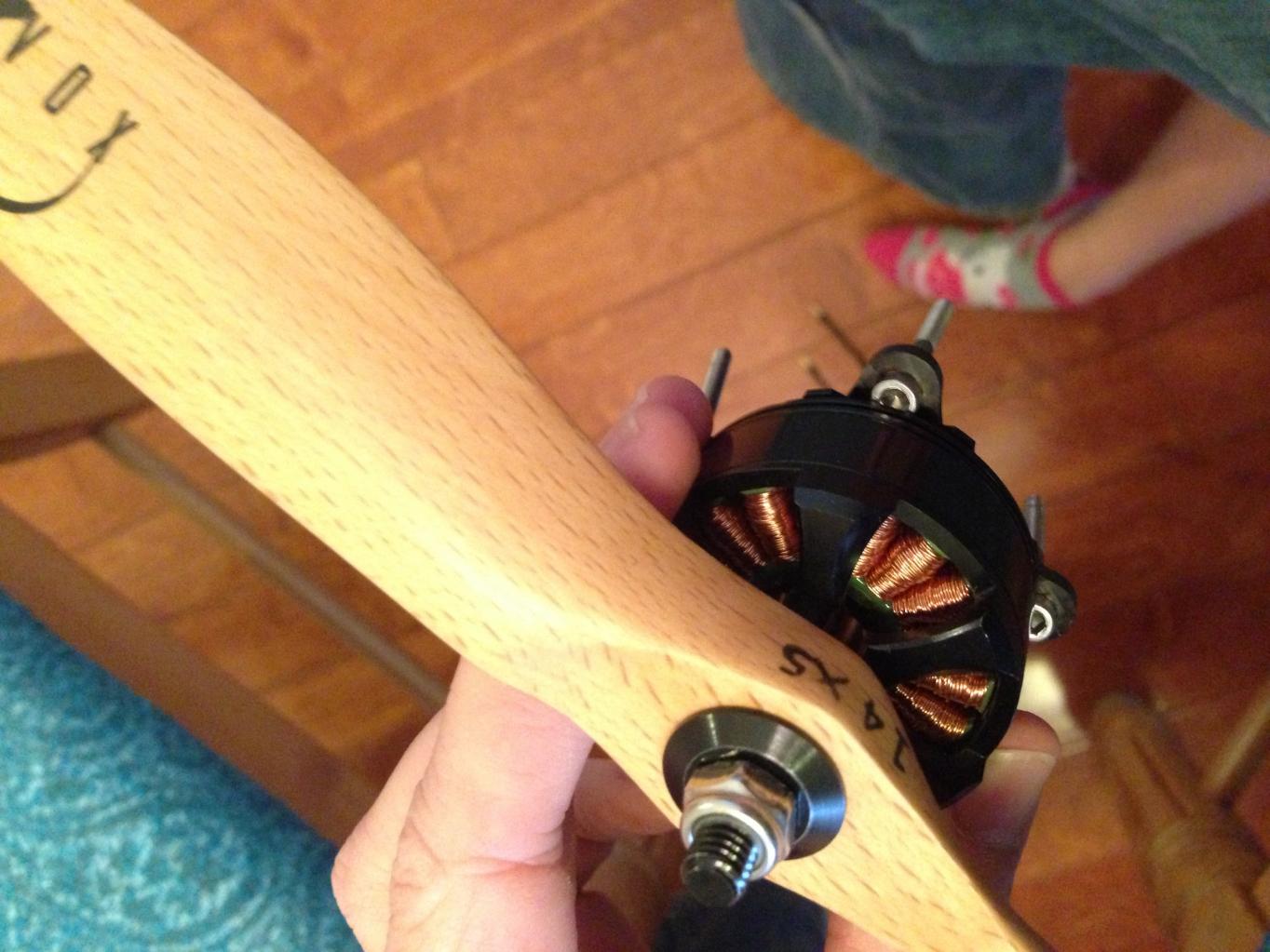

That was my original plan, but I ran into this problem ( see the picture ). The screw heads weren't accessible. My daughter was determined to get her foot in the picture.

Easiest would be that you take a very long screw (cut the head off) or a threaded rod and use flat nuts on top and bottom.....you should be able to hold the nuts with a spanner since they are pretty flat in that size.....a bit of fiddling, but should work. On one side of you could glue the nut with super glue if you like, but thread-lock on both sides should also be fine.
i know it can be done but you need some luck and some persuation to do it. There is one key that has the option in sliding inside. Or you need some spacers under motors, but then you need to cut some carbon to make it dubble thickness.
