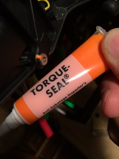

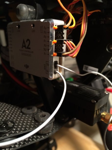

scotth
I use it on all the smallest of hardware and also plugs. Gives you an immediate visual if a plug or screw is loose. But I guess if you are going to squirt it on like toothpaste I can see where you would have an issue.
Pumpkinguy
I wasn't busting balls btw. Didn't know it had a tip that small on the tube. Does it have any adhesive qualities on your a2 for example. Will it hold those plugs in a bit? Like silicone?
scotth
Hahahaha ok... well I was :) No, it's strictly a lacquer based material and will crack and flake off if anything moves.
