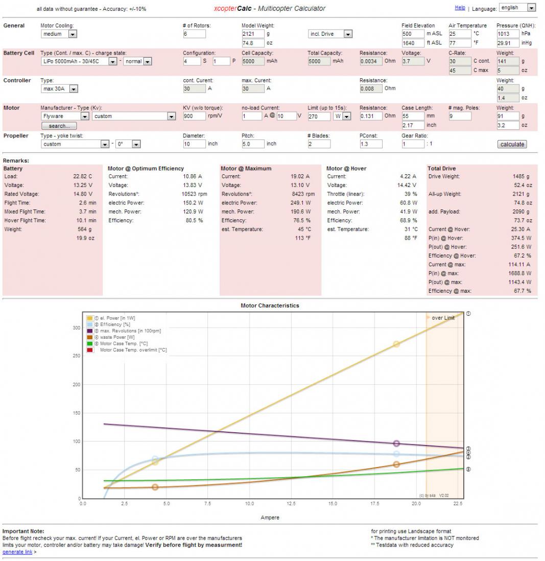

From what I've read your throttle @ hoverspeed should ideally be between 50-60%, over that and your craft becomes too irresponsive and might not take off at all.
But too low? In my case between 30 and 40%, does it become difficult to fly?
Here the ecalc result (Im using NTM motors which aren't in ecalc so I tried several similar motors):

The will make the copter very twitchy. Your power to weight ratio is a bit high. Looking at your flight times, something is very off. You might try increasing the size of your props to 12" that should get you closer to 50% and should increase your flight times. If your frame doesn't allow for 12" props, try a higher KV motor. I'm sure there is more tweaking to be done.

thanks for the response. I would have guessed that 'twitchy' is what happens, but I liked it verified. The frame allows 10" max so no go there. As for the tweaking, yes the flight times seemed a bit low, but what can I usually expect?

I think a good goal is to shoot for around 8 - 10min mixed flight time. if possible. Just for fun, try changing the motor to a higher KV motor and see what it does to your times and hover %.

I think we all hope for 20min mixed. And, it is possible but harder to achieve - you'll have to get the right combination of components, weight and power. That is why eCalc is so helpful because you can model all of the possibilities. I'm sure it's easier with the smaller multis as well to achieve those numbers.
