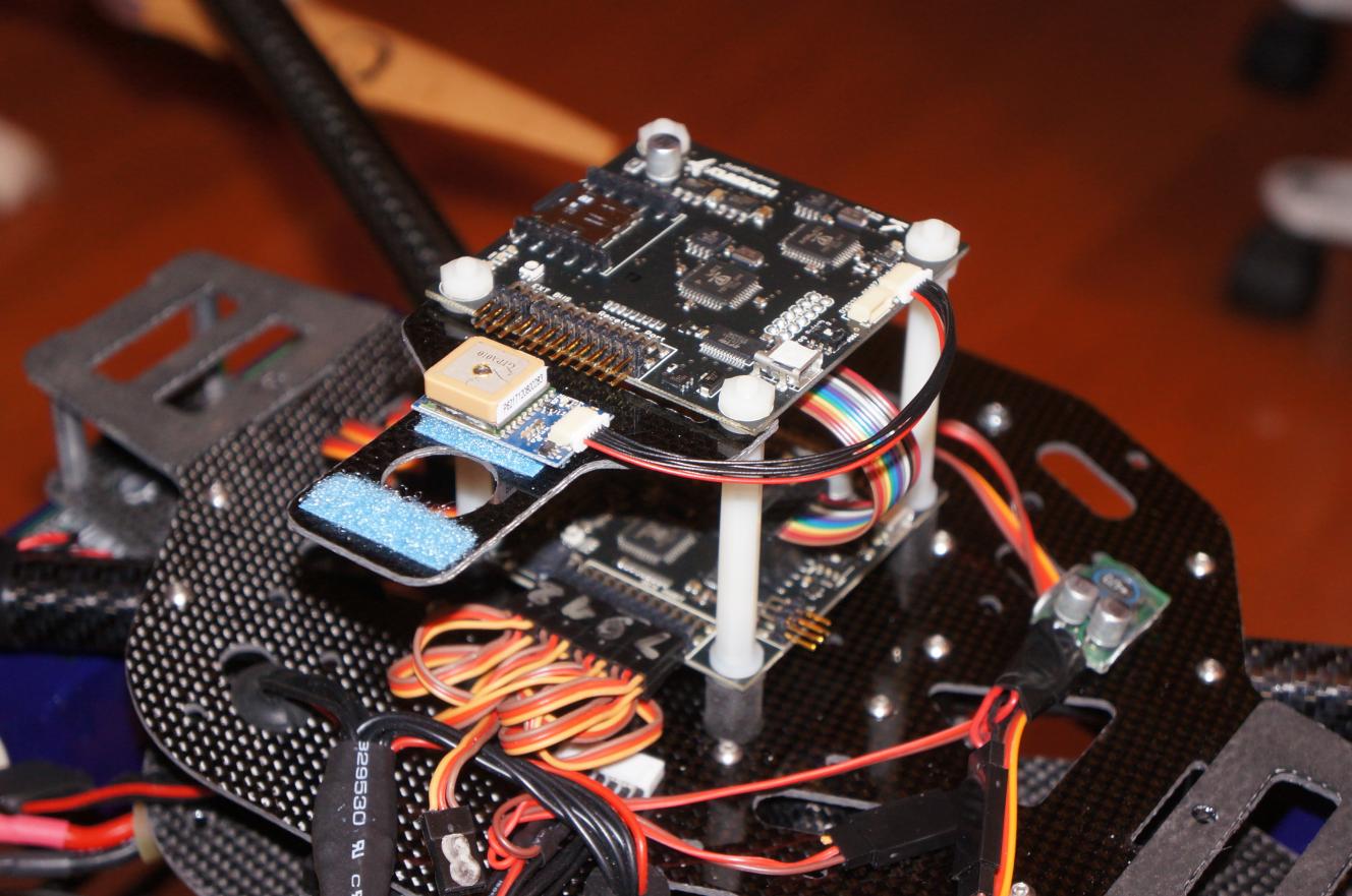

i don't have an external mag but I do have my GPS board and antenna on 2" stand-offs above the PRO. I'll move it down onto 1 1/4" standoffs tomorrow and then try it again plugged directly into the board. Al told me after the fact that the beta software was calibrated for Orlando, FL so there will be improvements with heading related performance once the actual public release is installed.
