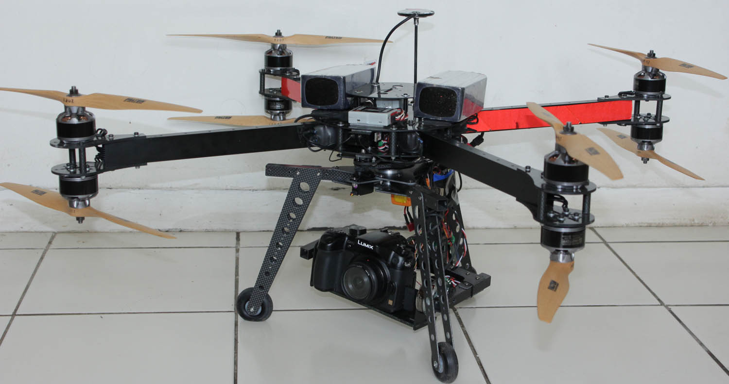

I got 16 min. (On telemetri still 21.5v before landing) with my X8(5.25 kg).
WKM, T-Motor 4014 330 kv, 14.47 wood(thin E), 2 Pulse 5500mah 45C
Very stable in highwinds
Ary
