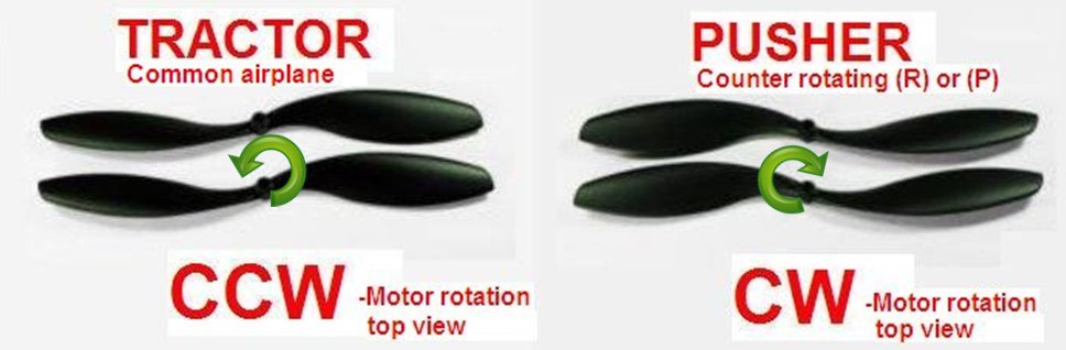

I thought Id put together a little noob faq on quadcopters, yes Im a noob lol.
1) Propellers come in 2 different designs some go clockwise others go counter clockwise.
2) There is a front to your quadcopter.
3) The motors on your quad go in different directions.

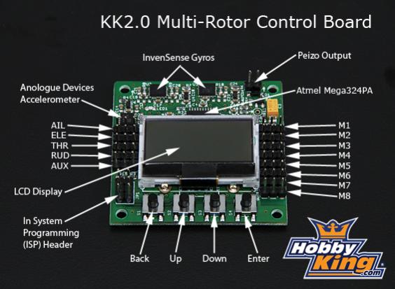

4) There are about 20 flight controllers out there.
5) People have made a DJI Tricopter.
6) The 2 images below saved my bacon.

11) You can change the poles of your motor to change the spin direction.

Actually I heard that this is not always the case. Some motors have 3 states and that doesn't work. Also I heard that your motor will die quicker.

Err... No.
The motors are basically three-phase AC-motors. You can switch the phases around any way you want, they run just as well anyway. The motors don't have any state at all.
