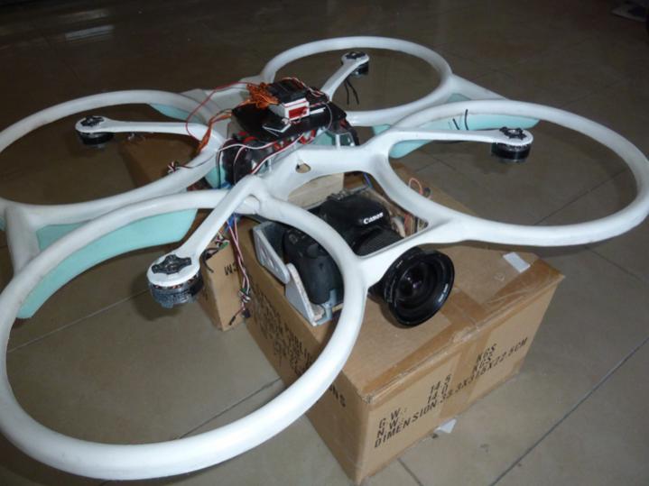

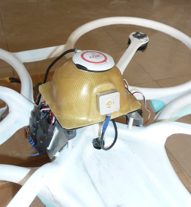

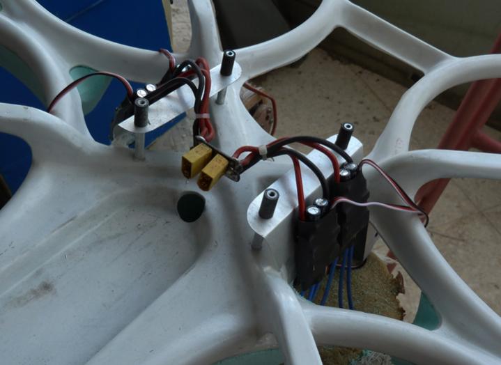

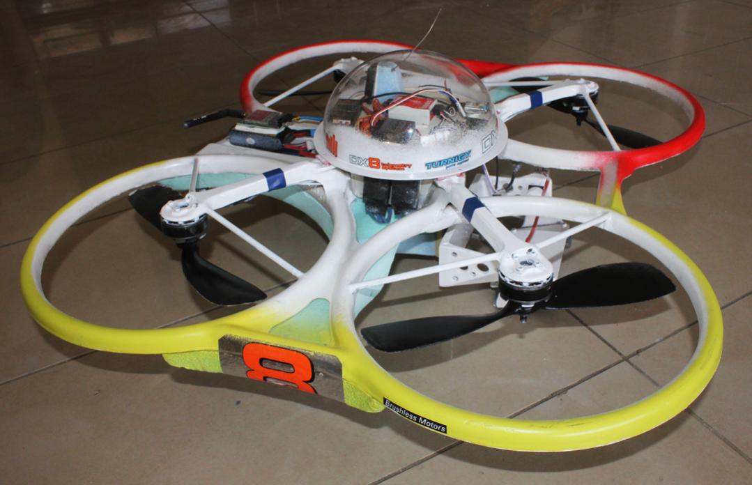

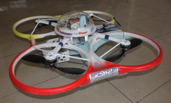

Looking good DennyR
nice and sleek whats frame made of looks like some sort of abs or polymer
cant wait to see it in action
nice work

The lay-up of each frame takes about one week to build as it is a composite of end grain soft balsa, carbon, Kevlar, foam board and some alum, hard points. The molds to create it took considerably longer. No steel fasteners anywhere. Weight is the enemy. The plan is to sell a few to high end users but at this moment in time it would be far too expensive for the average hobby modeler. But when you take into account the high cost of some of these heavy lift Oktos that are around then perhaps it will not be considered that expensive after all.
It is a flying camera where the operator steers the camera and the model follows with high precision.
Floatation panels can be easily replaced as they get soiled with use. These are not designed for take off over water as their function is to allow the user to retrieve it should it run out of power over water. It is not therefore a totally waterproof solution as the camera is not waterproof. More follows!!!
It has rained here for the last six weeks which has hampered progress on the flight demos. Normally see a ten min. shower once a year.
The shrouded rotors are primarily a safety feature but as the carbon props are going to be expensive to autoclave they are also a cost saver.

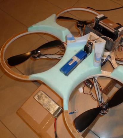

Not quite ready to reveal that little secret just yet but the Tx input steers the camera as a primary action. View attachment 2546 This is the second battery bay.

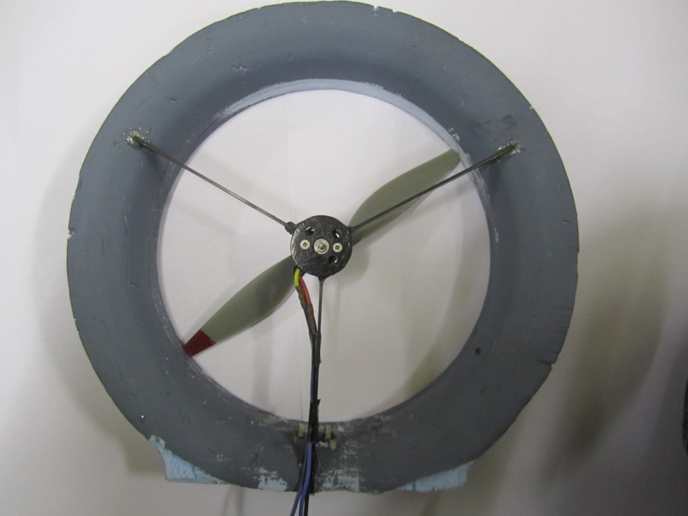

Denny, don't be patronizing, I'm not changing any physical laws. The Bernoulli principle can be applied even with the small propellors we use in multicopters and at reasonable delta V's.
For example I have a 9x6 APC E prop driven from a AXI2212/34 running off 4S, to produce 400grm thrust it uses 72 watts. I have a test bellmouth 9" ID x 12" OD made from Blue foam turned on a lathe and glassed it weighs 36 grms. With this Bellmouth the power required to produce 400 grms reduces to 45 watts. If you do the maths it shows a clear benefit.
Your reference to F3 engines relates to the venturi effect which is a different application of the Bernoulli principle.
Please understand that my original comment was to offer a constructive and useful contribution and not to criticise your design in any way.
charlie,
i'd be interested to see pics if you're comfortable sharing your work. i'd guess the bellmouth is increasing the efficiency of the propeller tips. sorta like winglets on an airplane wing.
thanks,
bart
Bart

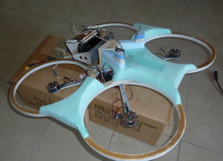

As you can see it ain't rocket science. I agree that it also reduces tip losses and this adds to efficiency also, in fact the 9" prop is cut down to 8.75" to square off the tips, this helps.View attachment 2740

The only way that you can get more thrust is by using the bernoulli effect to create low pressure around the rim AND have full pressure recovery on the back side of it. The velocity is simply not high enough to make a significant difference. The other way is to move a greater weight of air through the disc area over the same time scale. I have a proper test rig and have developed more efficient blades which do improve the thrust but not by 30%. that is pie in the sky.
If 30% increase in bellmouth efficiency was possible don't you think that every propeller driven aircraft in the world would have a bellmouth surround and every helicopter?
I spent many years working with the top aerodynamicists in F1 and we had a lovely saying. "When facts are few, Bulls..t abounds.
The natural flow of air into a propellor is almost identical to what it does with the belmouth. Even with near sonic flow the radius of the bellmouth can be as small as 1/2 " and still maintain laminar flow.
I know it is fun to tinker with these ideas and why not. It is the accuracy of your test results that have to be honest if you want to move forward.
