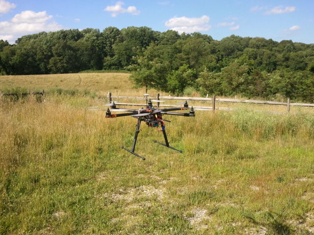

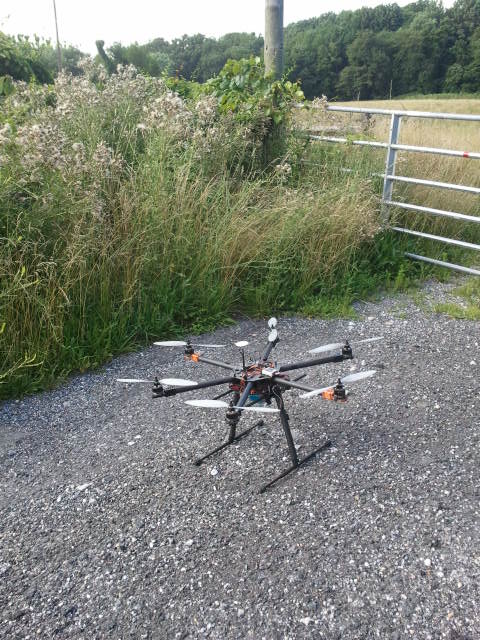

jhardway

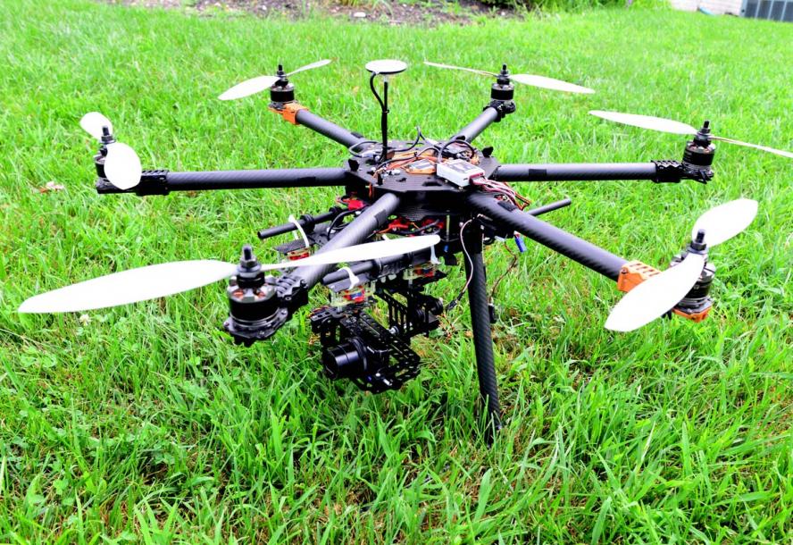

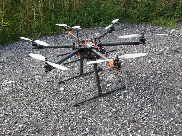

here are some first flight photos, Over all good result, winds were around 10kts gusting 18kts maybe a little more. Flew well, where seeing some white lights, not sure if that had everything to do with vibration from where I placed the IMU or just needed to be properly calibrated. During the last session I seemed not to see any white light, I live in -11 degree area, after calibrating the compass at 0 degrees off center, and then rotating it counter clockwise roughly -11 to -15 degrees. it seemed to go well.
I flew it pretty aggressive at times and was over all happy.
cheers
View attachment 12605View attachment 12606View attachment 12607View attachment 12608

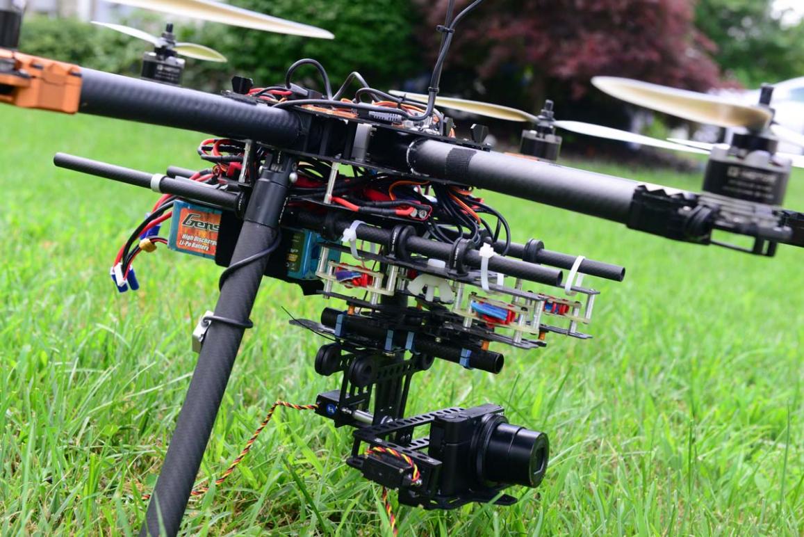

jhardway

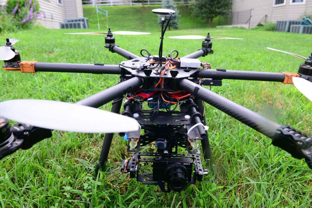

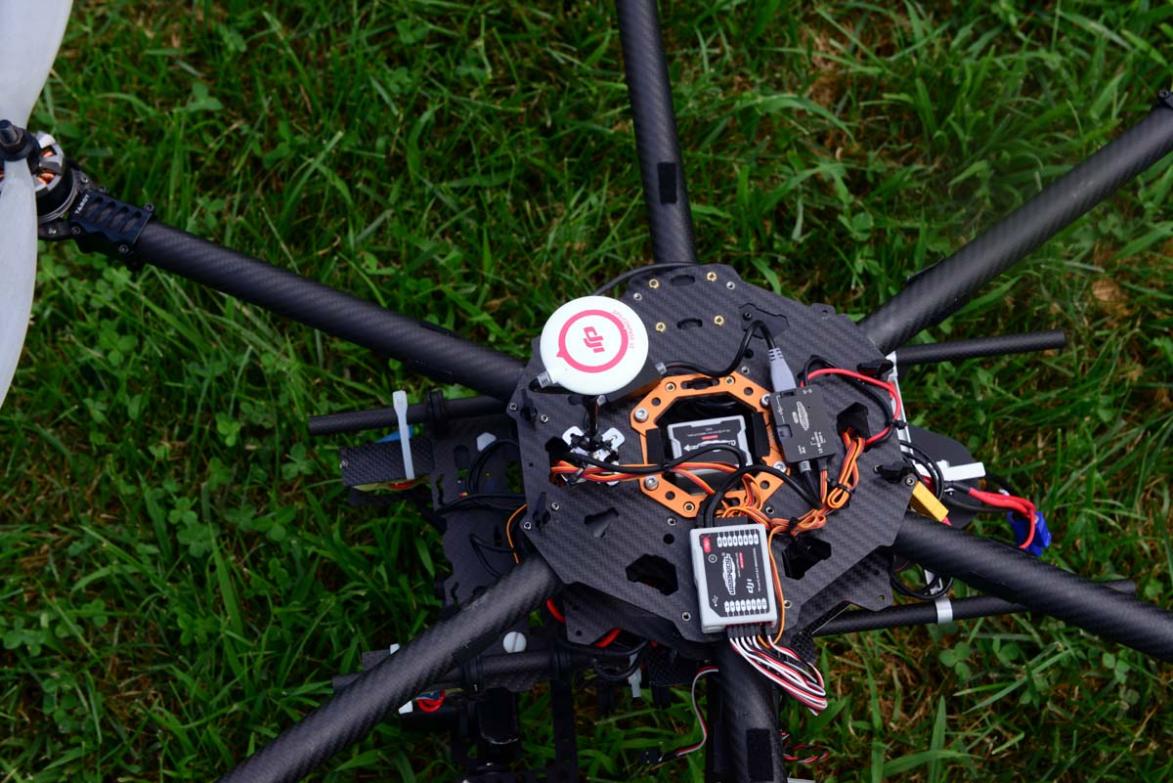

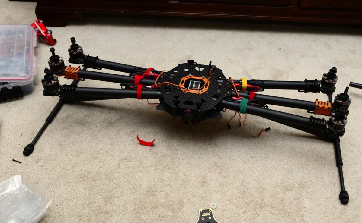

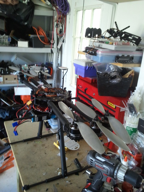

Here are a few more photos, My next move is to take a few in flight photos and get some vid, but for the time the copter is flying well and even when its out of balance it seems to be in a good state. I am in the midst of working on the gimbal. Even though I do not have a brush-less setup yet I am going in that direction. For now I am trying to make the smoothest gimbal results I can.
cheers Jack
View attachment 12690View attachment 12691View attachment 12692View attachment 12693View attachment 12694

For your photos it looks like you have a second base plate installed under the main body where you esc are, did you add this or did it come with the kit?
Andy
jhardway
Andy,
Yes I did add the plate to the bottom, I would have done the same as the t810 plate but when I looked into it, the cost was $97 so what i did was order a center hub plate for a
[h=1]Tarot FY680 Adapter Cover Carbon Fiber[/h]the cost was like $20, I had to make a small cut and drill a few holes to line up the post. but at the end of the day it works pretty good.

From the photos on the website it looks like they have changed the way the arms lock with M4 screw, this should be an improvement. Is there anyway this can connect to the gimbal? It is great having a folding hexa but with a gimbal below it does not fold up that small.
Could you take some photos for me showing how the gimbal attaches and how the legs fold? Could the legs be modified to auto retract?
