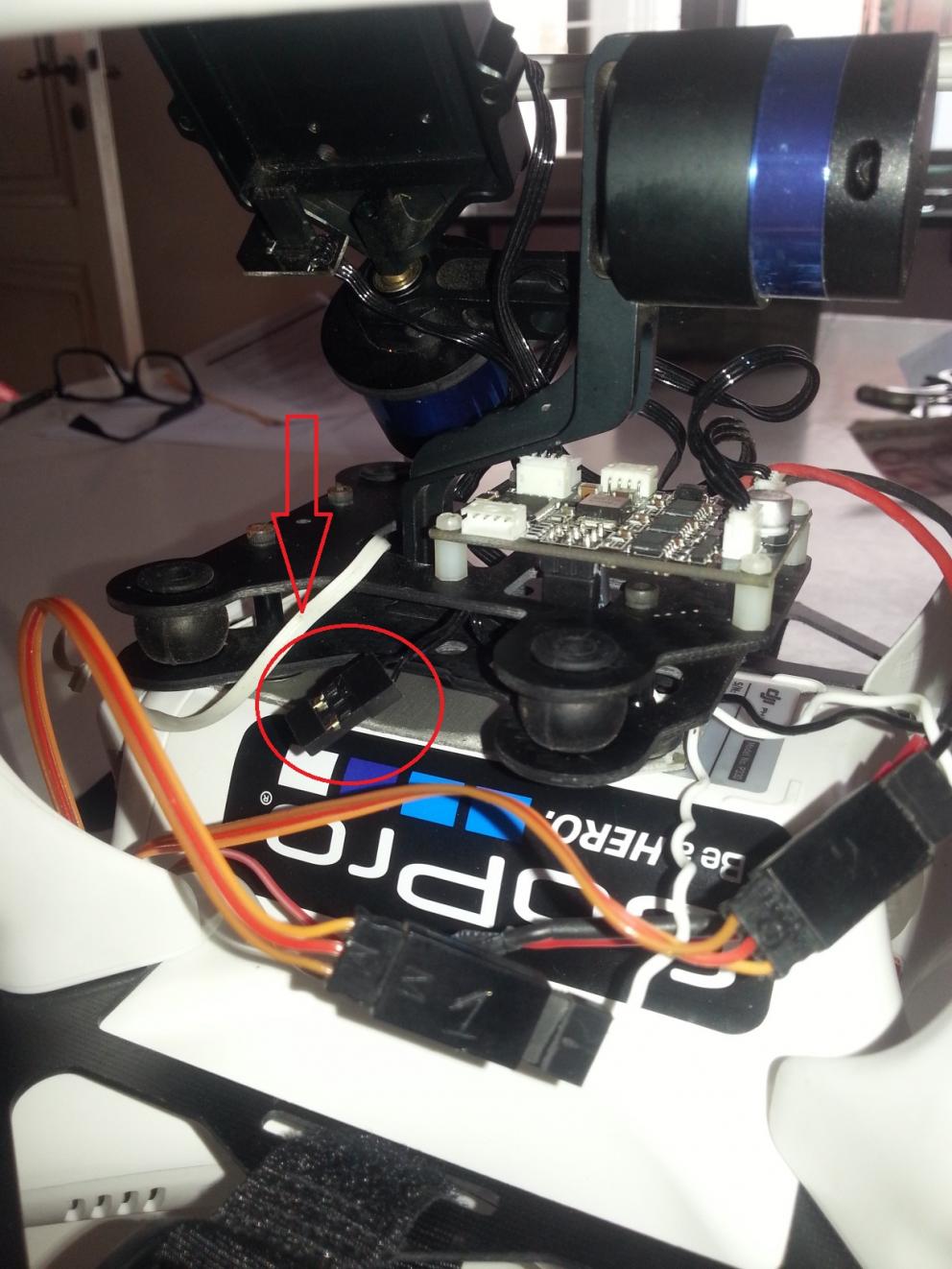

I was wondering how to get video signal on a monitor with the dji phantom and the tarot gimball.
I have one cable from my tarrot gimball : the video line.
attachment.php
How do I use this cable in a FPV setup ? Haven't got a transmitter , receiver,... yet.
I was looking at the immersionRC 5.8GHZ transmitter , but I have no idea where to begin.
[h=1]Thanks in advance ![/h]

mclolo
Thanks for the reply.
Just want to see on a monitor what my gopro is filming and I always have my phantom in sight , so I think the gimbal isn't a problem.
I already looked at the ImmersionRC 5.8ghz video transmitter , but I don't have a clue how to connect it with the video out from the tarot gimbal.
Any Idea's ? mmersionRC 5.8Ghz Audio/Video Transmitter
http://www.getfpv.com/5-8ghz-600mw-video-tx.html

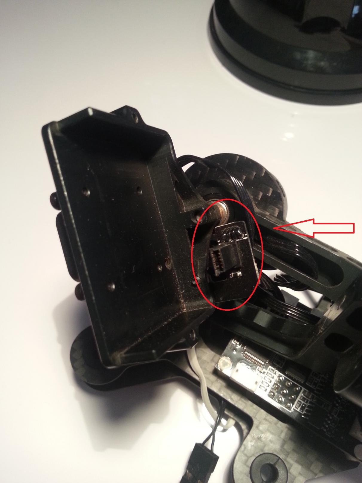

mclolo
Without the gimbal this would be great but with the gimbal this isn't possible because the gimbal is already connected in the gopro.
attachment.php
FlyGirl
Hmmmm Interesting.... Mine didn't come with that and was something extra I had to purchase at the time (I didn't). Is that for recharging the GoPro? Maybe that is one of the differences between V1 and V2? (I have the V2 plastic frame)
mclolo
I tought it was standard , I bought the phantom second hand. I removed it and the gimball works like it should ! So yes it's just for recharging the gopro. So now I can buy the cable to connect the gopro to the immersion RC.
Thanks a lot FlyGirl !!!
