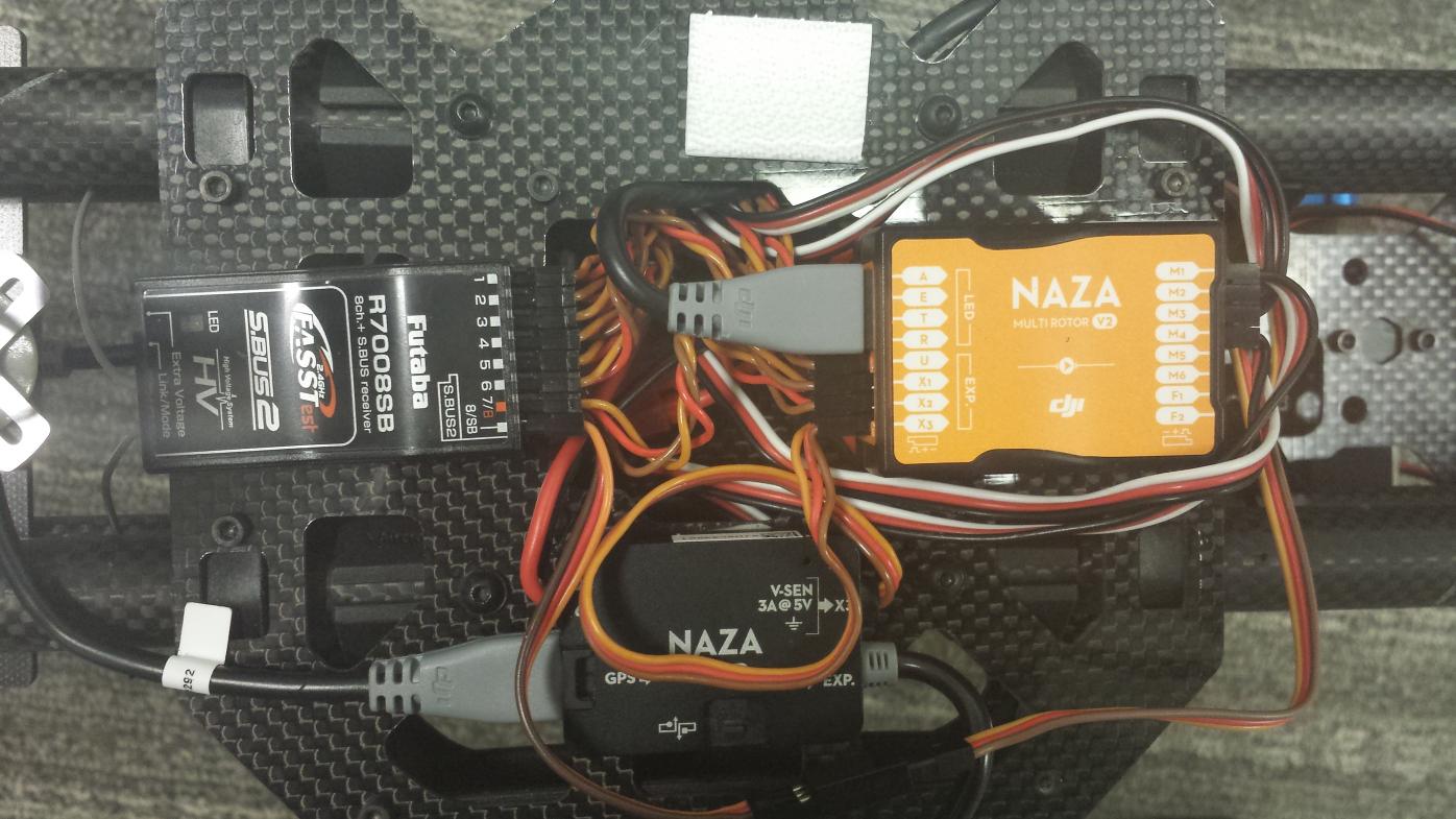

See attached, I'm guessing mine isn't SBUS but a typical reciever connection. How could i use the open 8 port on the Futaba? I could find how to program the LD dial to that channel.
