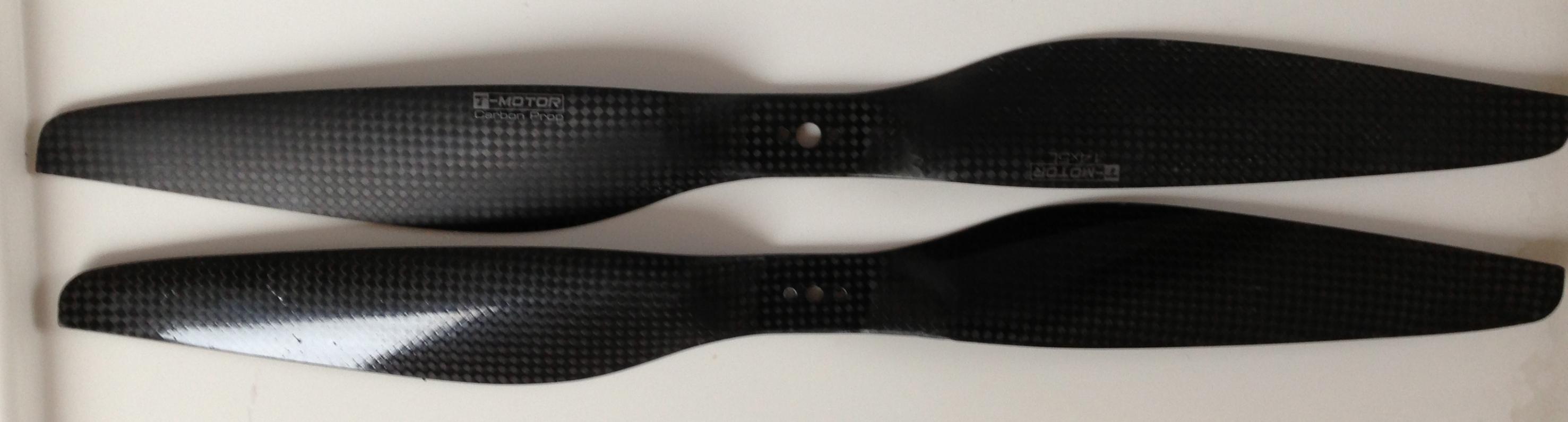

Pic 1: as we can see the clones is an extremely close match to the original. The clone is 1455, but the T-motor is 1450, but for the life of me, I cannot tell the difference. Hopefully "Hardy" won't notice either. The angle of the shot makes the clone look shorter. Its not - it's definitely 14".

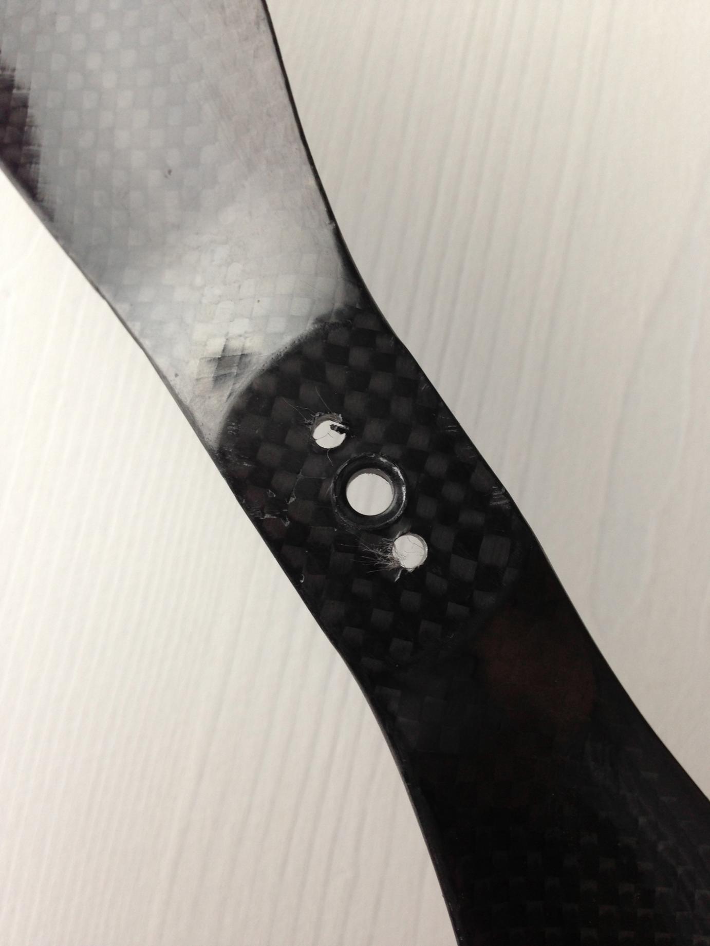

Pic 2: The clone is glossed, whereas the original is matt. You can tell the gloss adds weight, but I don't have a sensitive enough scale to prove. But in the hand, the original is lighter. The quality of CF in the original is also better, or at least the gloss has added some surface imperfections that aren't in the original. Notable is that the original's carbon weave is exactly 90' to the line of the prop. The clone is slightly squint. Personally, I like to think the original has more attention to detail and quality because of this. This could be critical in flight, where you want absolute integrity. Is squint weave a sign of weakness? Time will tell I guess. There are some horror stories in the cycling world due to clone carbon frames snapping and cracking too easily. That plays at the back of my mind, at least.

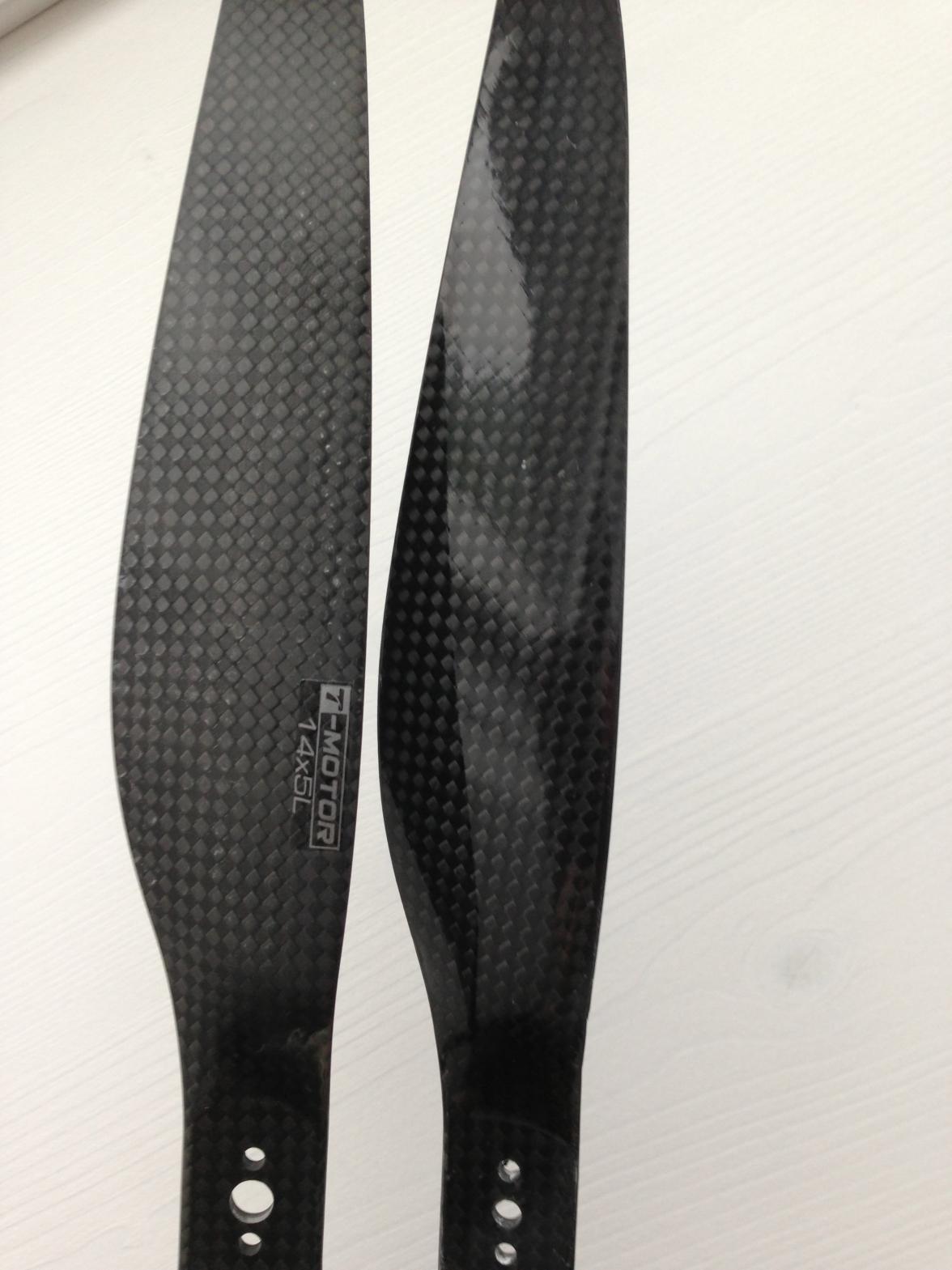

Pic 3: Do they fit? Yes they do. Very neatly in fact and you don't need the t-motor spacer ring either. However, check out that air gap on the blade bridge. That's a sign of things to come...
