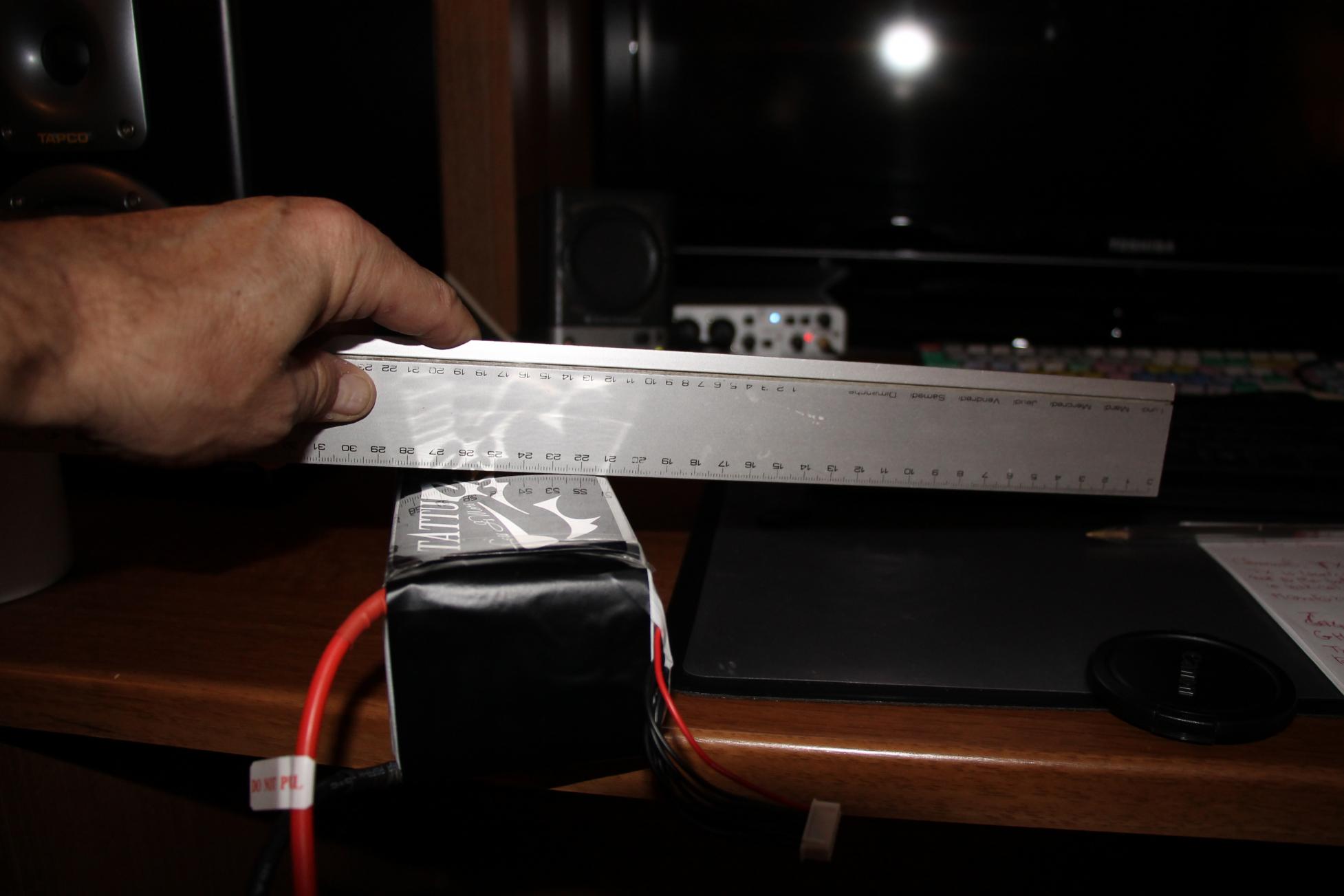

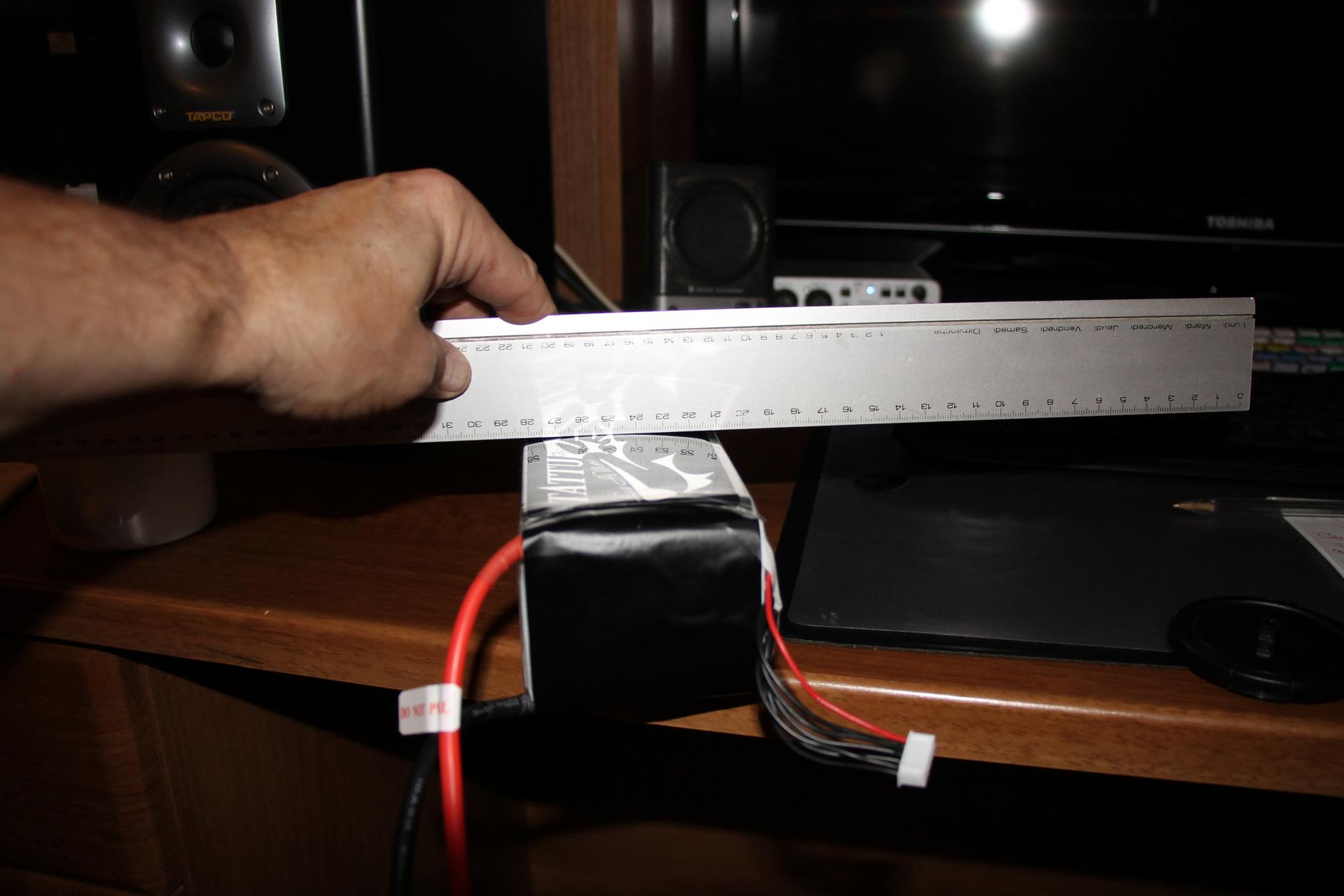

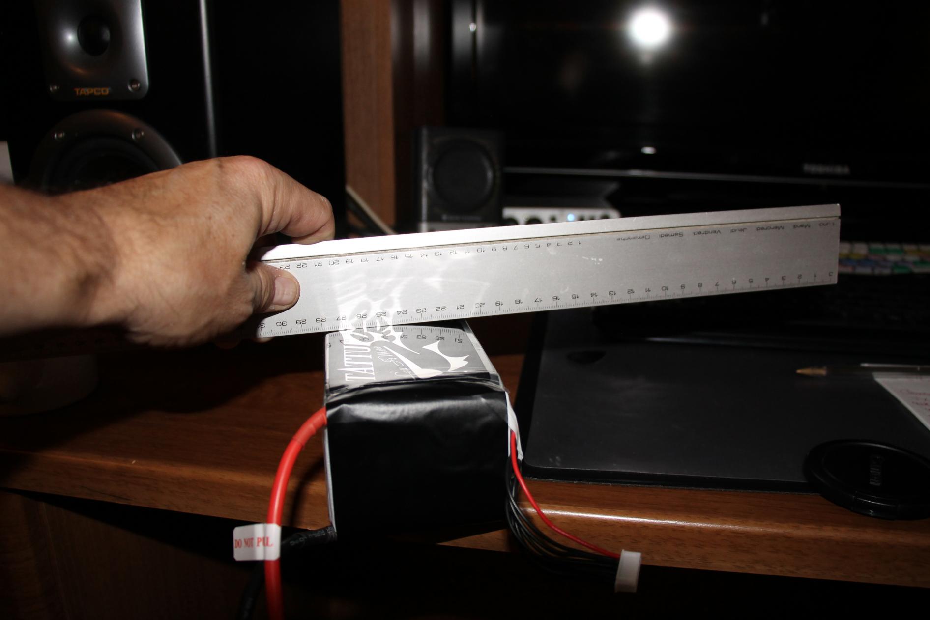

Swollen or not swollen lipo, what to do?
Stratifier
Stratifier
I doubt you can see it as it is not very obvious.I thought that the ruler speaks for itself. It should touch both of the angles and it clearly doesn't. there's maybe 4mm space where you should have zero.
I will try anyway to take these pictures you want.
Maverick

Thanks, I'm going to check this thread. @Maverick: I didn't overdischarged it, I charged it only one time, and never used so far. [MENTION=292]Av8Chuck[/MENTION]: It was not hot after charging.
I was watching the charge of the 3, and stopped it at 98%, The charge this morning after 4 days is still 97% at 24.98V, from 4.157V to 4.173V for the 6 cells.
As it is new, I think the dealer should replace it anyway, I don't feel safe with it.
Thanks.

[MENTION=4382]Rotorfreak[/MENTION]: It's solid, no air apparently.
@Ben: I don't know. I should have a look at the manual :), The charger is a Cellpro Powerlab 6.
Spoke to the supplier and they're ok to have it back, so I'm quite happy. will have a look anyway.
