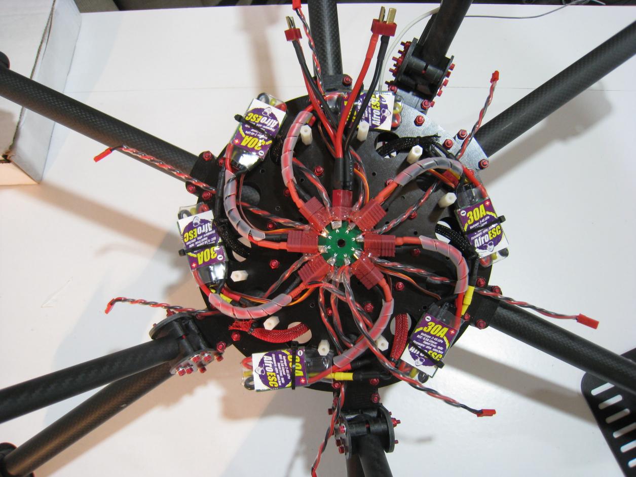

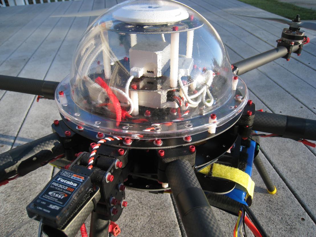

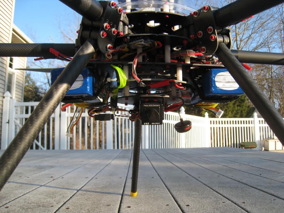

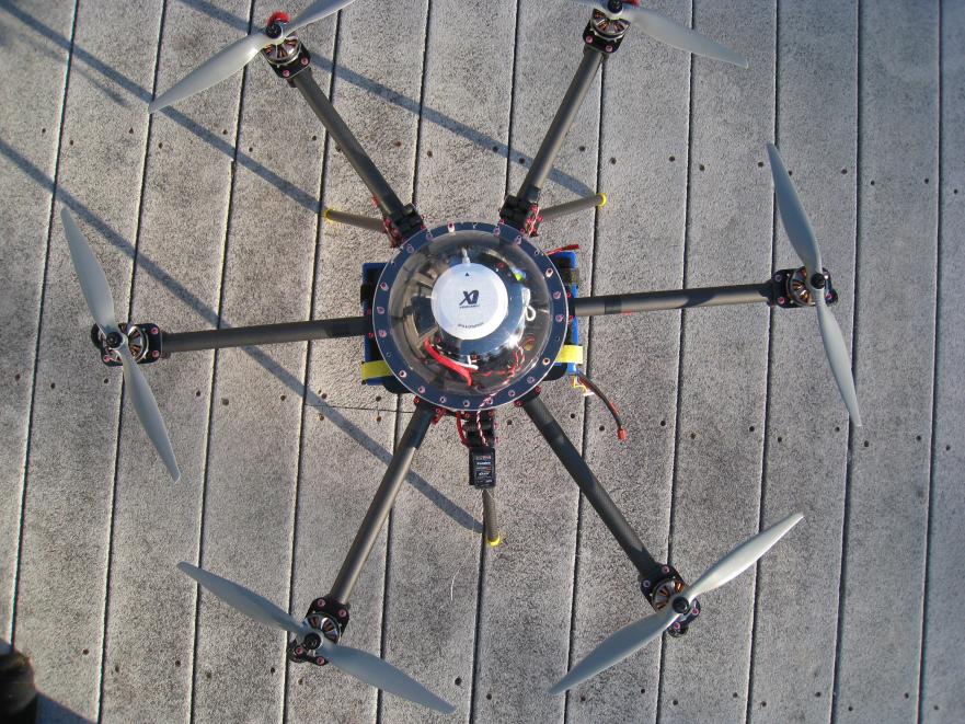

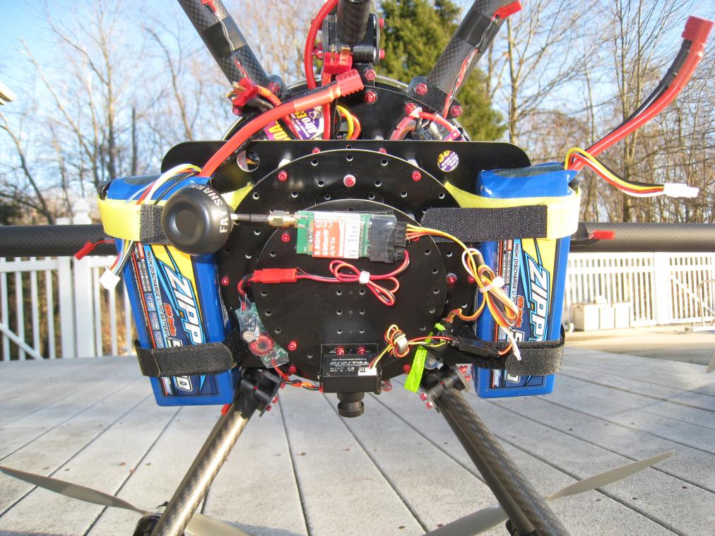

This is what I am flying with at the moment:
XAircraft SuperX flight control board
AGL Hobbies XHex UAP2 frame with 21.5mm OD carbon fiber arms
BadgerFly custom polycarbonate protection dome
AGL Hobbies tube legs landing gear set
T-Motor MT4006-13 KV 740 motors
AfroESC 30A ESCs with SimonK firmware
DYI Quad Copters Power Disk power distribution
NGH-7030-N FPV camera 5-15V DC
ImmersionRC 5.8GHz 600mV FPV transmitter with SpiroNet cloverleaf antenna
XAircraft SuperX OSD
APC 13x4 Thin Electric props
Futaba R6303SB S-Bus receiver
Dual 4S 5000mAh 25C Zippy batteries
AGL Hobbies floating camera mount with 4 soft threaded dampers
ImmersionRC DUO5800v3 5.8GHz diversity receiver
HeadPlay FPV goggles with ski mask mod
Futaba T10CHG radio transmitter
Weight without batteries: 6.2 lbs (2.8 kg)
Weight with batteries: 8.4 lbs (3.8 kg)
Flight time: approx 13 minutes
I gotta say that I REALLY LOVE the SuperX controller!! I had a chance to fly it today in the cold....and it was just pure fun!!

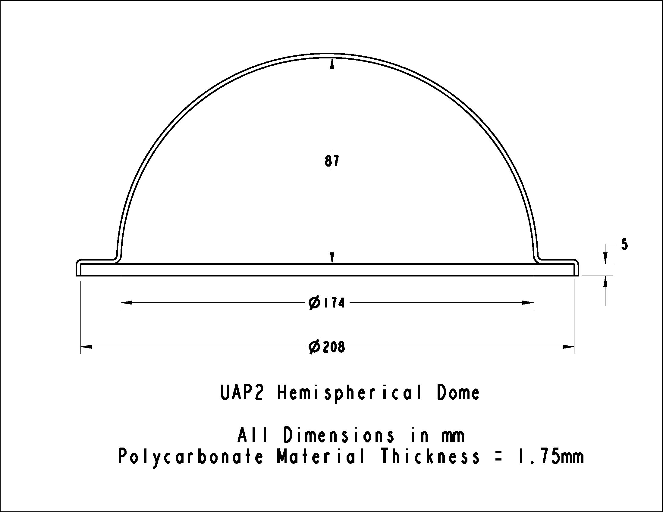

Yup! I was tired of not having any good protective dome options available, so I made myself a professional vacuum forming machine and some dome forms and starting making them myself. They are working out so well that I opened up a website (www.badgerfly.com) and now sell several sizes of really strong polycarbonate domes for multicopter use.
The one in the picture is the biggest that I make, and it is sized for Rusty's UAP2 frame.

Thanks for the pointer, but not even remotely big enough for my 1000. I'll continue my search. If you do customs, let me know, I have a former.
