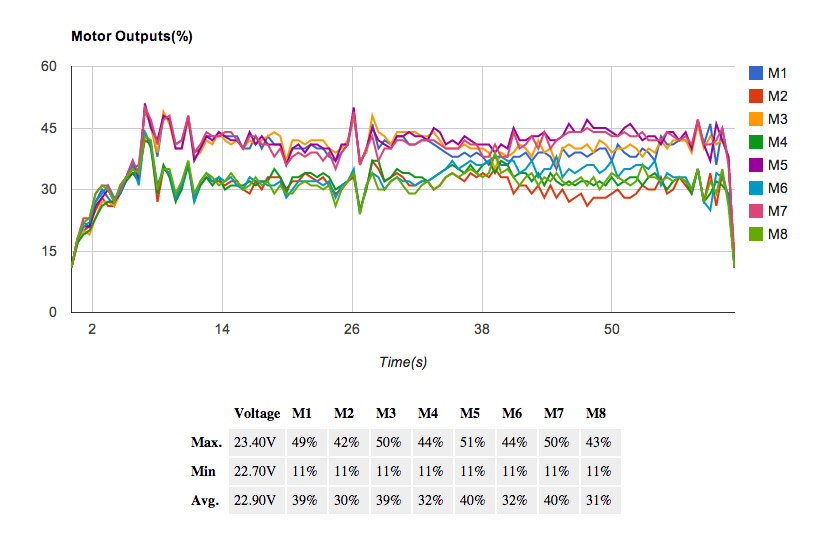

1. After my flights I checked out my flight logs and all looks pretty much as expected except for my motor outputs. All the odd motors (1, 3, 5 and 7) were running at about 10% higher output on all flights. The octo was totally stable pretty much all the time though except when I was adjusting the gain knob. In this post - http://goo.gl/XRXgxe - a guy crashed his drone with SuperX installed and based on Jingchen's feedback his M2/M4 were running higher which indicated misalignment. I checked before I flew and double checked since seeing the logs and I definitely have all my motors mounted perfectly level and at the same distance from the copter's axis. Each motor is running either a clockwise or anticlockwise APM 14 x 4.7. Any ideas on what could be causing this difference in motor outputs?
2. What is a reasonable amount of vibration to expect from a well balanced octo? On my logs, the vibration levels peak at about 0.8g which seems high.
1) I have noticed that some props have different efficiency on the clockwise and counterclockwise blades. It is either that or you have one or more motors that are not level
2) I can usually get my vibrations down to around .3 with the occasional spike, but less than .5 seems to be acceptable.
3) It tells you the rate at which the copter is changing angles. It is essentially a measure of stability. The higher the angle rate the faster the copter is pitching or rolling. This number may look high when hovering especially because the FC is constantly changing the angle to keep it level.

Hello Drew,
Thanks a lot for the response. I think it may have been that an engine or two was not perfectly level. I'd done them all with a spirit level, but I reset all the arms and that seemed to solve the problem.
Thanks for the info on the rest of my questions as well. I've also just finished rebalancing the props and my vibration is down to between .2 and .4. So, happy with that. I'll remove those positive cables.
