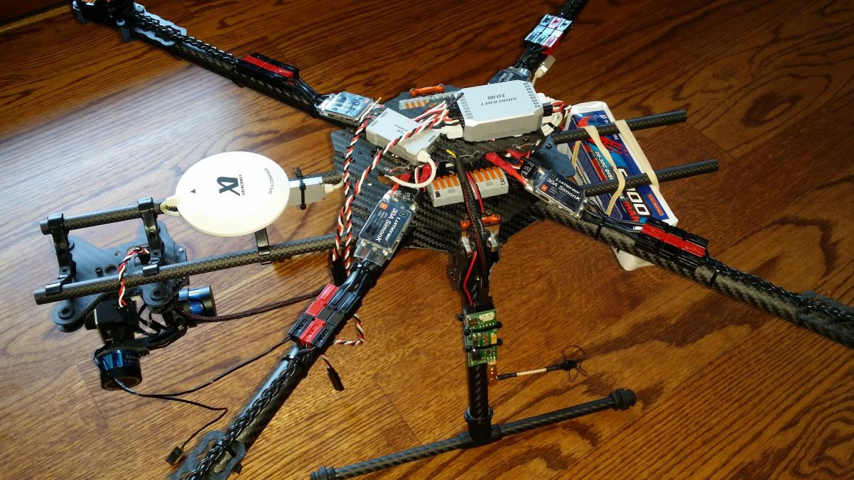

I flew this Aircraft before, without the Gimbal and the Battery was mounted on top of the I/O unit, on top of the Aircraft. It was on a calm day, the Aircraft was balanced perfectly and everything went very smooth... On the attached picture, you can see how I pretty much flew today. The only difference was, that I moved the GPS forward, behind the gimbal, and the battery further back...

I took a look at the photo of your copter, and I am amazed that you could fly it at all with a rubber band holding the LiPo in place. It's easy to imagine that the battery was bouncing around a little on its booms, causing some serious movement being translated to the flight controller, which in turn would cause it to try and correct, which could create a feedback loop. If the rubber bands holding the battery were, in fact, still intact, I'd be shocked. But if that was the case, I'd still vote for that being a serious contender for your smoking gun.
My other concern is the length of CF boom holding your camera gimbal. That can also introduce vibrations and oscillations back to the centre hub which can cause problems for the flight control.
Lastly, what is holding the SuperX flight controller onto the frame?

I flew it in the garage fine. The vibrations were very low. The Log of the SuperX, also confirms that the vibes were very low. I also fly planes and we use those rubber bands, to secure the wing to the frame. At least we did back in the days, ha ha. Anyhow, I have also seen other have the gimbal on a boom like that. Maybe not that far out. What I should have done is, wait till the proper battery mount is here, which it is now, and do a "real" flight outside and not just hove in the garage. Lesson learned on many levels! The SuperX was mounted underneath the bottom frame plate with Servo Gel Tape...
