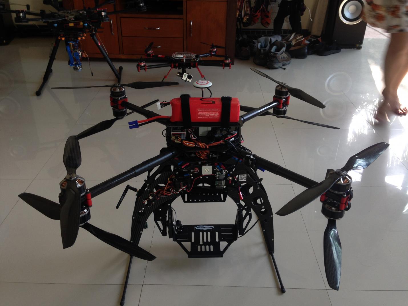

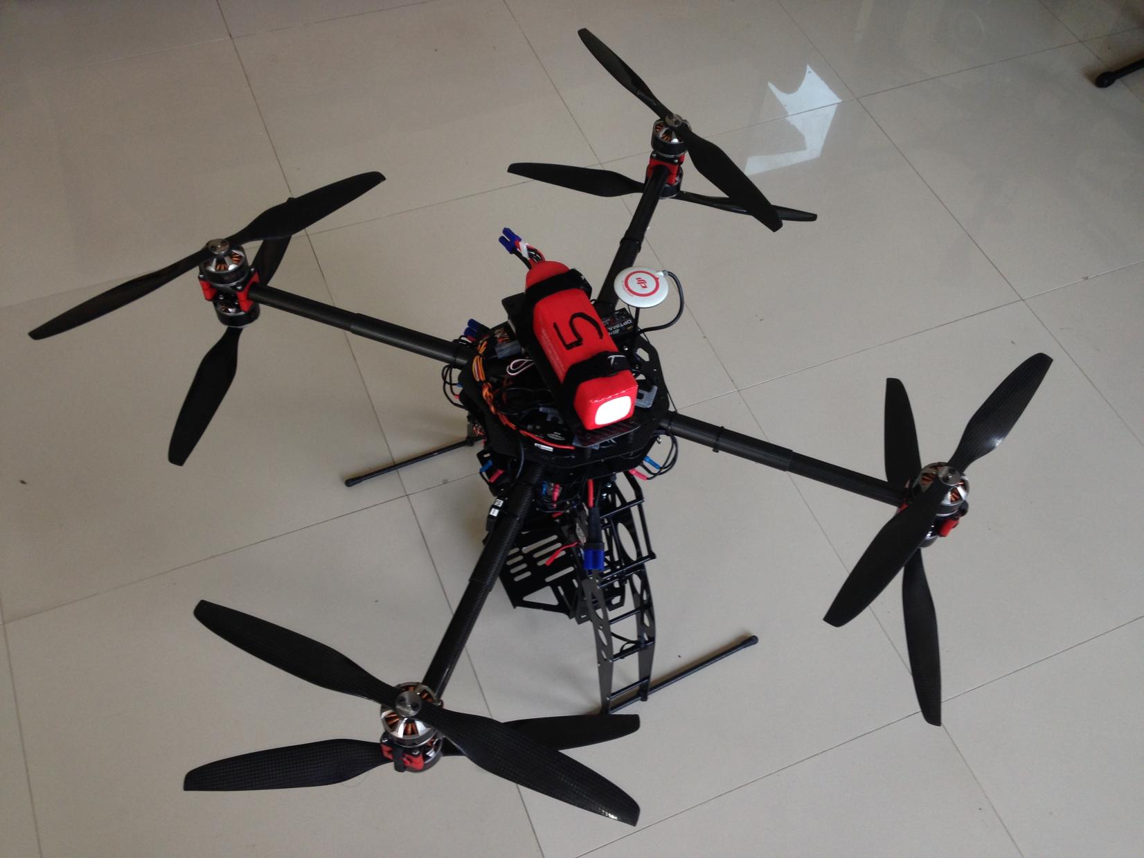

Hi Kopterworx ,
I figure you are the renowned experts on co-axial 8's Pleeese can you help ? I have an X8 which is very wobbly, there is something wrong with the combination of parts or set up but I can't find it. It is best with the APC's less good with the carbon 15 x 5.5's and really bad with the 16 x 5 wood props.
I have done all the obvious things ( I think !) I have tried the gains all over but nothing helps , checked the configuration etc , calibrated compass .. it flies the same in atto mode and GPS , it does not seem to help adding weight to the mount. It flies ok in still air but cannot handle ANY slight wind without wobbling badly !
Flying weight is 5.1 kgs
Wookong M (latest firmware)
Tiger motors MN 4014-9
Tiger motor 40 a ESC's
6200 6s x1
APC 14 x 4.7 props , DJI carbon 15 x 5.5 .
motor to motor 750mm
AV 200 mount
If you have any ideas I would be very grateful.
Regards Nick
PS I designed the QuadH2o , I hope yours are still going well !
