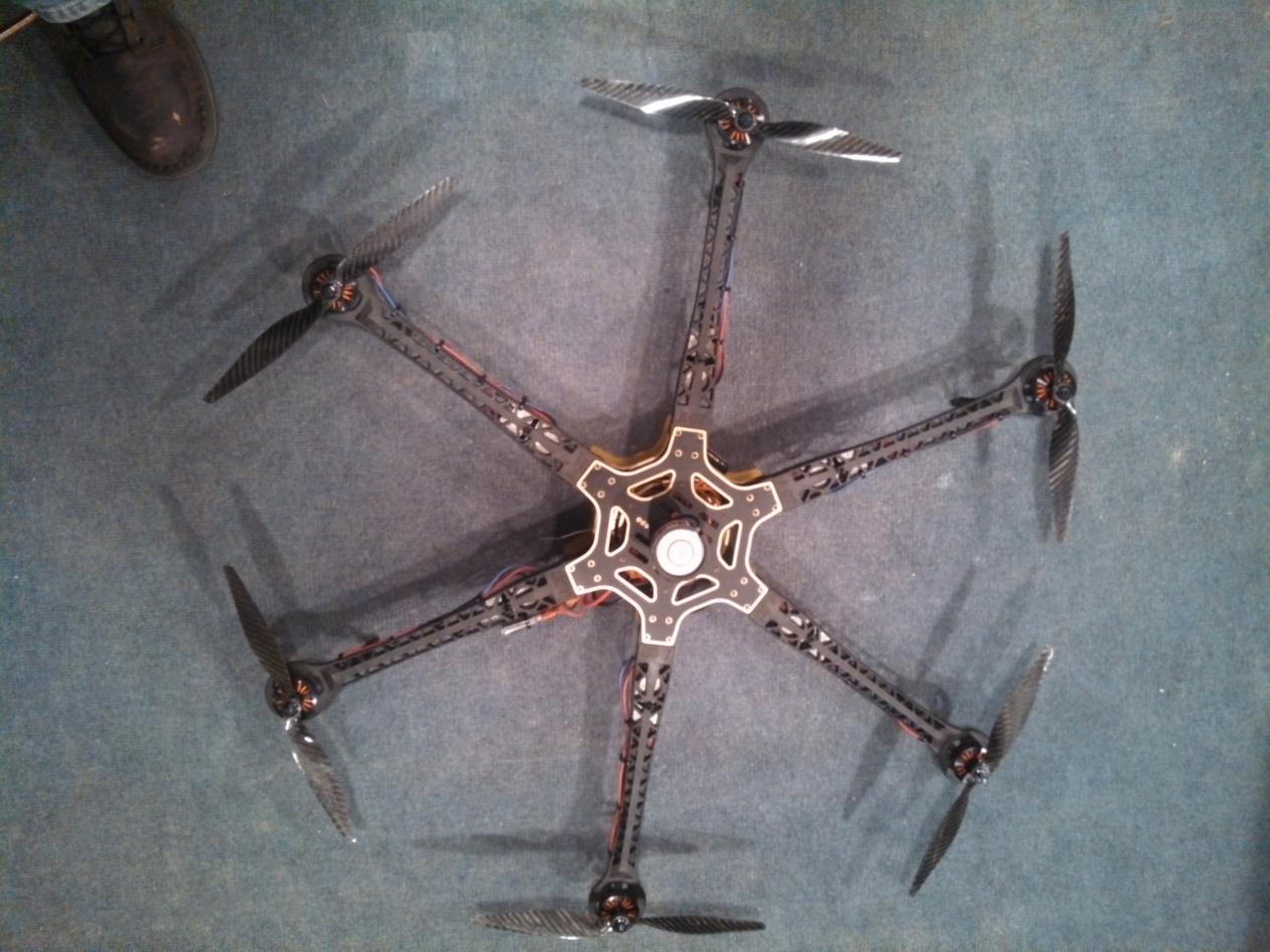

Started out with a spider 450 and moved up to a rct800 ,4215/650kv motors and figured I would try 12" cf props with a 3s /5000 for power . Naza ,with gps
well after 4 min flight time I had to try something else , I ordered 15"cf props and waited , View attachment 9962

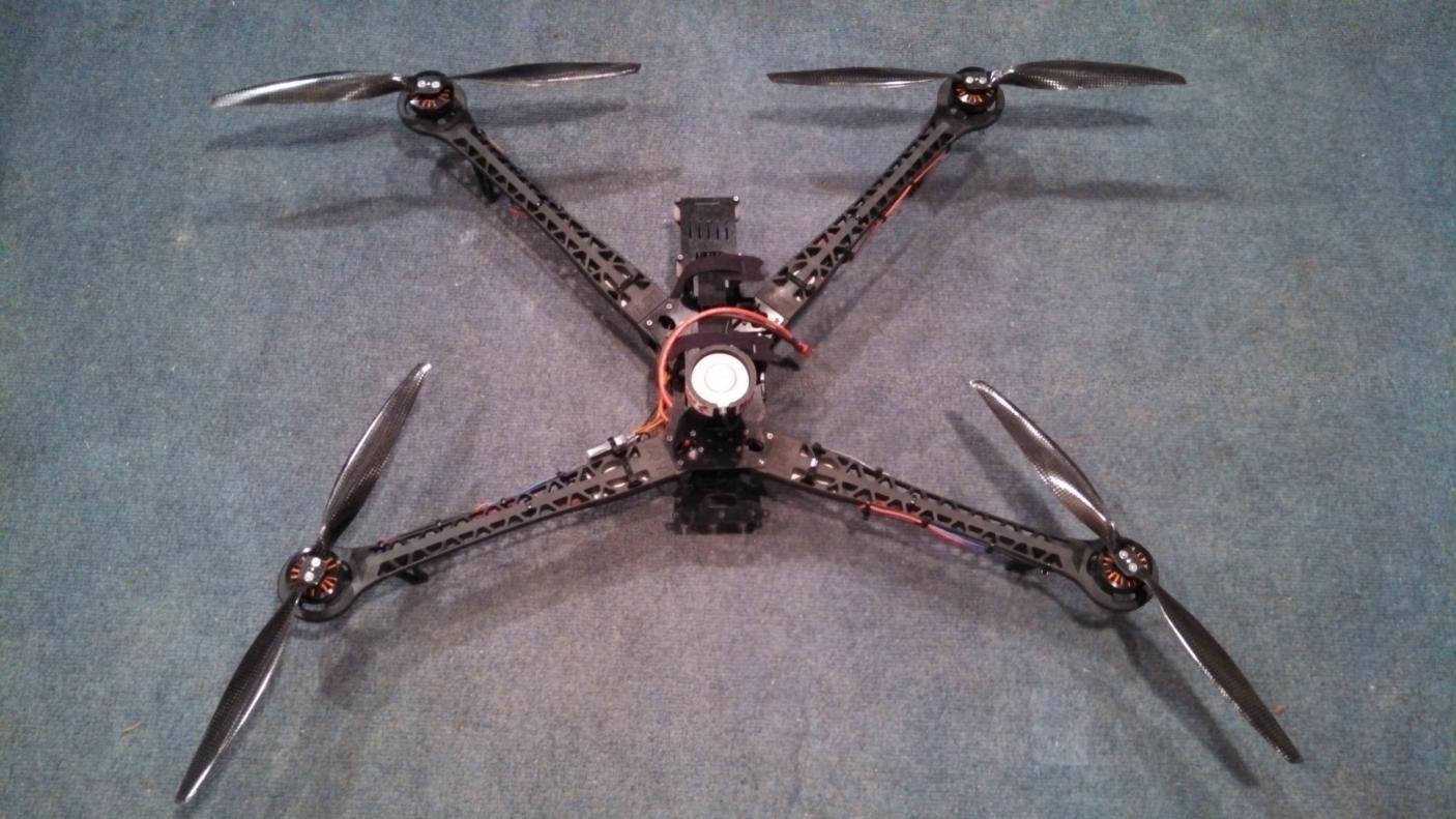

Then I figured I would try the arms on my 450 spider frame , 2 less motors and less weight got me an extra 3 min. flight time , but it was very sluggish reacting ,so still waiting on
my new props .View attachment 9963and new props did the trick ! 11 -12 min flight time and boy does it move !
next is to move up to a 4s battery,
