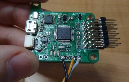

So I've been working on a small board for Tau Labs called Sparky, which I wanted to share.
The goal was a small single sided board that was relatively easy to hand assemble. It has a gyro / accel / mag / baro and does altitude hold, position hold, rth, etc.

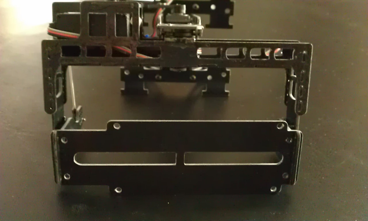

There is also an add-on board for it which lets it drive a brushless gimbal. I took it out on the beach today and got some (I think) pretty nice video.
Since this was sailing weather, obviously the wind was quite choppy. There is a scene in there which compares two go pros - one on the gimbal and one fixed (for FPV) so you can see how much small movement it was suppressing. Sparky (and the other Tau Labs targets) can also output a mavlink stream which can be fed into a mimimosd, which you can see above. I've also tested it on a larger gimbal from AGLHobbies with a Sony HX9V, although that needs more tuning

Nice to see you getting involved with the Brushless craze. Looks like with the small board you have the IMU integral?
Yeah, it's integrated. Actually it doesn't have to be - the driver board is designed as a separate board but it solders on the back of Sparky to appear like one board.
I have the gimbal controller talking to the flight controller now, so it can use a brushless gimbal controller to fix on certain coordinates. Basically it takes the current GPS coordinates and the desired fix location and calculates the bearing and declination to the target. The bearing sets the quad's yaw and the declination the camera pitch. Initial testing worked fairly well.

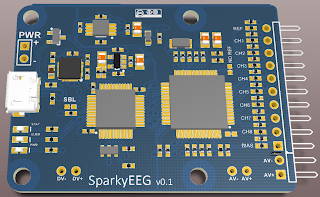

after you master this we'll need sensors in the brain (heading upstream of the thumbs in the control process) to grab the next big performance improvement.
I'm already working on [video]http://buildandcrash.blogspot.com/2013/12/eeg-design-time-for-something-totally.html[/video]
