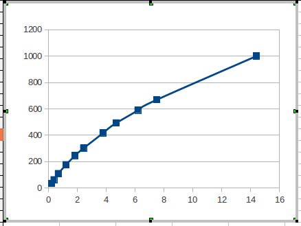

OK I just tested a couple of Thumper V2 2836-11 motors on 3S with 13X6.5 props with the following results.
Full throttle single motor 14.5 AMPs with almost exactly 1000g of thrust.
when i ran 2 motors bolted one above the other one with a pusher I still was getting 1900g of thrust at full throttle which surprised me.
what surprised me even more was that on measuring the current to each individual motor they are still drawing aprox 15 amps each.
1. I expected them to be sharing the workload of pushing the air and for it to not be anywhere near 2000g of thrust
2. I therefore expected the current of both motors to be less than when run individually
3. I expected the motor downstream of the airflow to be pulling considerably less amps than the other
any comments or discussion points welcome
how does this motor / prop setup sound for a Y6 copter ie 3 times this tested setup.
I did a plot of current vs thrust for a single motor - things was getting a bit hairy to do it with the 2 but i may try again tomorrow, if i can get my son to volunteer to help me, but this was the plot i got for the single motor - (does it seem an acceptable setup for multi rotor use)

One thing i noticed was that the stator was getting quite hot (no smell of melting enamel) but definately hotter than I had hoped for. this was especially surprising seing as i was only drawing 14/15 amps (150 watts) - this motor is supposed to be able to dish out up to 300W (but i gues only in a moving plane with fast airflow)
Ive decided to switch the plastic motor mounts i had planned to use on my multi rotor for some aluminium ones, that way the whole aluminium arm of my planned Y6 ship will become a very effective heatsink.

That looks like way too much prop for a 70g motor. eCalc list the max wattage at "100W for 20 seconds" for the RCTimer 2836-11. There's no mystery to this: the ability to dissipate heat is closely tied to the total mass of the motor, and 70g is a baby! Mounting it on an aluminium plate will help some, for sure (see the Droidworx mounts) - but you're still basically over-driving the motor. If Overlander told you it can handle 300W then they are being dishonest (or naive)! Remember that a brushless motor "sees" all the voltage and a high proportion of the maximum current even at partial throttle settings, so staying strictly within the (honest) ratings is essential for longevity.
