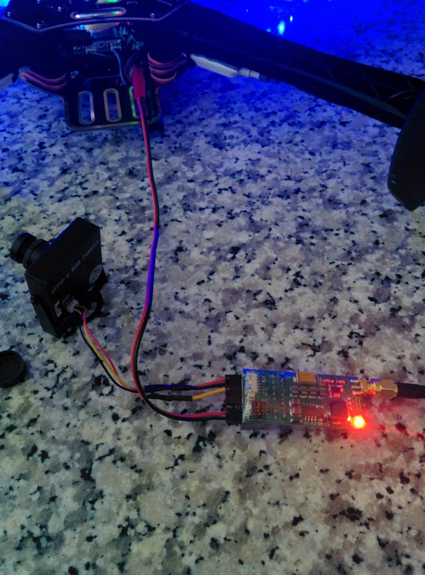

I did some further testing when I got home this afternoon, and it appears that my Goggles are defective...
Here are some pics of my setup, and what I see once I power on the Immersion TX on the correct channel, with AV out from the goggles. This is exactly what it looks like in the goggles as well. If I change channels or power off the TX, I Get the standard fly race static, but the built in camera is fine. :-(
Can anyone suggest some wires I can check internally, or an LCD driver part that may need to be replaced?

cootertwo
The camera, not the TX. The way you have it wired, should work, with a 5 volt camera. If the camera your using is 12 volt, you'll have to supply it with power from a 3c battery. I ran into the same problem with the first 12 volt camera I had.
The 5-15v spec was said to be for my camera, not TX; however, I will definitely check that out!
StonedLlama
Spinny Side Up
OK, sorry, but it sounded just like what I went through with my first 12 volt camera, white screen and all.
I should know better than to question those with experience by now...
You were on the money, it just needed some more power. I am running it off my 4s at about 16v which is working just fine!
Thank you, Cootertwo! It is FPV time!
