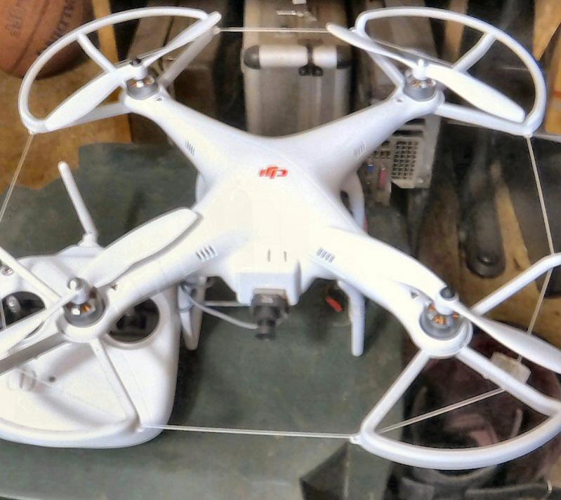

cootertwo
Hi Bart. I just got trying my new setup. Took one of the 600 TVL cameras, (one with no bracket), took the 2 little screws out, and replaced with 2 long threaded machine screws. Drilled 2 holes through the battery door of my Phanton, and mounted the camera on the battery door. Had to put a piece of fuel tubing under the top, to tilt it down a bit. Flew a battery pack around in my back yard. Very happy. Even flew out over, and behind my barn, never lost signal. I also have an IBcrazy helical antenna, I'll try on the goggles when I try it in the wide open. The score is: Fat Shark Attitudes +1 Skyzones -1
