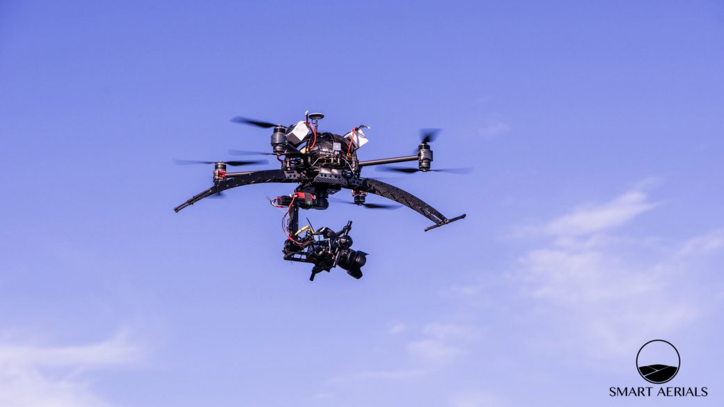

Hi all,
It's now been 6 months since the Skyjib X4 came in to bizz.
I've been successfully flying it with a gremsy H6 and Canon 5DMarkIII / Sony A7 etc, AUW up to 11,5kg for around 7 min with 2x8000 6s batts.
I have recently been in touch with some of the bigger companies and planing to make an upgrade that can handle an Alexa mini or RED Dragon.

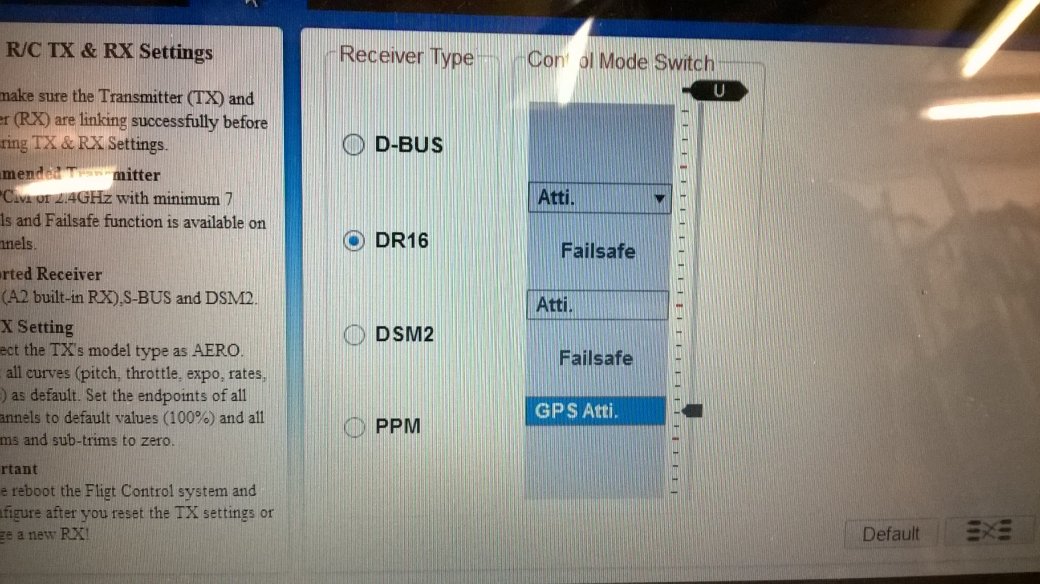

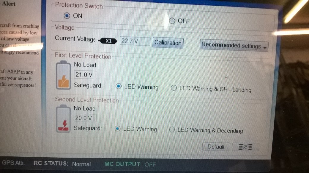

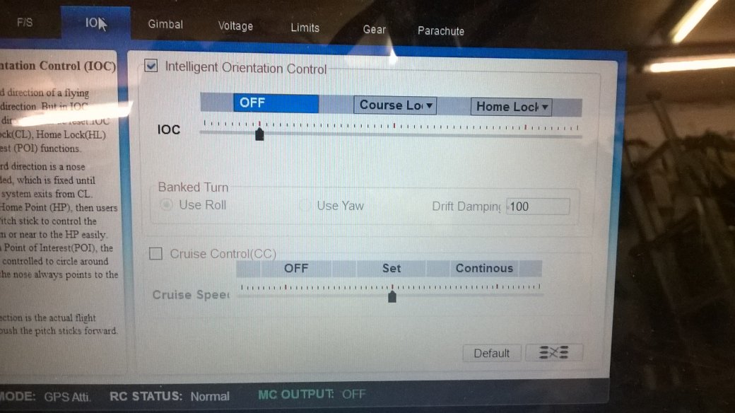

These are my current A2 settings as requested.

Hi Adrian. I might be wrong here but your settings look wrong. Firstly there is not offset for either the GPS or IMU. You would expect at least a 1cm difference in the Z axis unless you have merged them into one unit! Also those gains look very low which can be a dangerous thing in certain conditions. I have built all sorts of rigs and 150 for pitch and roll is the lowest I have gone. My current rig which is using 18 inch props on KDE 5215s is set at 190 (although you would expect higher gains for the larger power train).

I bought this RTF from a Uk agent and it flys fine. However I will go through in fine detail the settings now you have brought this to my attention before flying again. Safety first always. The other same outfit I fly has the WKM flight controller and the gain settings are much higher but cannot remember the precice figures so will check these tomorrow at work.

Quite shocked to find the GPS location settings were not entered correctly. The IMU settings are ok (dead centre). I just don't know why I did not see this sooner. I will be speaking on the phone to the UK builder / supplier in London tomorrow about this. Once again thanks for the heads up although it has been flying brilliantly so far which indicates the A2 settings are not as critical as they are made out to be. but it must have been working overtime to compensate. Regarding the gains I am going to increase the basic gains from 100 to 130 and see what it flys like and then keep increasing these by 10 ish until it shows over compensation and then back them off. With the Attitude gains which are at 100. I believe these function like expos and will lower these to give it a more softer feel on the sticks. And then keep tweaking until I am happy.
