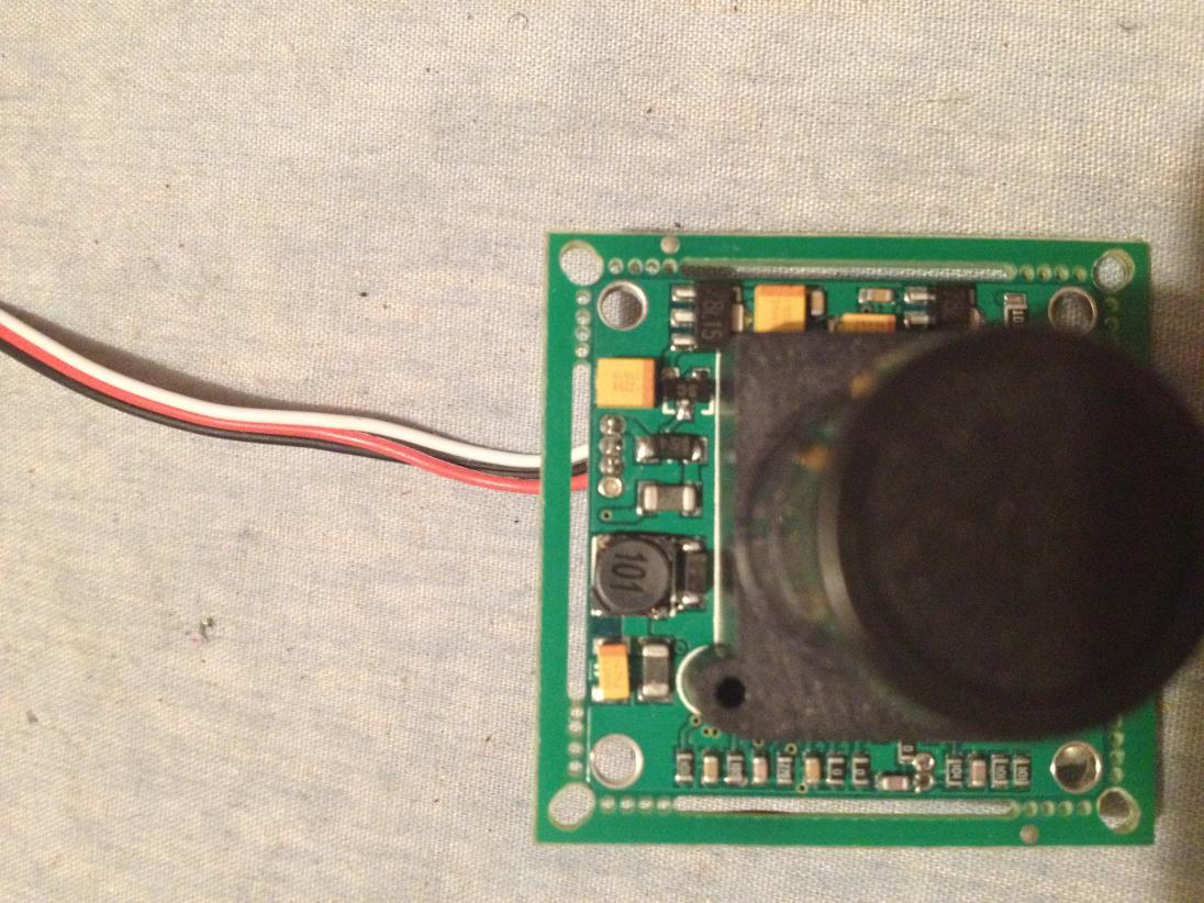

Hi DKTek, is it the same TRACO`s and ELKO as this ?
View attachment 3636View attachment 3637
DKTek
Yes, that is exactly my current set up....with a little less gel under the pressure sensor, ;-)). Although I can't read the number on the servo power TRACO, I'm using 6.5 volts.

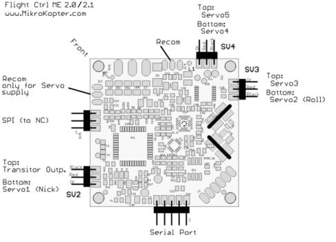

The Servo TRACO is also a TSR 1-2450, but I will use a seperat gimbal power supply anyway (7volt), so you will be using the TSR b1-2465 ?

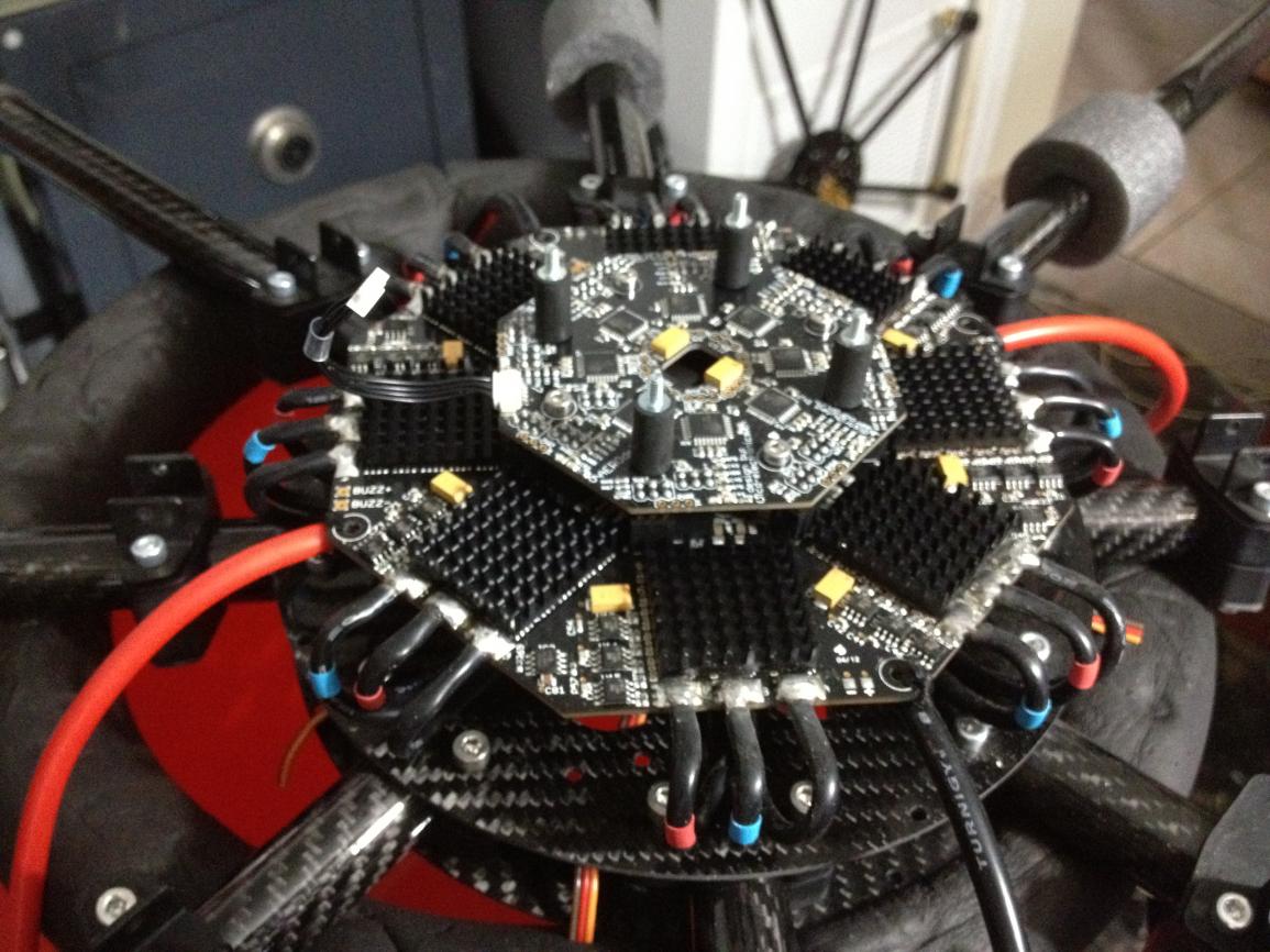

Today, I pulled the stack apart and re-flowed the solder on the FC TRACO's. I also looked for anything out of place such as solder balls, typical of boards not cleaned after assembly.

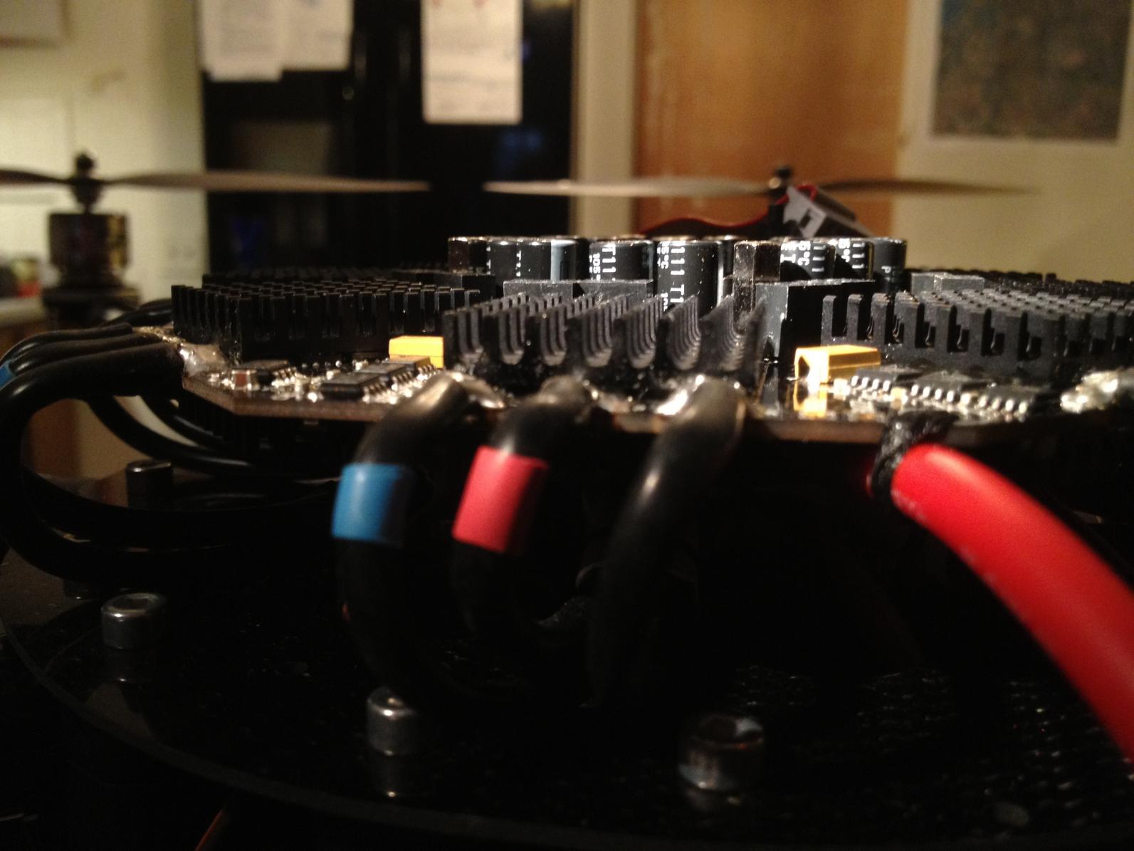

I also pulled the top board from the AEROdrive 8 and shimmed the metal spacers with 1mm nylon washers. Reason is the board was resting on top of the CAPS... Look at the standoff height compared to the caps.
Also note that there were a couple of solder balls on the lower board as well, probably from when they soldered the 8mm power wires. What is different today is the motors didn't do the ramp up to idle as it did yesterday.
After many power cycles on the bench, Toolz being monitored, followed with manual tilting in PITCH and ROLL again while at idle, the SJ8 seemed to respond correctly in PITCH...finally! I disconnected every thing and took it outside for another test. Back to the same old thing again, minus the RPM ramp up. So now things seem to be intermittent, much worse. Maybe tomorrow I will give in and swap the FC which should rule out one of them, the FC or the AeroDrive 8.

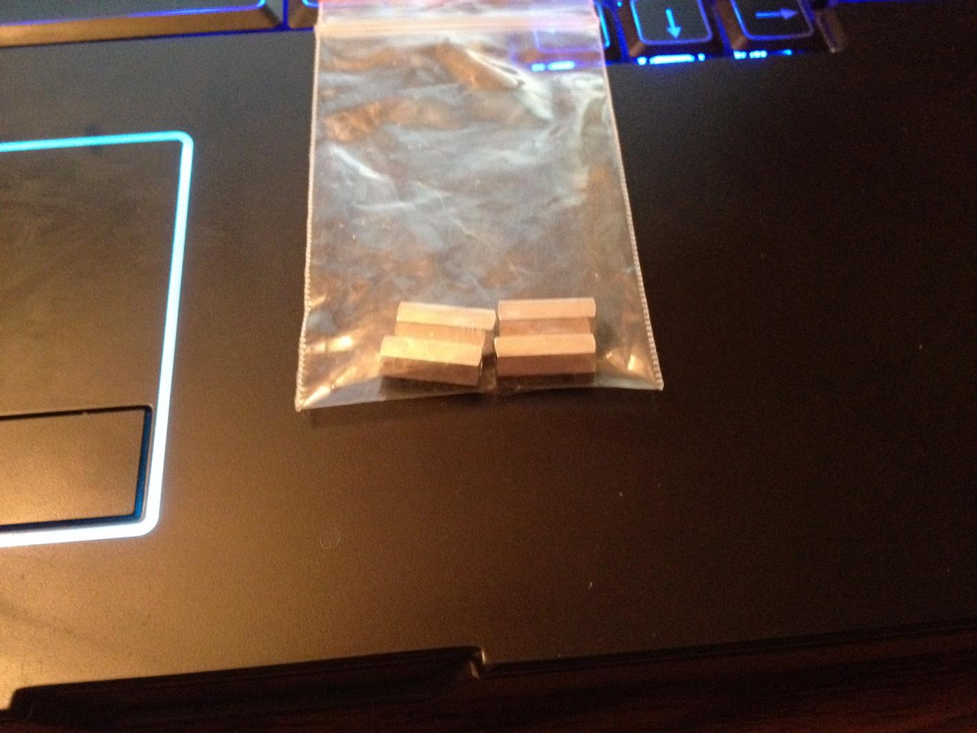

Now, talking about customer service. Yesterday I shimmed my speed controller and today these showed up, THANKS guys.
That's customer service!
