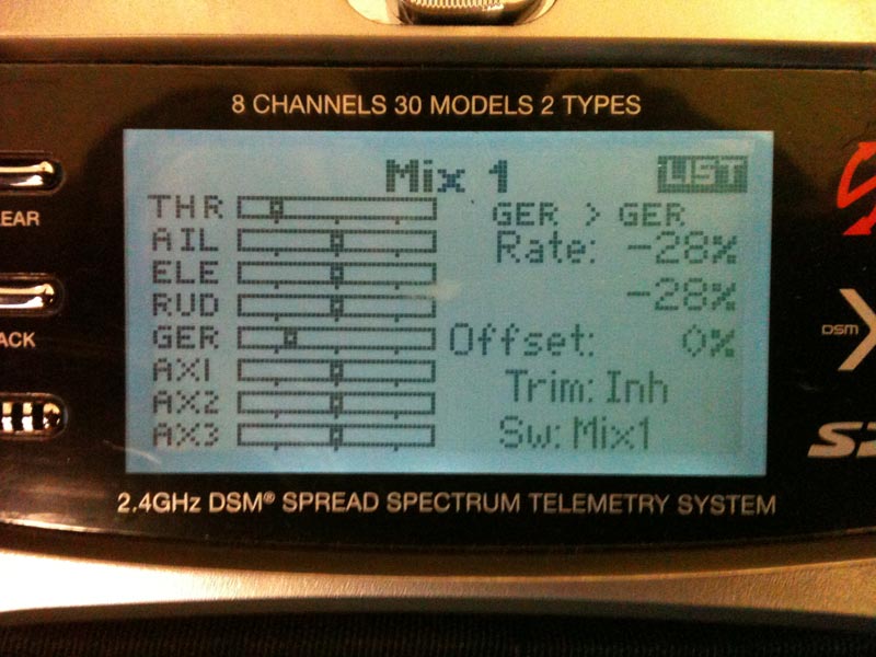

I read the DX8i manual once again, this time knowing what I was looking for, and found the answer. I followed the procedure to enable "Preset Failsafe" and bound the receiver to the transmitter with the throttle at 0, the sticks otherwise centered, and all of the switches off EXCEPT for the HOLD switch which was flipped up (on). As I mentioned above, I assigned a mix to the hold switch that puts the NAZA into failsafe. (which I have assigned to make the NAZA go into its failsafe mode). This works perfectly.
At any time, regardless of ATTI or Manual mode, and regardless of F-Mode, and regardless of whatever I'm doing with the sticks or other switches, the NAZA goes into failsafe as soon as the HOLD switch is flipped.
Likewise, regardless of ATTI or Manual mode, and regardless of F-Mode or anything else, if the receiver loses connection (ie: I turn the transmitter off), the NAZA goes into failsafe.

Sweet thanks will, how do i set a mix to operate failsafe on hold switch i like that because naturally flip hold when the heli gets outa control

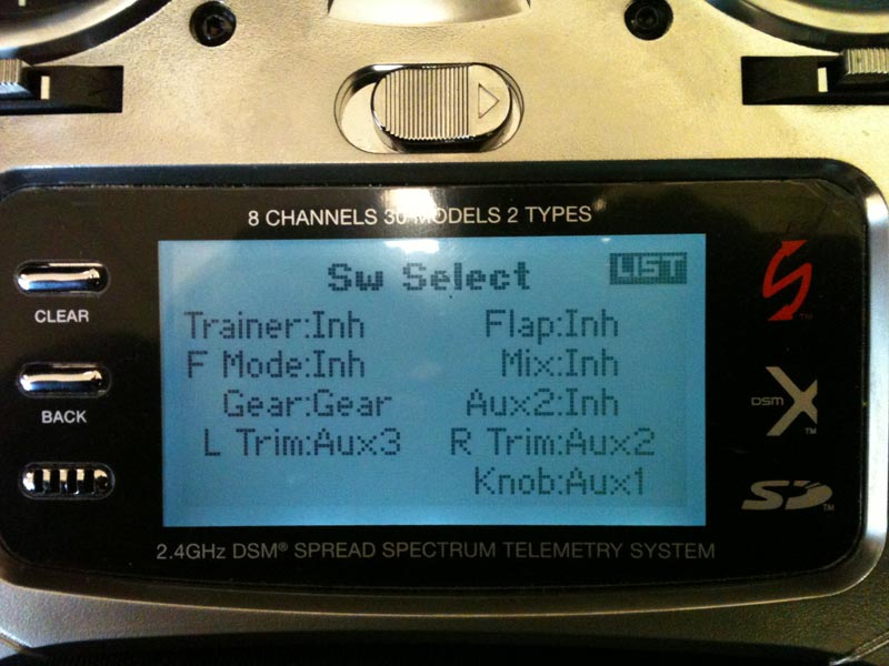

Switch Setup:
attachment.php
MIX to control Failsafe:
attachment.php
View attachment 2810View attachment 2811View attachment 2812
