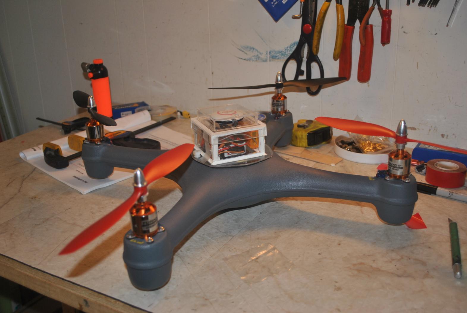

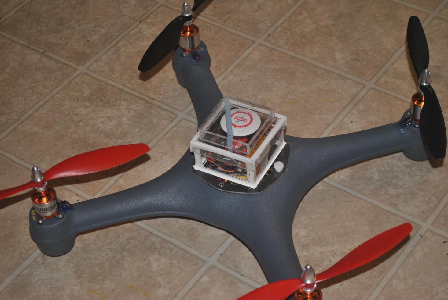

RTF Aquacopter with Naza Lite
Status
Not open for further replies.
HK 2836 motors with Gemfan 1045 props
Q Brain 20

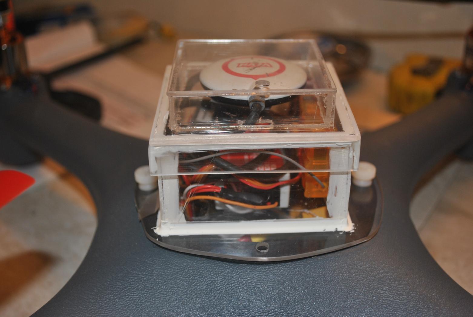

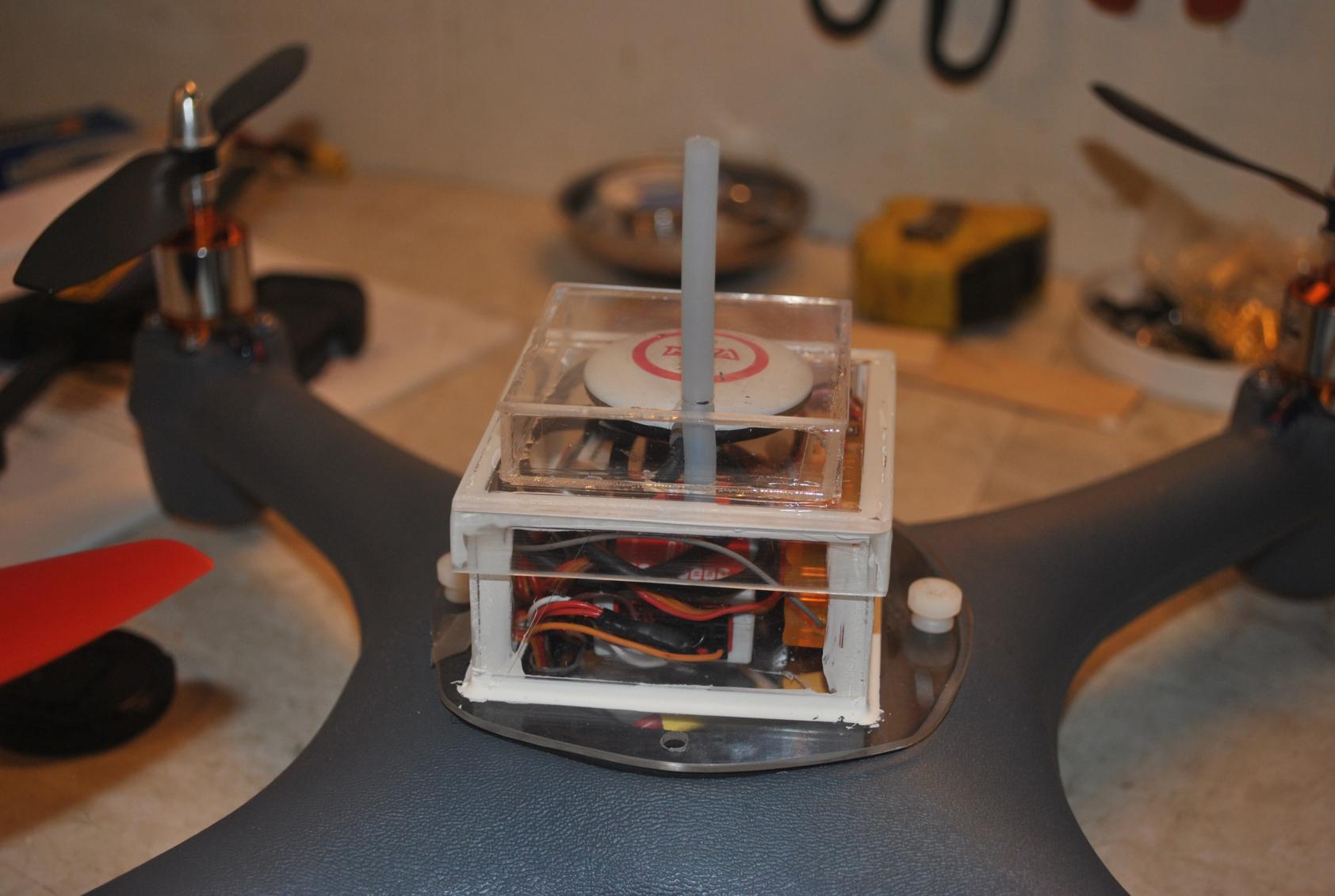

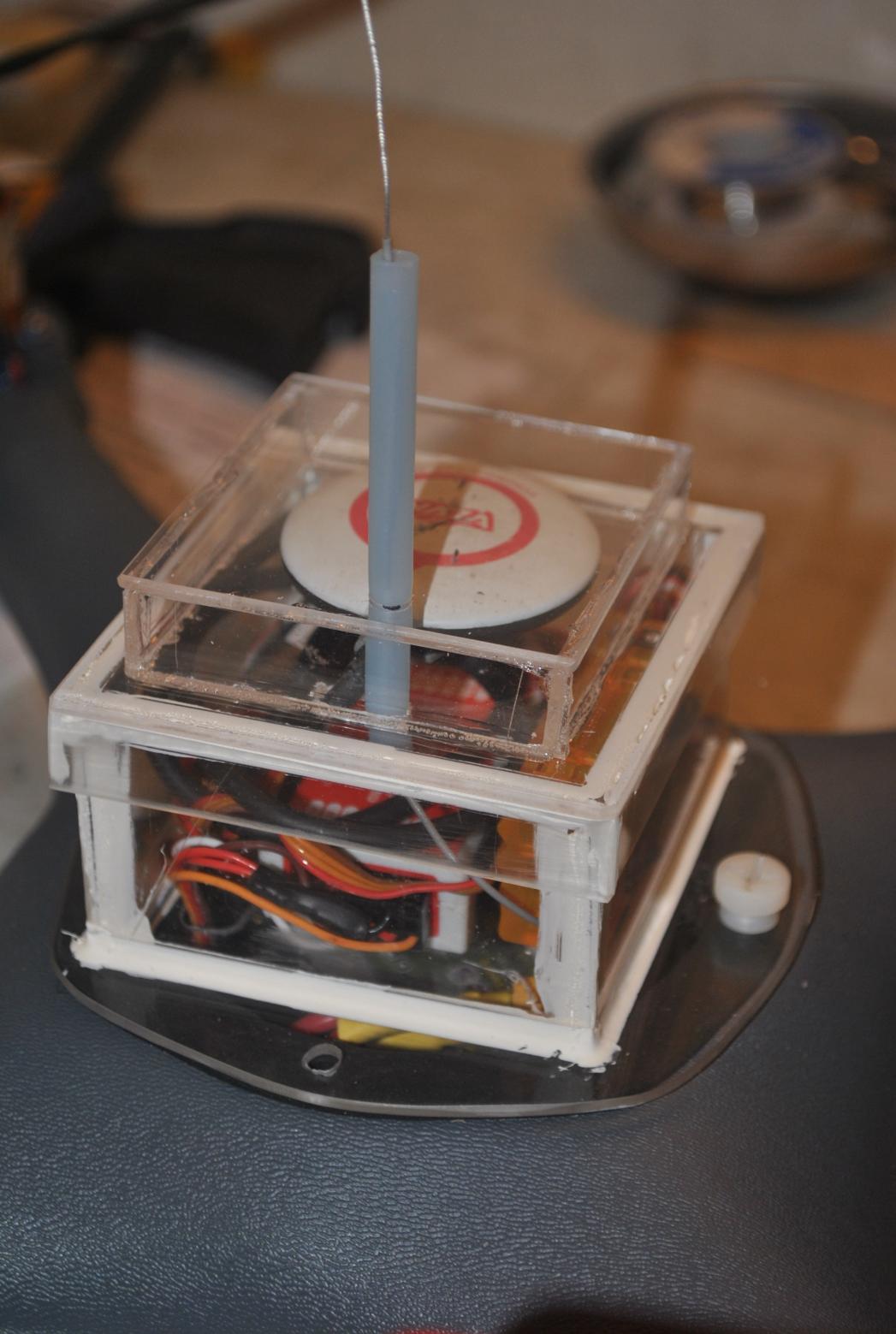

Naza Lite installed in a "water resistant" (not water tight or water proof) box on top of the cover.
GPS Puck mounted on top of that.
7 Chan HK Orange (Spektrum) RX ( *** Optional)
Gore Tex vent installed for the Bario.
Flown with a 2600 3S battery
3 great test and tune flights but has never been in the water.
(Yes, there are 4 cover screws)
My intent was to fly over and video the RC Boat racers but no one was particularly interested so,,, no longer was I. :)
Their motto is, "If it don't float, it ain't s,,,,,,". Hey wait a minute. It does float!
I have a 60T connector inside the box to complete the battery circuit after the cover and "tower" are secured.
I just use 2 pieces of scotch tape to secure the GPS puck lid.
It reduces the time the battery is burning while buttoning up.
