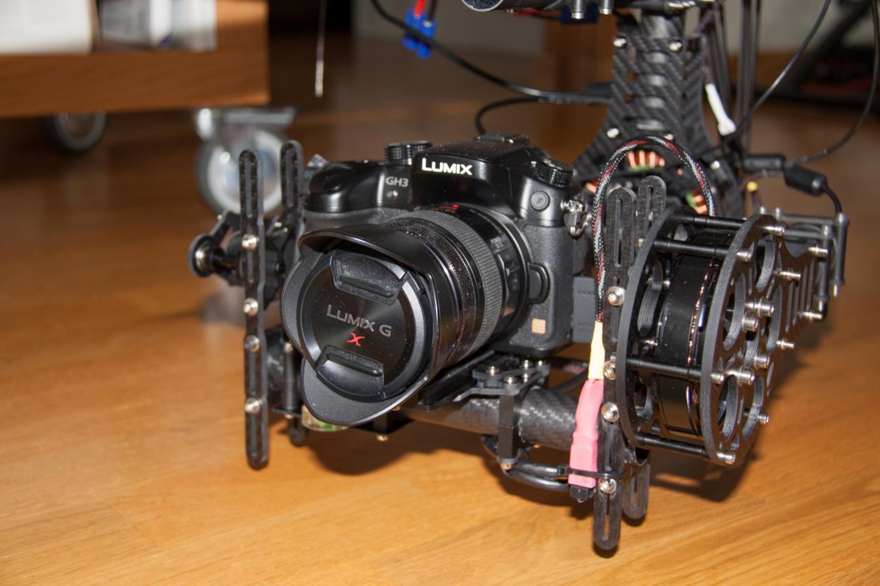

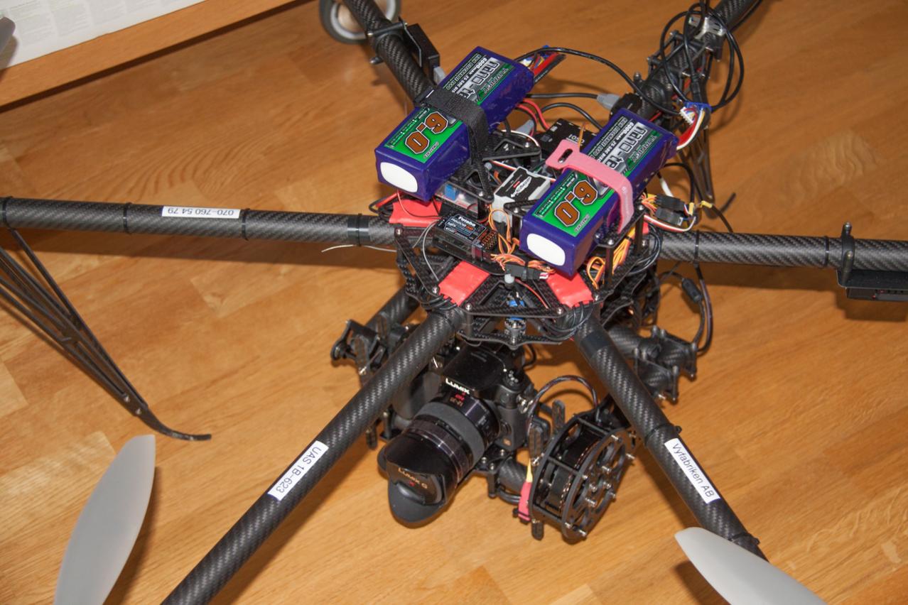

I've just converted a 2-axis Cinestar gimbal to BL with components from brushlessgimbals.com. It seems to work all pretty well but one function seems to be "broken".
The RC INPUT for roll axis does not work for me. It is kind of dead. The RC INPUT for pitch works just fine and also the FC INPUTS. If I swap the two in the configuration I can adjust my roll axis but not the tilt, so the problems seems to be the electrical input for RC INPUT roll. I have tested the failing channel with a servo connected, and it operates as expected and I have also measured the cables carefully. Could it possibly be a software bug?
I also have a spec question regarding the ArmBGC V3.0:
What is the max frequency on the FC INPUTS? I’ve googled a lot to find out, but without success. On my WKM I can select 50, 100, 200 or 400 Hz. Currently I have it set to 200 Hz, but that was just a wild guess.
View attachment 16082View attachment 16083
