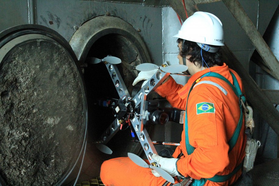

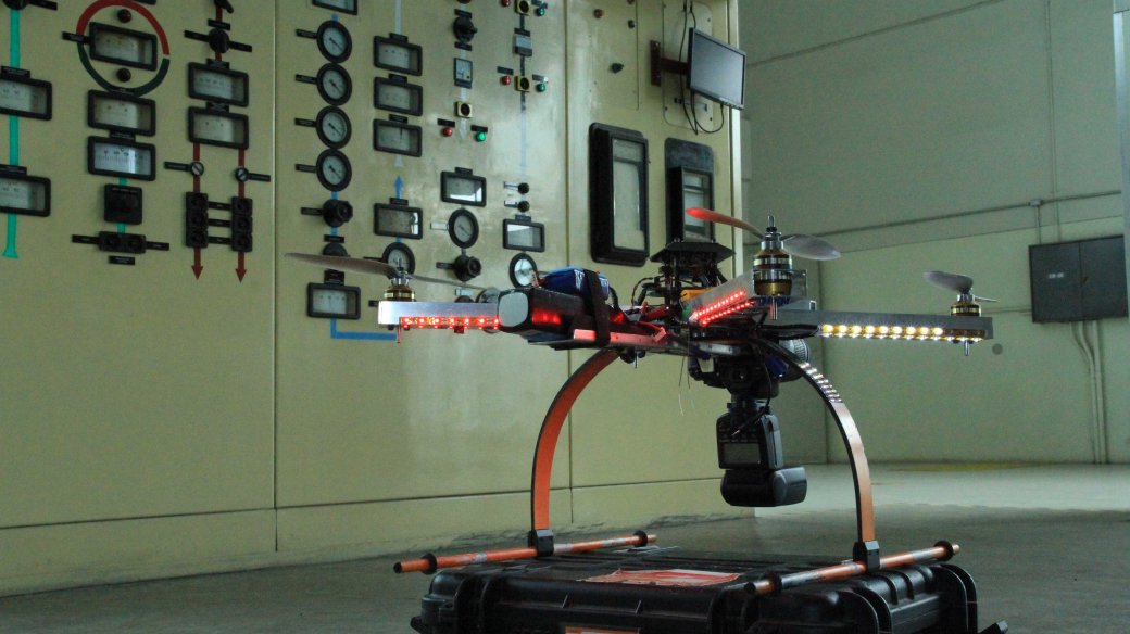

I bench tested these motors with 30A Escs and got 1,5kg with 50% thrust on each. Here are some photos as you asked.
View attachment 23582 View attachment 23583 View attachment 23584 View attachment 23585

Hi Carcara,
Woe, what are you doing with the drone??It s the first time a see the flash on a drone ahah! Is that an industrial oven/mine??

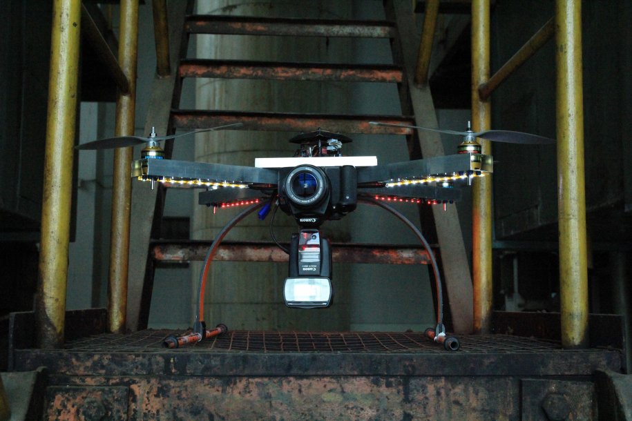

Carcara
Smartaerials,
do you happen to know how the temperature on the ESC is measured, I mean whe the sensor is placed?
This setup was used to inspect a boiler, totally dark inside. Got great results with the flash, but we are working on other solutions as well.
It cannot be bigger or wont fit inside, so I needcto work on other solutions, bigger ESCs are an option.
Regards.

Hi Carcara,
Regarding your log.. I know thats the theory , MK says:
  • By high-performance MOSFETs 35A and 40A peak period are possible. (with appropriate cooling)
And they must do the test in a super lab, with extraterrestial conditions..I´m sorry that I can t give you the cientific explanation but think that the max recomendet payload for a MK Quadro XL is 1kg, so maby 2.5 AUW , you are using bigger motors and drawing much more power through the Bl to keep that 4.2AUW in the air, so it doesn t come as a surprise to se those temps.
I wouldn t keep flying with this setup, you have no chance if one Bl goes,it will start spinning and it will make a mess.
Bl V3, or Abusse mark PWM converter and use standart ESC I would say. The other option would be to set the Bl right under the prop wash, I had it like that on a Hex and it cooled it down 30C, but 112C is very very hot.
Regards
Smartaerials,
do you happen to know how the temperature on the ESC is measured, I mean where the sensor is placed?
It cannot be bigger or wont fit inside, so I need to work on other solutions, bigger ESCs are an option.
Regards.
