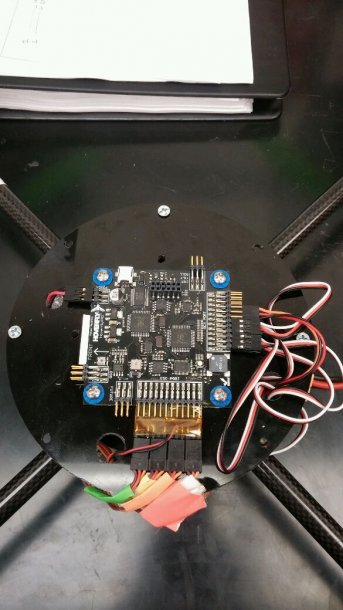

We have a hoverfly Pro only
Whenever I plug in the Hoverfly pro to the computer, the setup utilities reads all the PWM of the quad copter just fine. Whenever I move the throttle, it response appropriately on the received channel but not in flight. The artificial horizon is sometimes off (would that be that the frame is not 100% balanced?). Whenever I move the quad copter, the hoverfly responses to the changes in altitude and all the sensors are diagnosed as working correctly. I have the Hoverfly set on X mode with the latest firmware as well.
