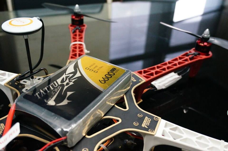

I use TATTU 6600mAh, 4S2P, not bad. With a Gopro can fly 15mins.
